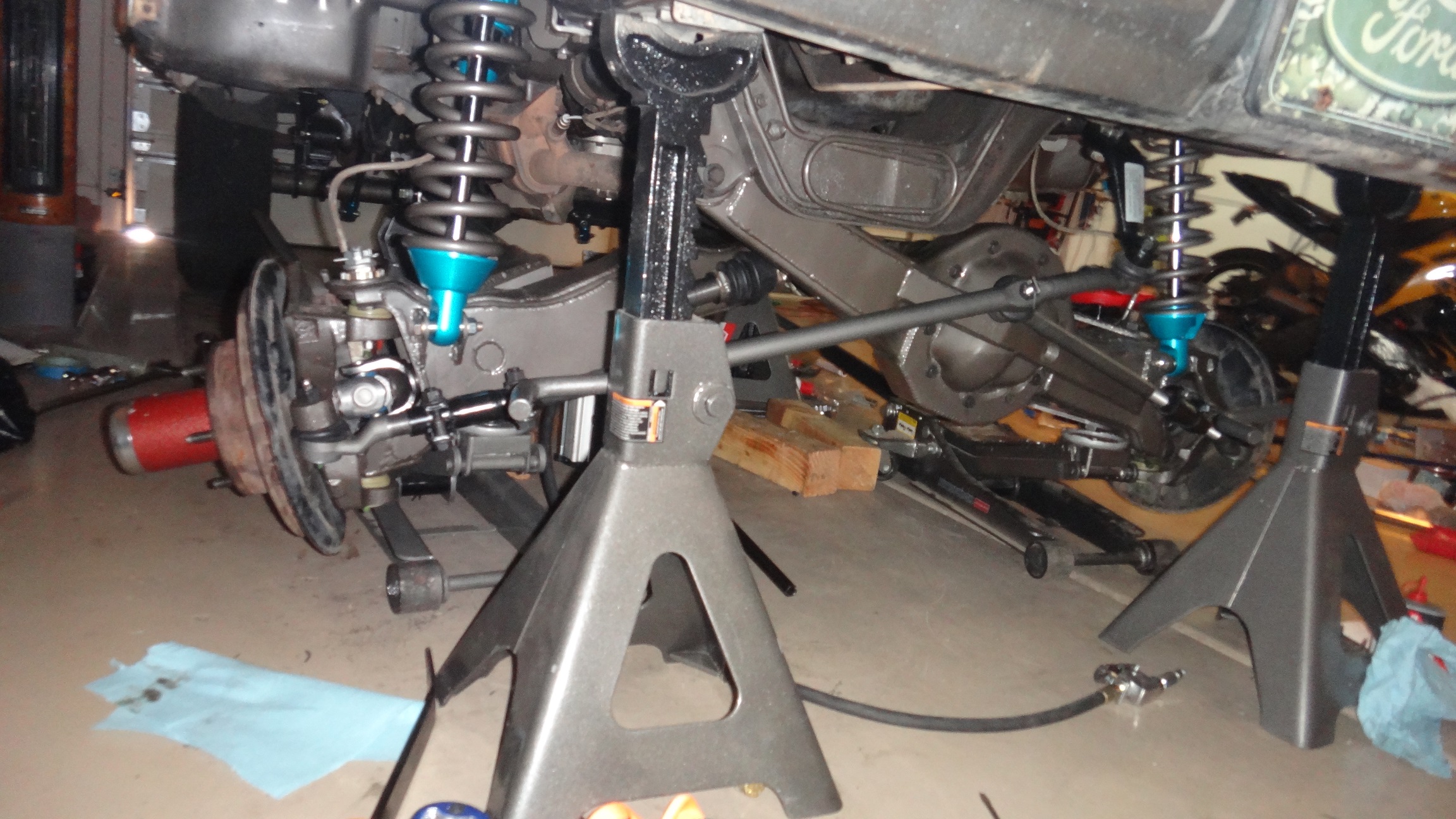

Mmmmm travel! And there's some wheels! But damn that camber is F'd! I still trailed it

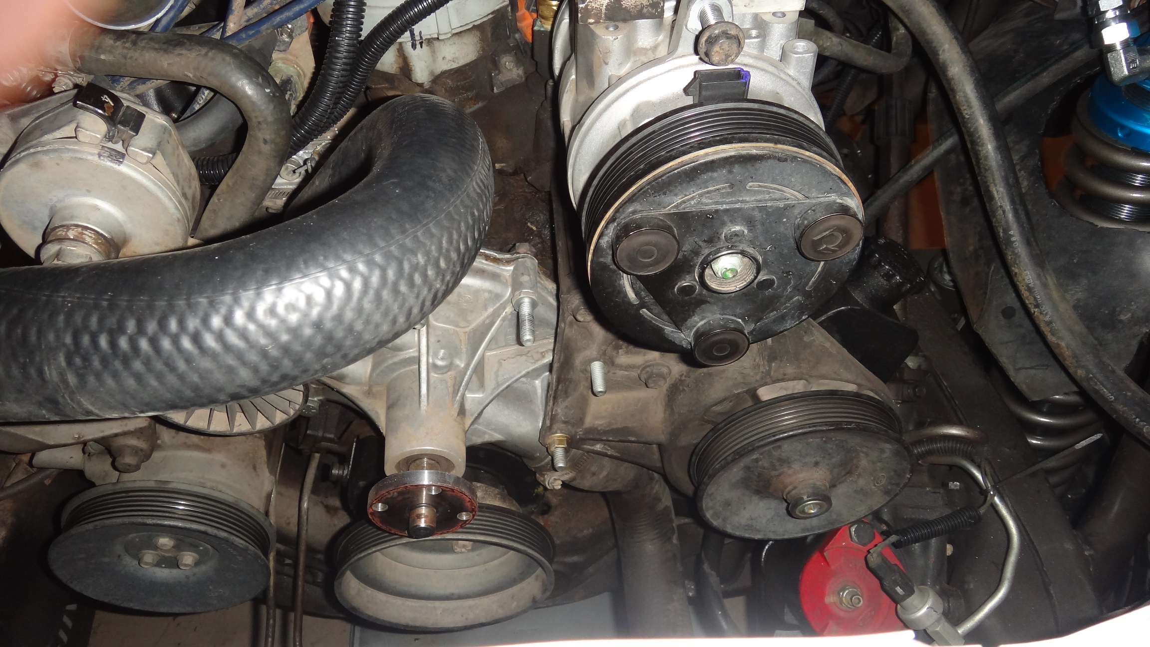

MF'ER!!!!! Yeah I say that a lot.... The engine block is cancerous and I had to fix a few of the water pump bolt holes....

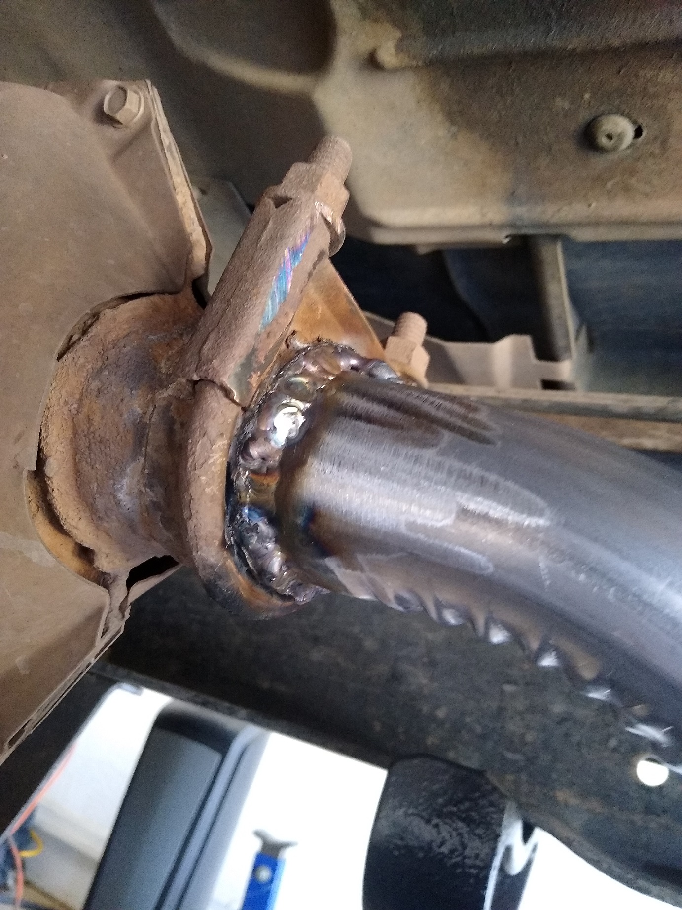

Remember I had to cut the exhaust? Well a downpipe was recommended and not a bad idea. Well I had to TIG weld this in while I was in the most uncomfortable position possible. I did NOT do a good job but it was exhaust so I started with the idea it won't look good BUT if it's sealed/welded with no leaks then I guess it's good enough. And it is! It's pretty quiet but a bit more throaty then the factory. I like quiet and deep
The alignment has been F'd but I finally fixed it. Solo sent me the wrong springs for the coilovers. It was 550 over 450 where I needed and they usually do 450 over 350. Once I got the right springs, I was able to get the camber in correct with about .75 positive camber using the MOOG adjustables.

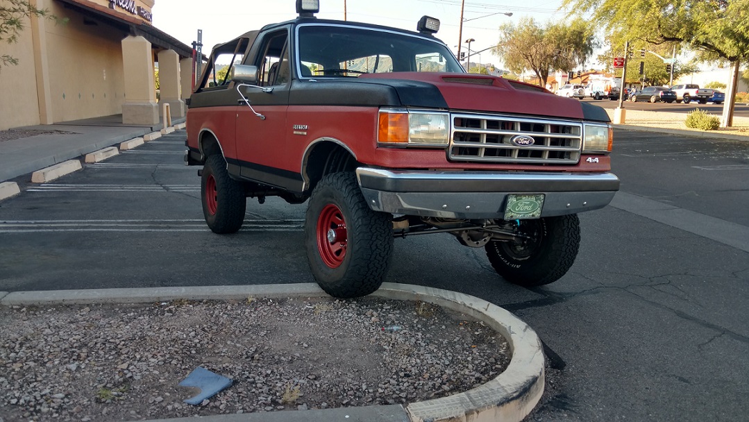

I'm still touchin up the alignment so we'll see how good it gets but since all this I've done a few trails and overall I'm satisfied
Took a good trail run at Sycamore Creek doing 25-45MPH average but being safe enough for the blind turns and oncoming traffic. VERY Happy with my final results despite some more tuning but that was expected since it's a highly tunable setup and I only just finished the "basics of the install".....

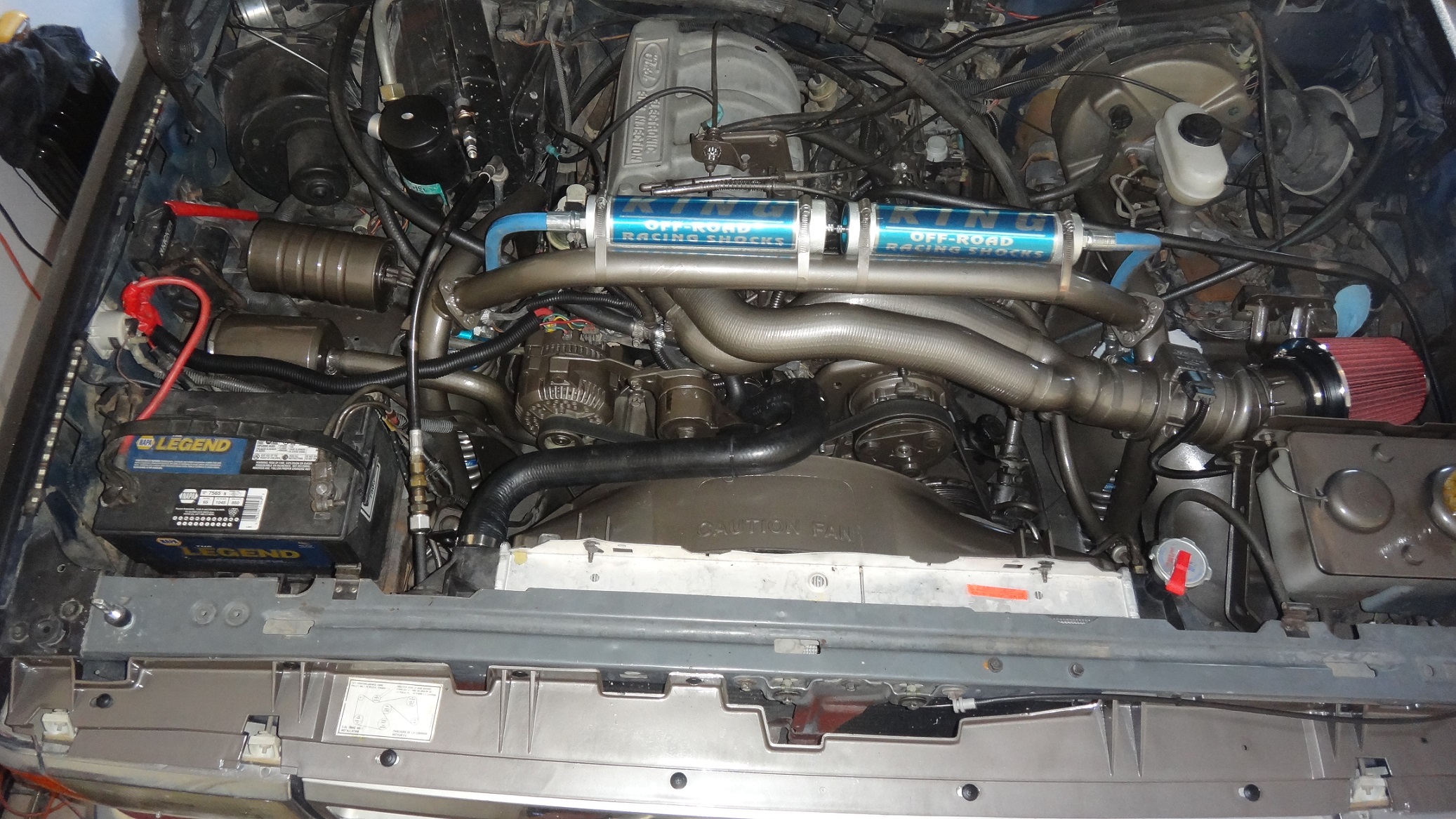

Either way here's where I left off just before I had a transmission leak that turned into now a 3 week project................................. Should have the pan on tomorrow I hope
P.S. F' those thumb screw hose clamps. I have a coolant leak from those I get to fix every few hours of run time too..... Those are goin to the recycling bin for sure!
