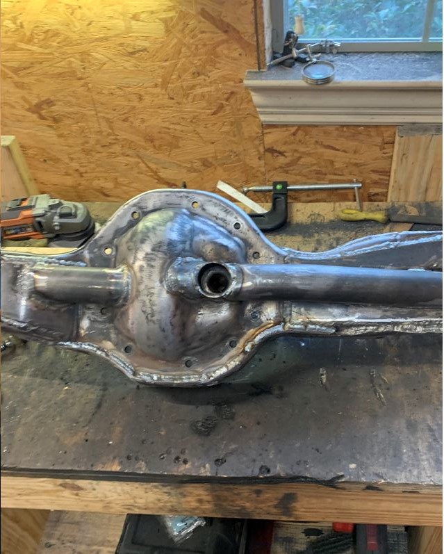

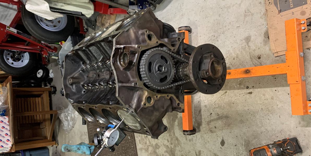

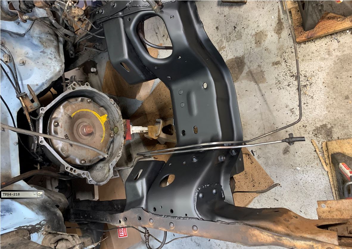

I guess its time to start posting pictures of my 1985 Bronco XLT auto 5.8 build. Bought this last year and had to rebuild the engine becasue of cam bearing failure. The plan is to offsett the awful truck culture of Texas with something cool and functional. Just started building the eams this past weekend and got the new cam broken in. The plan is to finish the beams and mount with threat radius arms and run a 2.5 CO and 2.5 smoothy. Mount glass and then drive it for the summer. I will start working on the cage next winter.

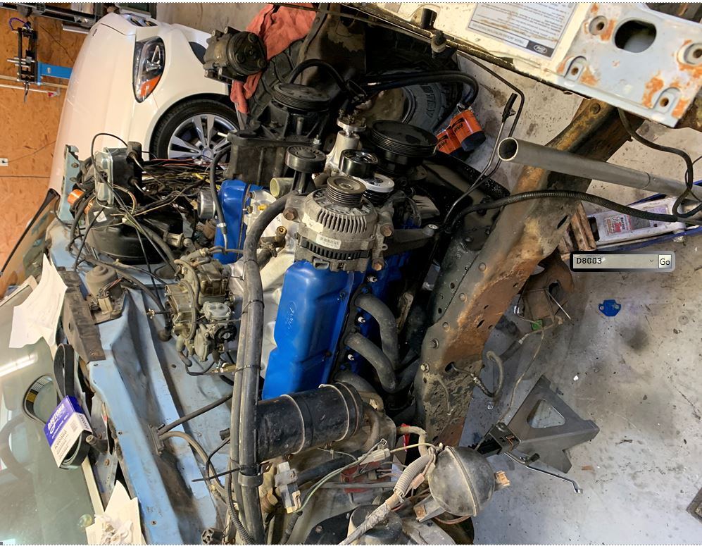

Weekend updates.

I want to widen a set of beams next time I have one apart. Seems straight forward enough.
Whats your plan for axles? And are you acounting for the lift with moving the balljoint or are you building it into the splice on the beams?

motorbreath53 wrote:Cool stuff!
It's a lot of work and patience.
I built 2 degrees of camber into my extension plates, less than most turns but my pivot points are sightly lower. I am going to extend and sleeve my stock ones until i am sure that everything is the way i want it, then ill get some made.

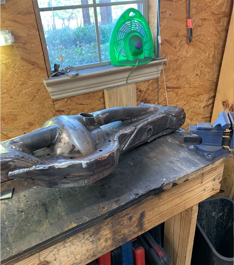

Driver's side beam is done, finally...

If you have not already bought the Threat stuff, you may want to look into Giant, Desolate, Solo, Oocho, Southwest etc. I have heard from a number of people that the fit/finish and fitment on the Threat stuff leaves something to be desired.
entity-unknown
Posts: 61
Joined: Wed May 22, 2019 3:40 pm
Bronco Info: 87 Bronco 302 HO w/ MAF/AOD owned since 2001.
Re: The BroncO 'Bama Build
Post by entity-unknown »
While the others vendors may be prettier, it's cuz they have jigs and do it all day with a dedicated crew. You may not have the best welds but they're good enough for what you want. If you're gonna do cut&turn, you might want to practice a bit more for those life critical welds pie cut welds but your quality looks good enough as is. You saved yourself about a few thousand and no shipping BS -materials :)
Smooth Operator and good luck!
I believe Yikes said it best to me one time. I've had the prettiest welds break and the ugliest hold. It's all about penetration.

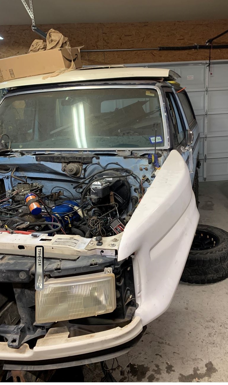

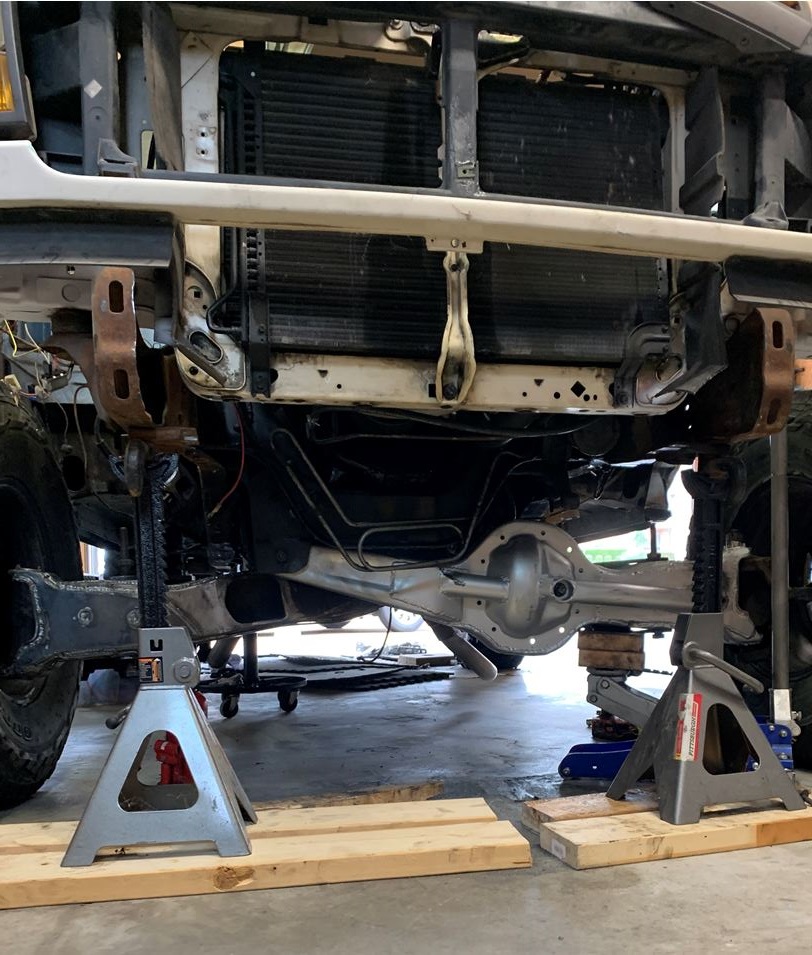

Got the beams mocked up and working on radius arm mount locations. I had to cut off the old side pipe mufflers, won't miss those.

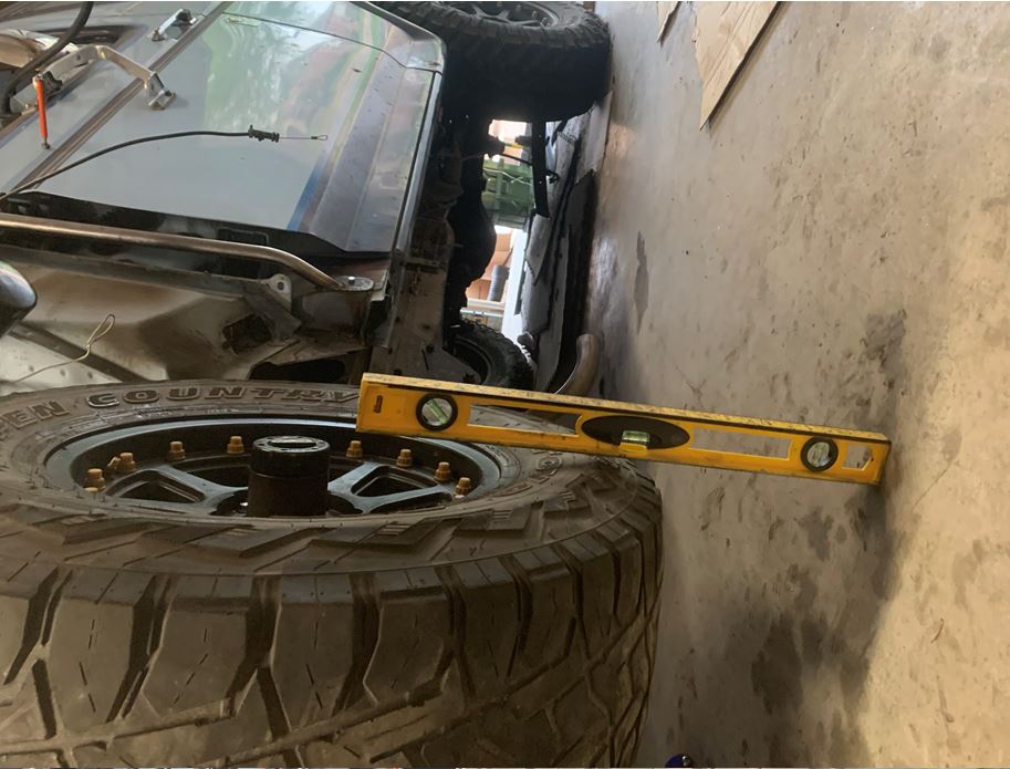

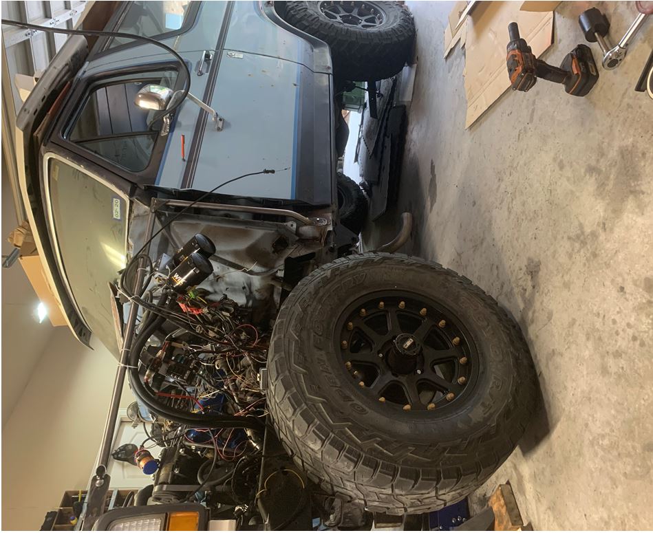

Got the beams on and did some cycling. pretty happy with the bump travel so far.

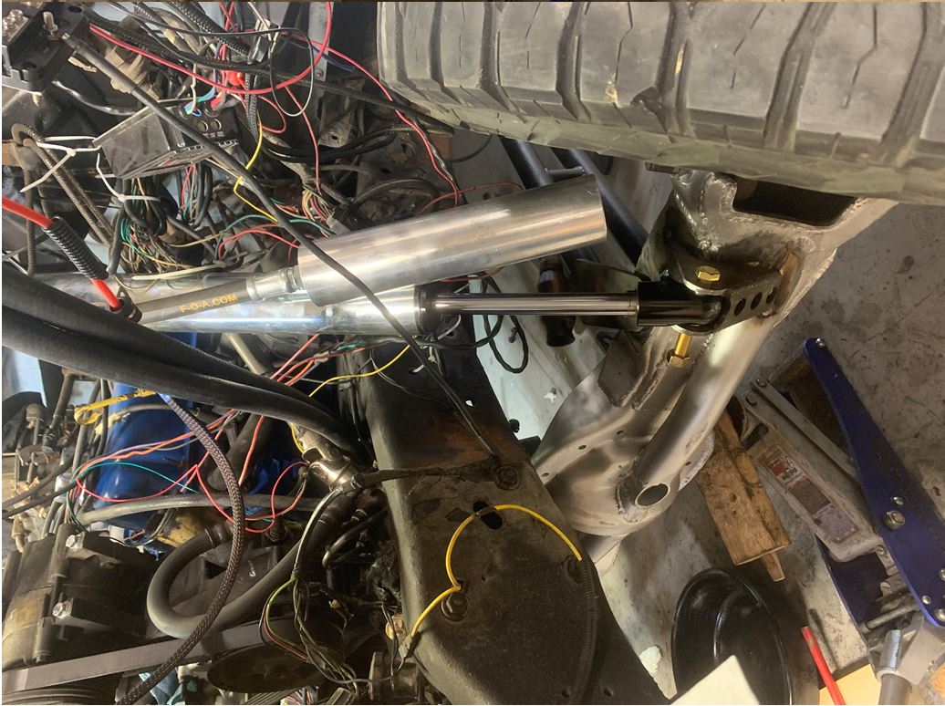

Post by ThrustMaster »

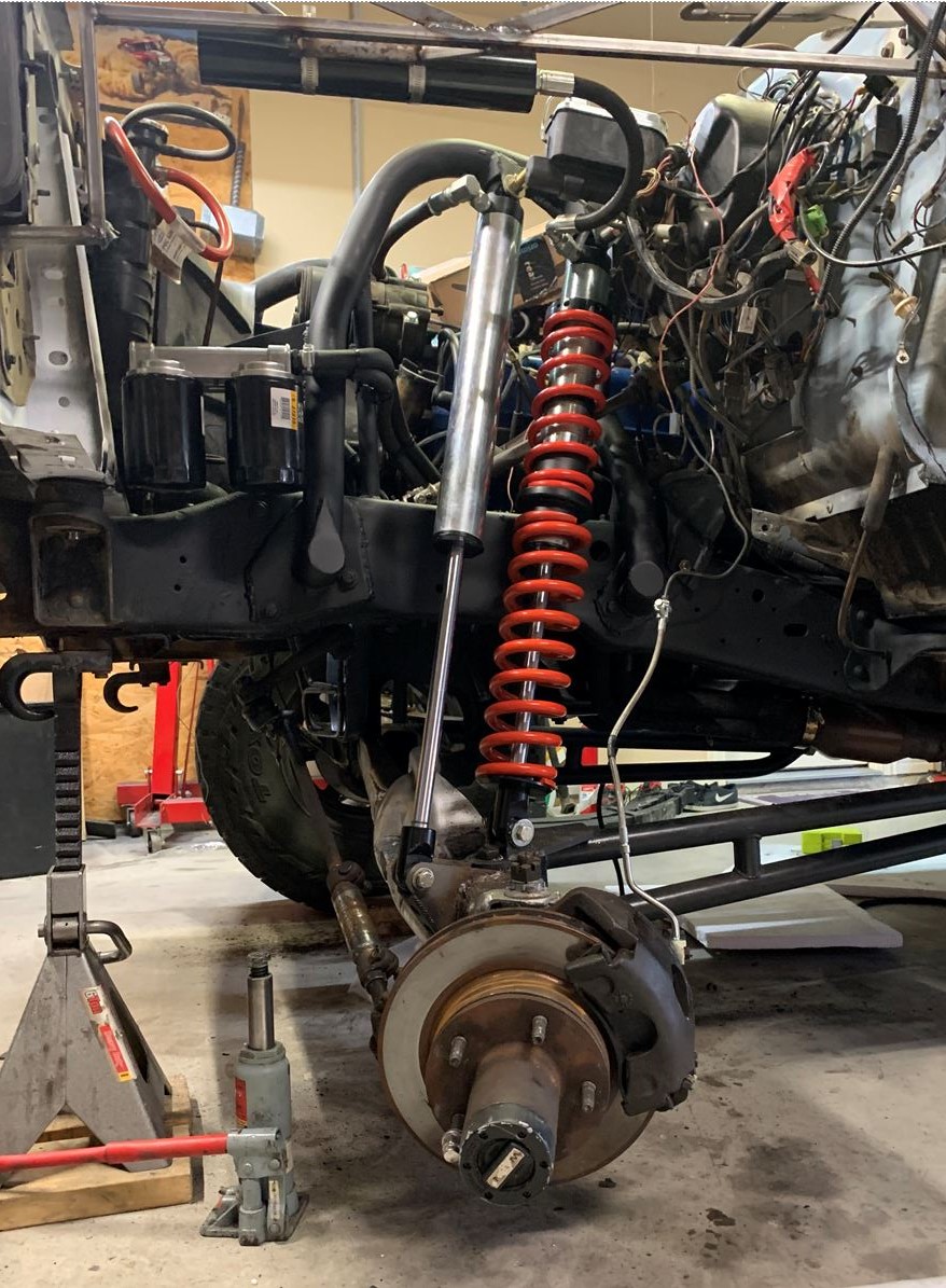

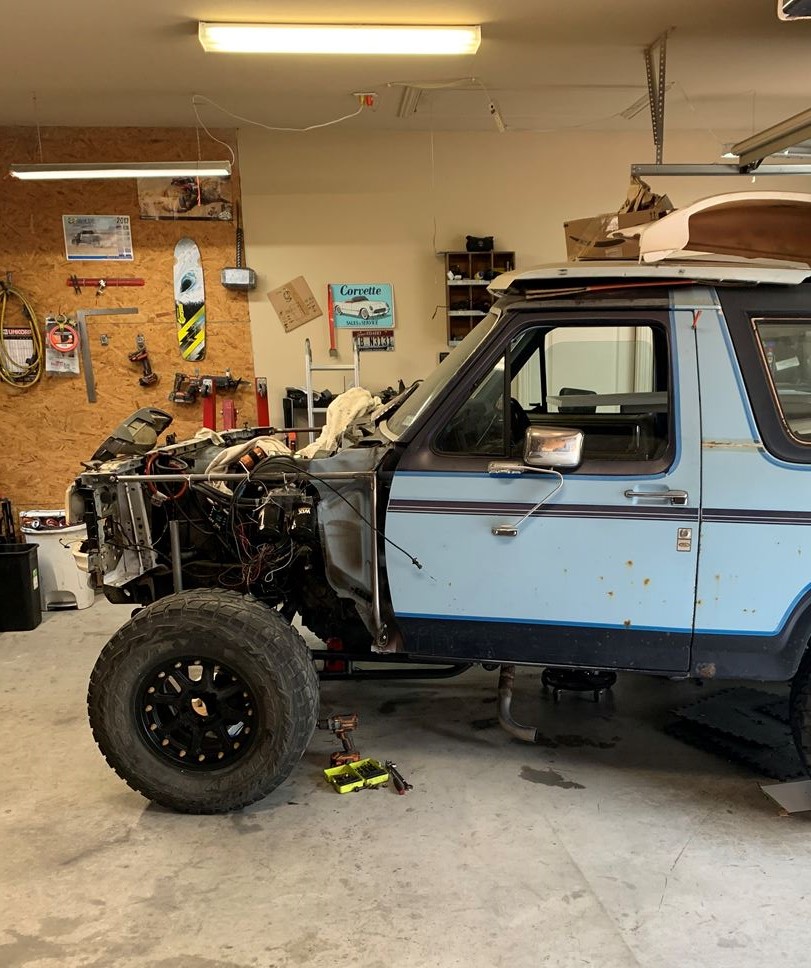

Had to rear work the shock mount a bit, but am happy with it now. The damn master cylinder is right where i want to put my upper mounts.
I know the feeling. I am working out the same issue myself. I'm thinking a bend near the master cylinder to clear it. It's either that or go hydroboost.

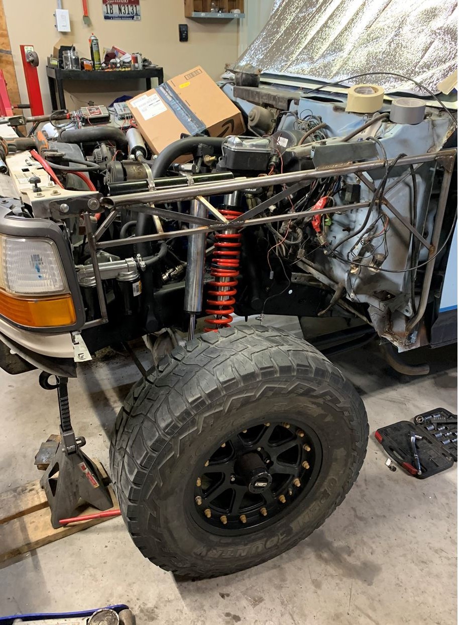

made more progress, finished up the drivers side. on to the passengers side.
