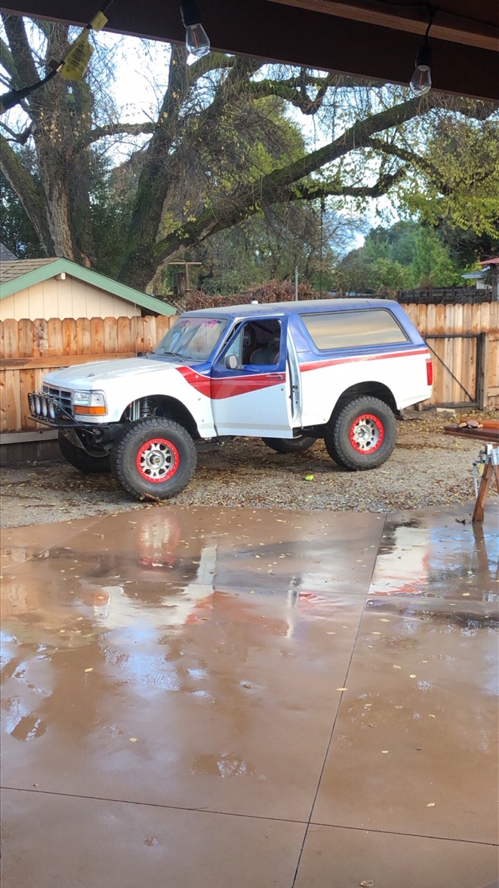

Well the thrashing to New Years trip in JV was successful. It came down to the wire with the trans pushing out the pump seal days before the trip. Luckily I had a stock trans sitting at home and swapped it in. Not great, but it worked.
Photo dump:

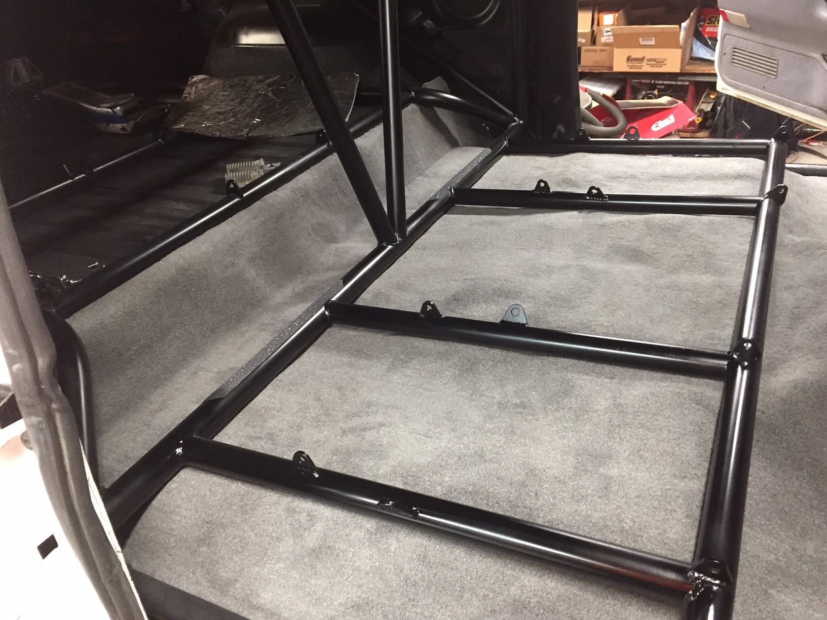

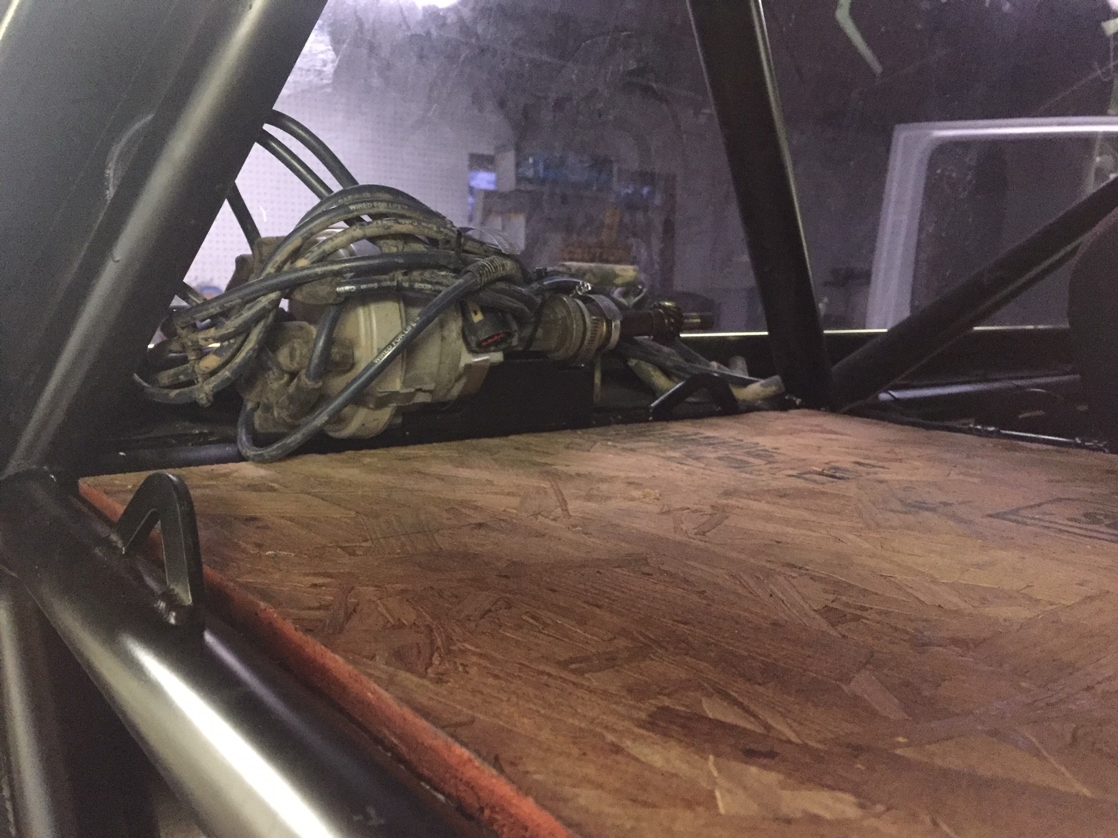

Carpet in
Drove it out of the shop for the first time in close to a year
Got the shocks charged. Had to get some sick boi droop pics

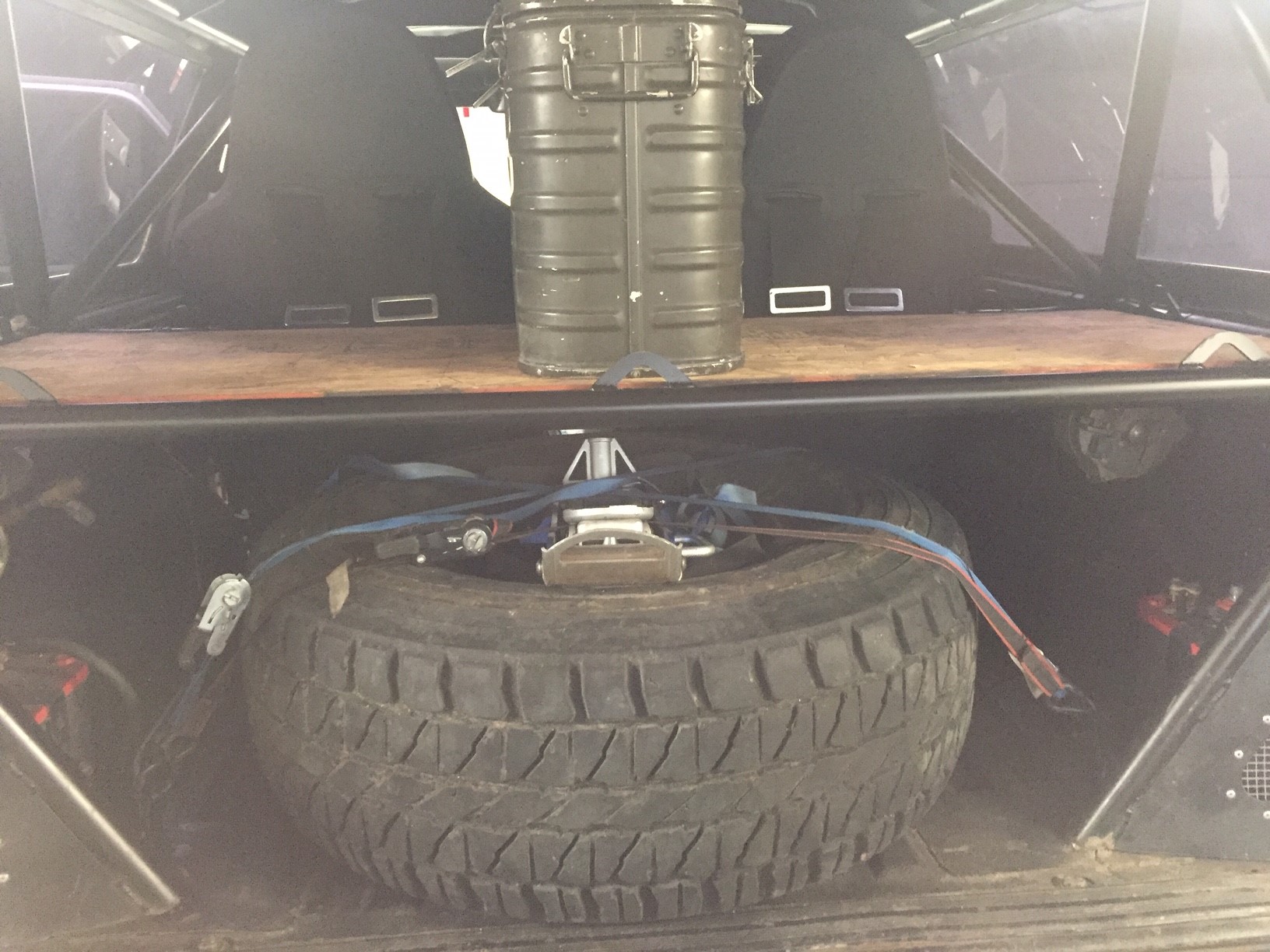

Hard mounted some important spare parts

More spare parts and storage area

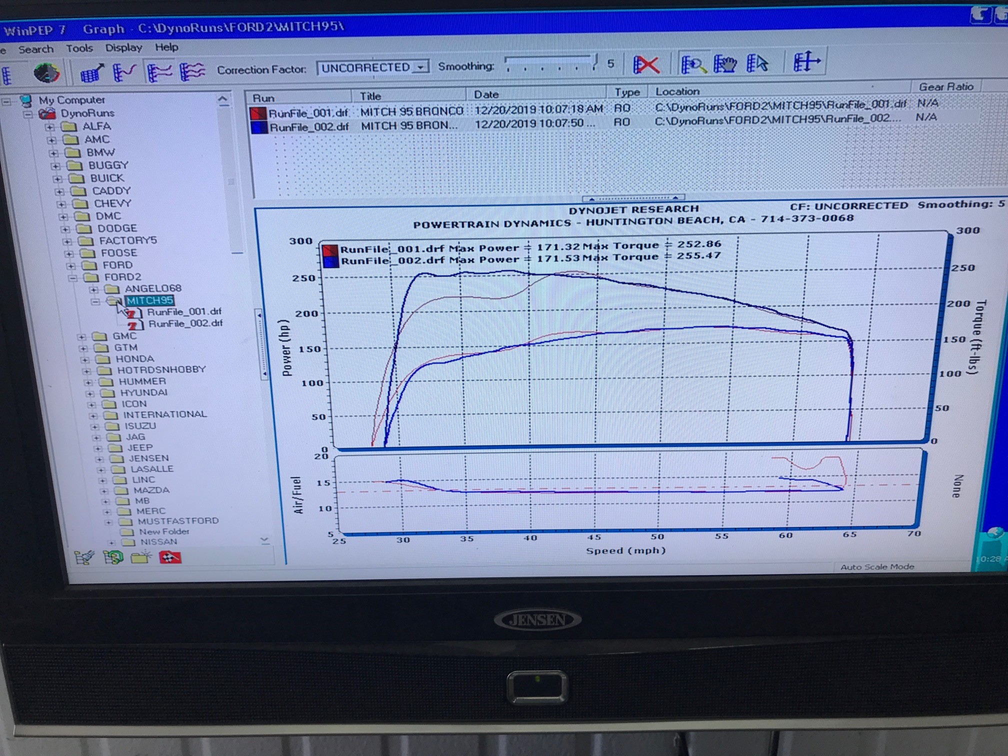

Dyno run. I thought it would make more hp but the butt dyno feels good so whatever. It was also in 4hi on the dyno so there may have been a few more ponies in there. This is also where the trans gave up the ghost. I'm thinking it being in 4hi and the 4500-5000rpm pulls didn't help the trans issue.

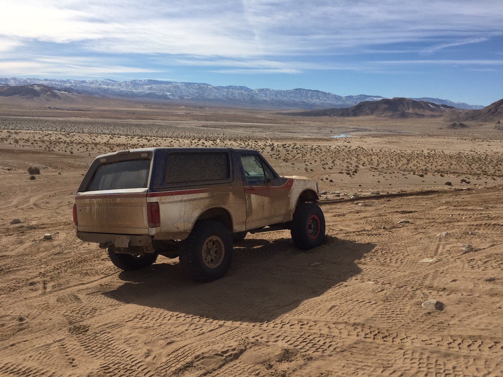

Finally the trip. No major issues to speak of. The 58 was shut down so it took forever to get there. 3.5 hrs on the side of the hwy waiting for it to open up.
I turned some tubes on the rear shocks, it still doesn't ride great back there but I think I'm getting that sorted out.
I did have a bit of a fluid slosh issue. Trans (got that figured out, broken dip stick tube), coolant and power steering fluid. I need to figure out a baffle or something in those reservoirs.

All in all it was a great trip. A little muddy but no dust.
Ryan at Accutune met me out there towards the end of my trip and we did some shock work. We made some strides in the right direction but they need just a little more tweaking. Ryan know's his shit, I would definitely recommend him and the gang at Accutune if you need some shock tuning or are looking for an out of the box tune with a new set up.
