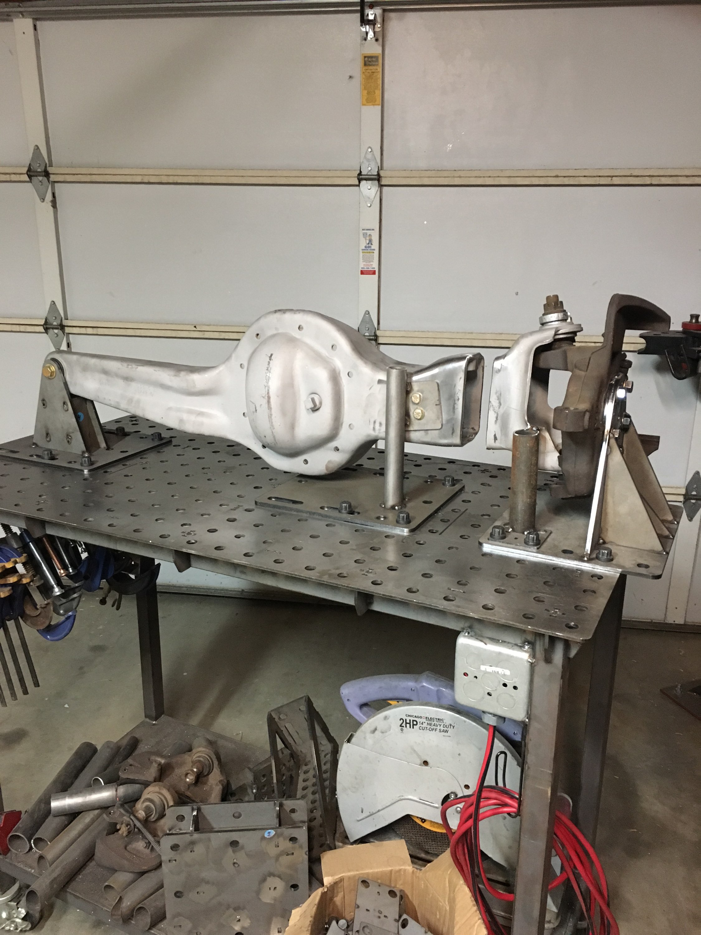

nope. i picked a truss from a barnes 4wd and had some fixturing cut from my homies at lasernut to attempt to straighten, truss integrated into the diff cover and weld the tubes to the center but work got busy and i havent touched it. i am concerned there is not enough room over the diff at bump for the truss, but we shall see.

- got the rear axle trussed, tubes welded to the center, had it check over by my gear guy. all new bearings and seals since axle shaft had some fretting from the housing being bent and sent metal everywhere. drive side shaft too some serious swinging hand press action to get out.
