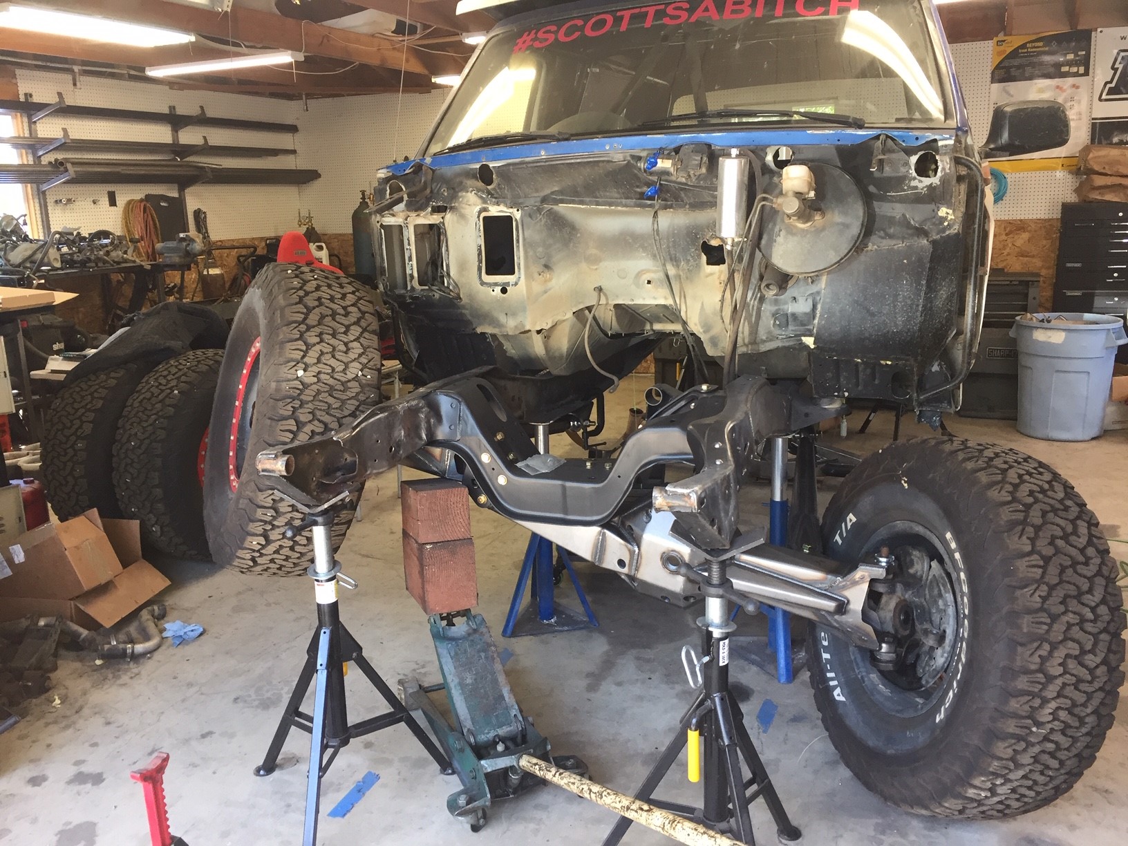

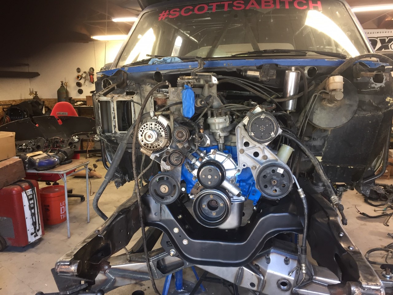

Thennnnnn... smashed the front end. Nearly lawn darted the thing off a huge roller at about 80mph. Pics don't do it justice. The front suspension pushed back and wiped out all the front suspension/steering. Broke all sorts of things. Got a tow back from some great friends.
Anywho, the rebuild has commenced. I had intended to make a bunch of changes to this thing, just wasn't planning on doing them so soon and all at the same time but now is the time I suppose. Kind of a blessing in disguise I guess. I had to replace the engine cross member and do minor frame tweaking. I got a hold of the factory ford frame dimensions with datum points and she's straighter than when it rolled off the assembly line. The plan is to have this thing back together for a New Years trip in December. There's a lot of upgrades planned for this thing. Stay tuned.
Hoover craft mode
Pulled the motor. It broke the motor mount boss on the block on the driver side.
Freshened up a roller with some goodies.
Started getting the bling unboxed, installed and cycling. #SAB

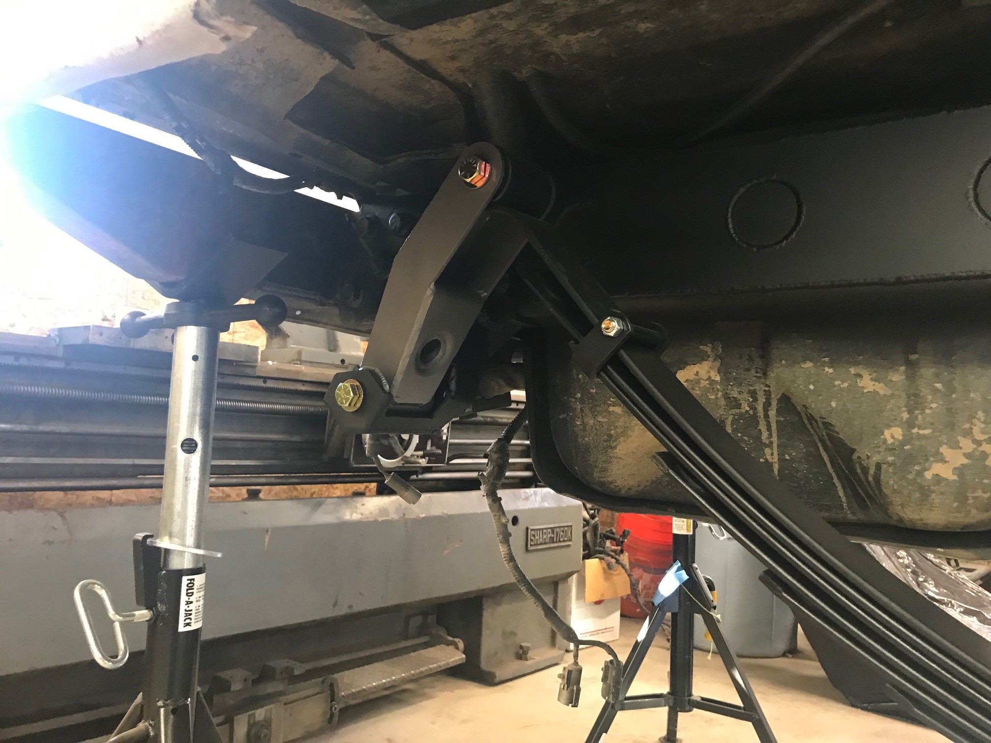

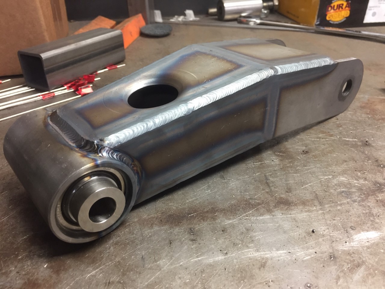

Got the shackles finished up. Going to try the uniball method and see how it pans out. Had to notch the hanger a little bit for the droop.
Rear end mocked.
Ultras on to clear the big brakes.

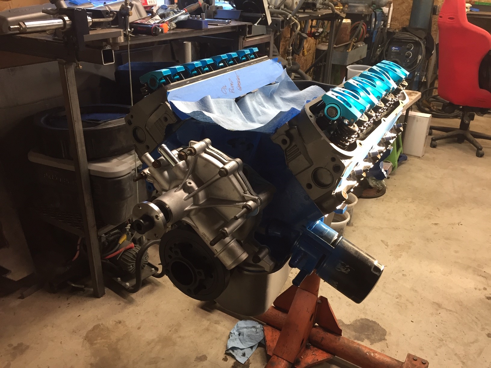

And motor in the hole

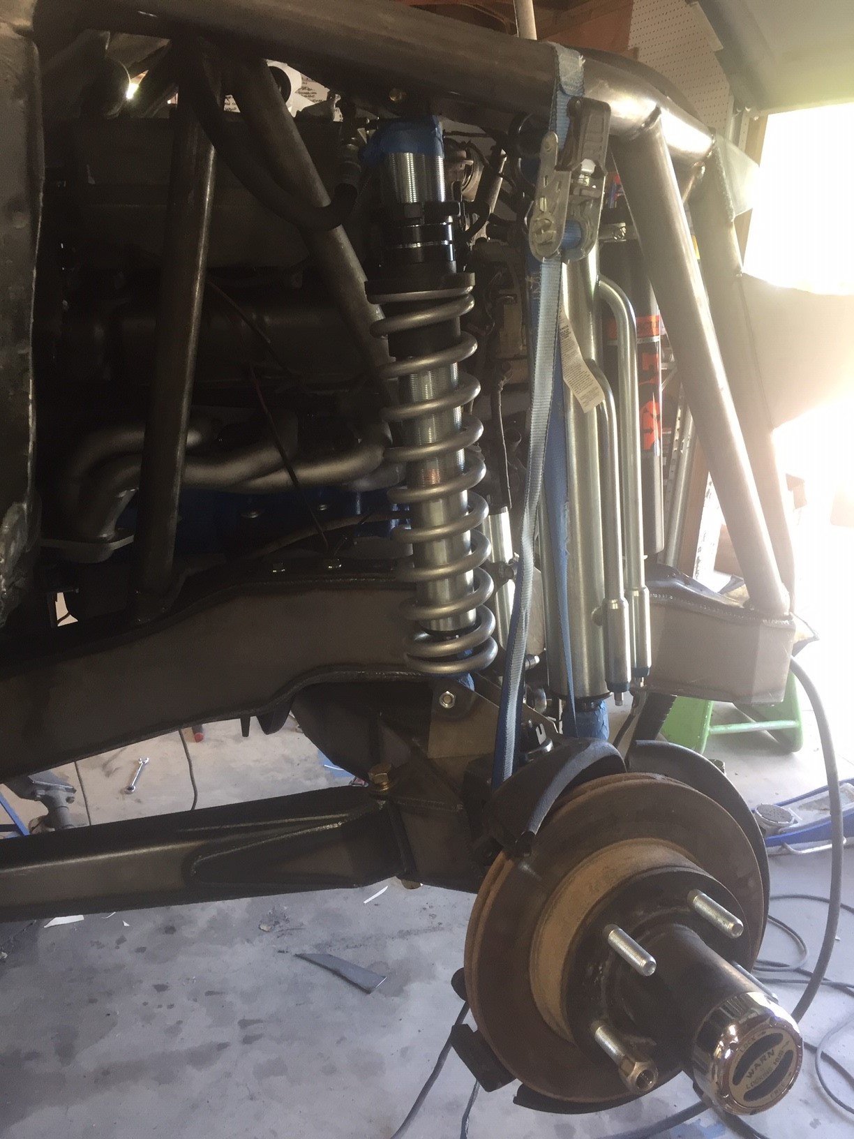

Got the engine cage mostly tacked up. Finalizing the shock mounts then on to the steering.

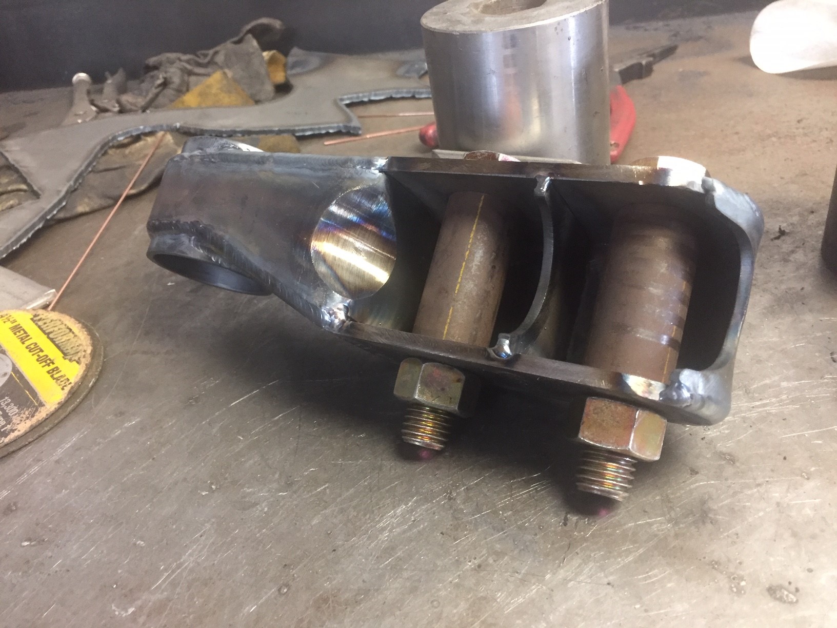

Built a mastercylinder cantilever thingy to make room for the shocks:
