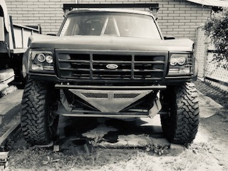

up next! clean and use it!
if I have time before that
new tranny pan
new headlights
Baja Design lights
new tranny pan
new headlights
Baja Design lights
- IMG_7469 (1).jpg (40.69 KiB) Viewed 5721 times

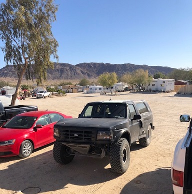

round 2.... last saturday
...I lost my starter, and I am very lucky I am liked by a few people....hah ....... I was found by multiple great people for help. Yes, Aaron I should have just sent you to the auto parts store as soon as you found me.
Drove bronco to the dirt then home the next day. stayed at Iroonwood hotel one night and it is fantastic.
I need to bring rear of the Bronco up 5 inches and it is to soft so spring will change. I have a new love for one off front ends. I will explain soon.
