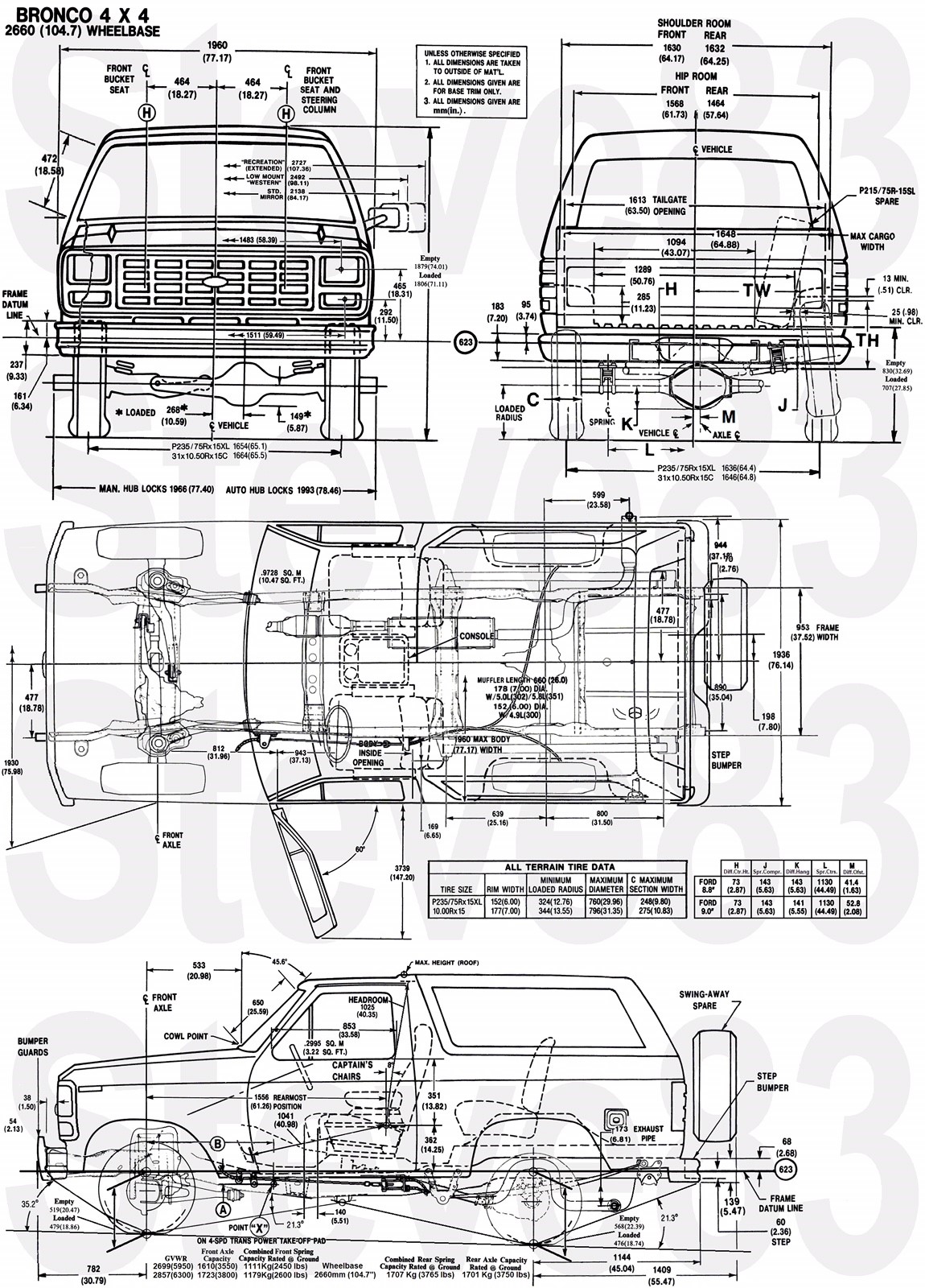

While I'm at it; I'm sure this is relatively common among Ford trucks of the 90's, but my truck appears to have an issue. The passenger side tire mounting surface is about 1.5-2" further outboard than the driver's side. It had the issue prior to putting the new beams on but it's much more obvious/apparent now.
Is this just a matter of the whole body shifting to one side via worn out body mounts? By obvious process of elimination I have identified worn bushings/bad alignment is not the cause. So either Ford effed up the mounting locations for the beams from the factory or the body shifted, right?? I haven't checked the frame for square yet, the truck hasn't been in any major accidents (that I know of), and it rolled super true when I used it as a DD. It all appeared to be normal while doing the front-end overhaul but I'm still not ruling the frame out until I put a tape on it. The odd thing is all the door gaps, fender gaps, hood gaps appear to be within spec... Typically you'd see them all out-of-whack if the frame were bent or if it had been in a major accident. Obviously I don't know what the cause is, but I will pull the whole body off the chassis to find the problem if I have to.
Just wondering if anyone else has had this issue and actually fixed it/found the root cause.

Is the tire sticking out more thing based on stock fenders, or the fiberglass fenders, or is it the same with both?
The photos don't make it look super different from side to side, but that is basing it off tire tread showing beyond the bumper and photo angle can play a big part here.

ChaseTruck754 wrote:Is the tire sticking out more thing based on stock fenders, or the fiberglass fenders, or is it the same with both?
Sorry the pics don't quite show both with the same fenders on but the problem is certainly with the truck, not the fenders. Whether the glass is on or not, it's clear the passenger side sticks out significantly more. I still haven't taken the time to take some frame measurements. Hopefully someone can give me some solid clues..

It could be the body shifting due to bad mounts.

hobbyturnedobsession wrote:It could be the body shifting due to bad mounts.
Definitely a possibility. I'm actually hoping this is the issue, although, I've been under the truck quite a bit and the body mounts pass a visual inspection.. The bolts all seem to be concentric with the bushings and mounting holes.
My plan from here is to take some frame measurements. That should reveal where the issues are. If it doesn't, the next step is to get the body off the frame and inspect even further.
If my memory of the body mounting design is remotely accurate, the body (even with NO body mount bushings) couldn't feasibly move as far as it has.. Which makes me think the frame is jacked somewhere.. Usually the body lines and door/hood/panel gaps are impossible to align if that's the case. Which my truck has great body gaps... It's one of the world's great mysteries

id check the beams and make sure both sides were extended the same amount.
is this measurement the same side to side, maybe your beams got mixed with someone elses?

mobil1syn wrote:id check the beams and make sure both sides were extended the same amount.
Good thought, but the problem existed long before the extended beams were put on. It only appears worse now because everything sticks out past the body.

well then, id get it to a frame shop and make sure things are where they are supposed to be.

Start measuring stuff. Check the difference from one side to the other. You should be able to
measure from the frame to the pinch weld on the body and see if the cab is shifted
Frame dimensions for reference:
CAB DIM.jpg (542.65 KiB) Viewed 3130 times
