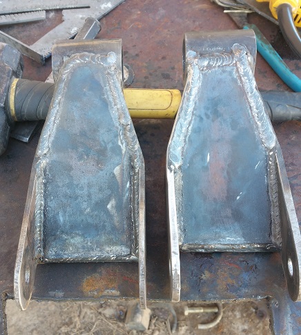

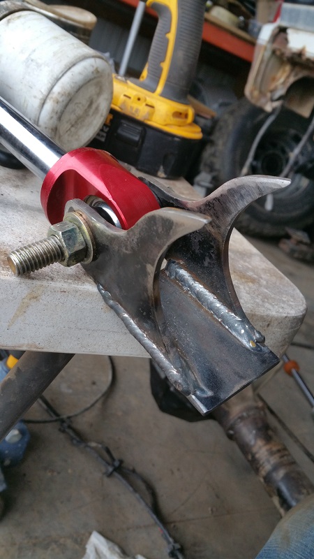

also worked on mounting the shocks. built some lower tabs, used ruffstuff upper tabs.
shocks are walker evans 14". had to change out the fitting on the reservoir hose from a straight fitting to a 90* fitting. I released the excess nitrogen pressure. which was different in each shock. Also there were different quantities of oil in them which I thought was weird. I'm going to see if I can get the specs from walker for oil quantity and depth of the reservoir piston before I add any nitrogen. I've never gone through a set of these before so this will be a learning experience for me.

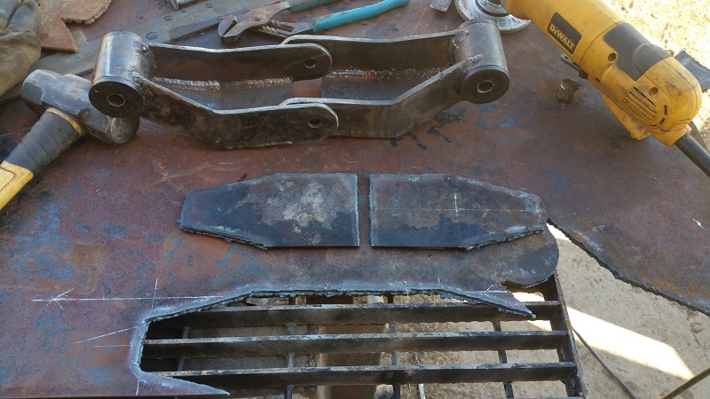

on to the pics. finished up the shackles with the inner plate.
then I worked on the lower shock mounts
with the lower shock tabs I ended up grinding a lot more clearance into them so that nothing rubbed at full droop or under articulation. Hopefully they hold up. If not, I'll learn from it and make better ones.
