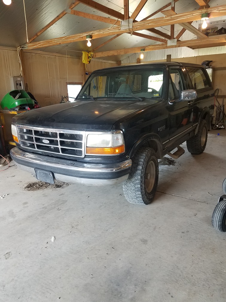

Finally got me a Bronco. Once I figure out how to post a pic I'll get it on here. I've got big plans for it but gotta go slow. Its a 94 XLT 5.0. My future plans are to go with a 6 inch lift. Do away with as much of the electronics as possible. Build the 5.0 to crank out around 450 to 500 HP with either FItech or holly sniper fuel injection put in a C6 tranny with a 205 married transfer. Eventually a nine inch rear. Stay with the IFS. The interior is pretty worn out so will be replacing a lot there. I'm for Missouri so a full on gofast bronco doesn't really work for me. I'm going to drive this thing everyday but when I take it offroad it will be able to handle its own.
I will greeatly appreciate any advise and help through this process.This is my first build and I am very amateur and will be learning my way through this whole process hoping I havent bit off more than I can chew. My 7 year old I think is more excited then I am about this project and will be by myside the whole way. My plans are to hand him the keys when he turns 16.

Finally got a pic to load. Here it is here shortly its getting torn down
