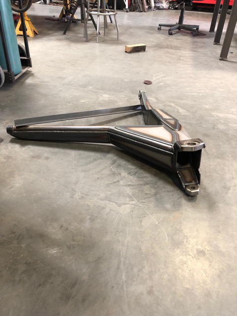

Here is the temporary fix we did in the desert on the radius arm and then the bigger fix once it was back home.
That's some proper carnage!

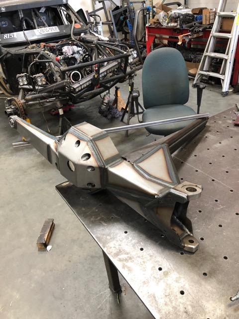

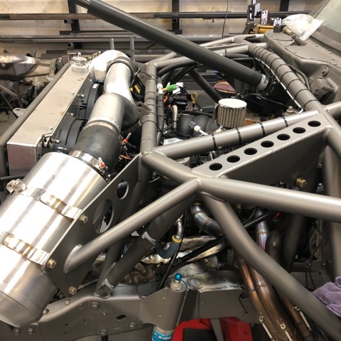

More updates on the new beams and front end. Running the 40s required new filter setup, which will require a full session on the dyno. Getting very close.

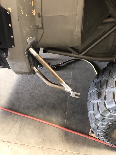

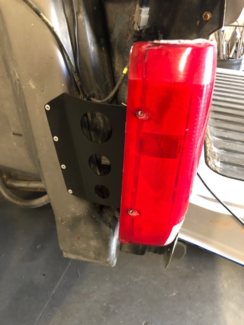

While the bronco was at Richer I had them throw on a new bedside mount setup so that I could keep the taillights in with bedsides off for easy cleaning and we will also use the front bedside mount for trans coolers. Exhaust will be re-routed to exit down below and likely thermal wrap of some kind to keep heat away from the coolers. Trying to plan ahead for once.

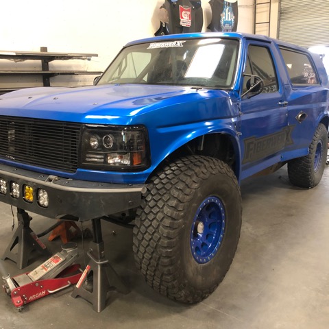

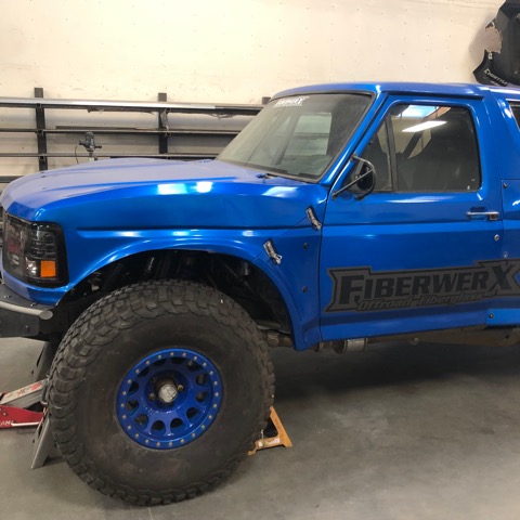

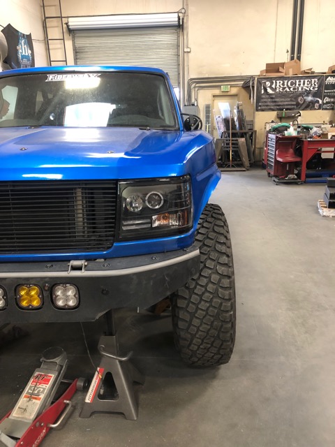

And the 40s are on with tough trim of the glass. This trim was just to remove what was needed to clear st full bump, we will go back through and make a cleaner radius for now and run it then see what happens with the new front clip either redo this one or do the gen2 raptor conversion.
Re: John's 91 GFB
Those beams!! Bronco is going to look right on 40's. Can't wait to see that thing pounding some whoops. I think Zoo Rd video is obligatory.

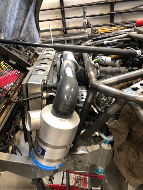

Posted the wrong picture last night. Meant to put this up. Filters with plenty of tire clearance now. Off to dyno tomorrow.

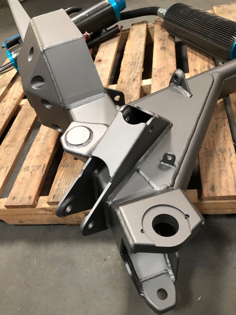

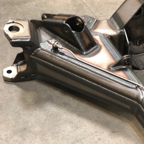

Cho’s fab work is done, 40s are on, getting steel-it on everything and then plumbing and final assembly. Should be ready to go back together after a change to one header tube that Vik is knocking out.
Finally made it to dyno and we are all set with the dual intake and no MAF sensor. Put down 393hp, still waiting to confirm tq once I see the final dyno sheet.
Beams looks awesome done.
