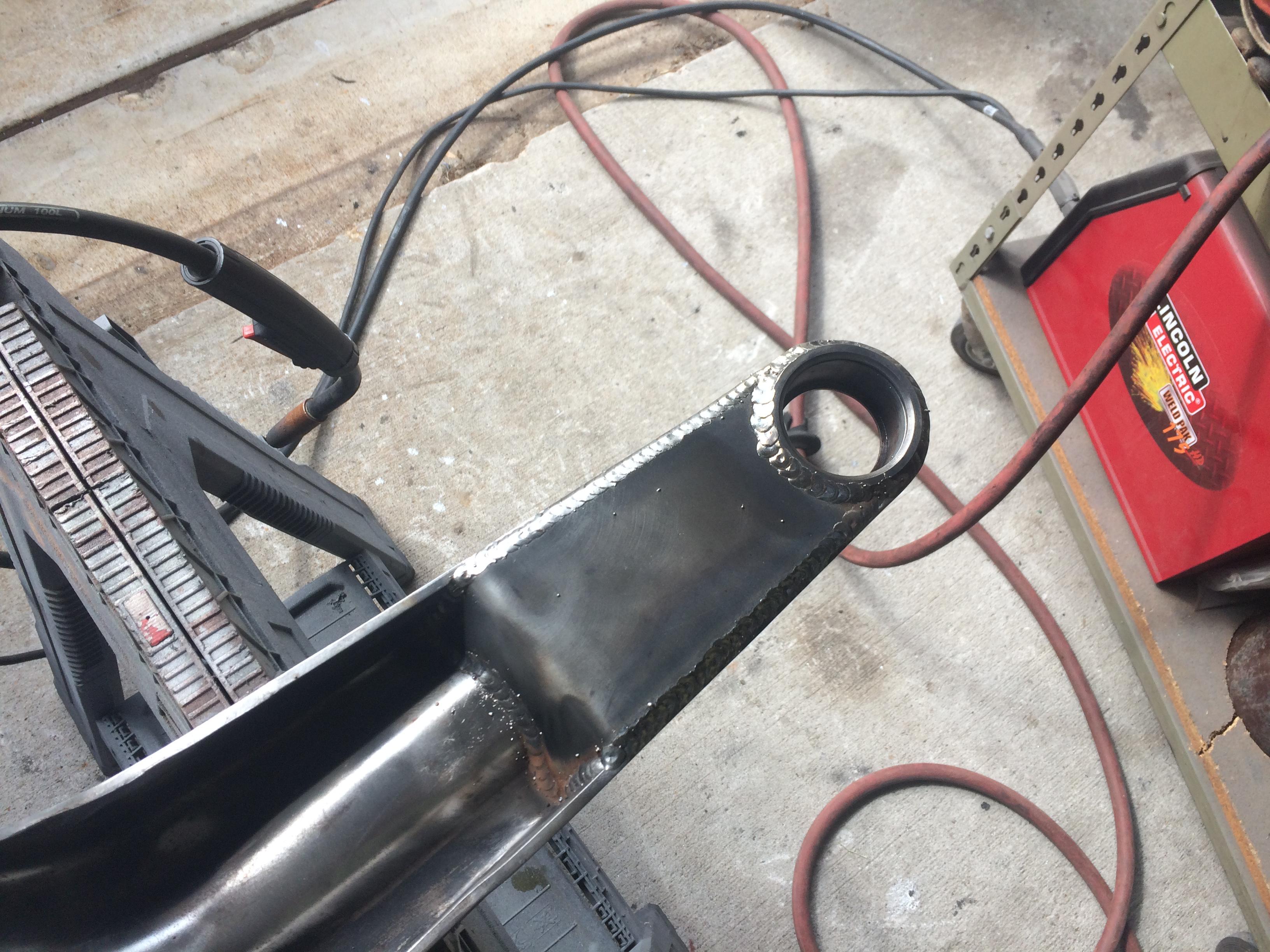

Been a little slow lately. But I got the beams and arms finished. Truetrac and new u-joints installed, slipyoke spring ordered (should have done more research, this issue was a surprise to me).

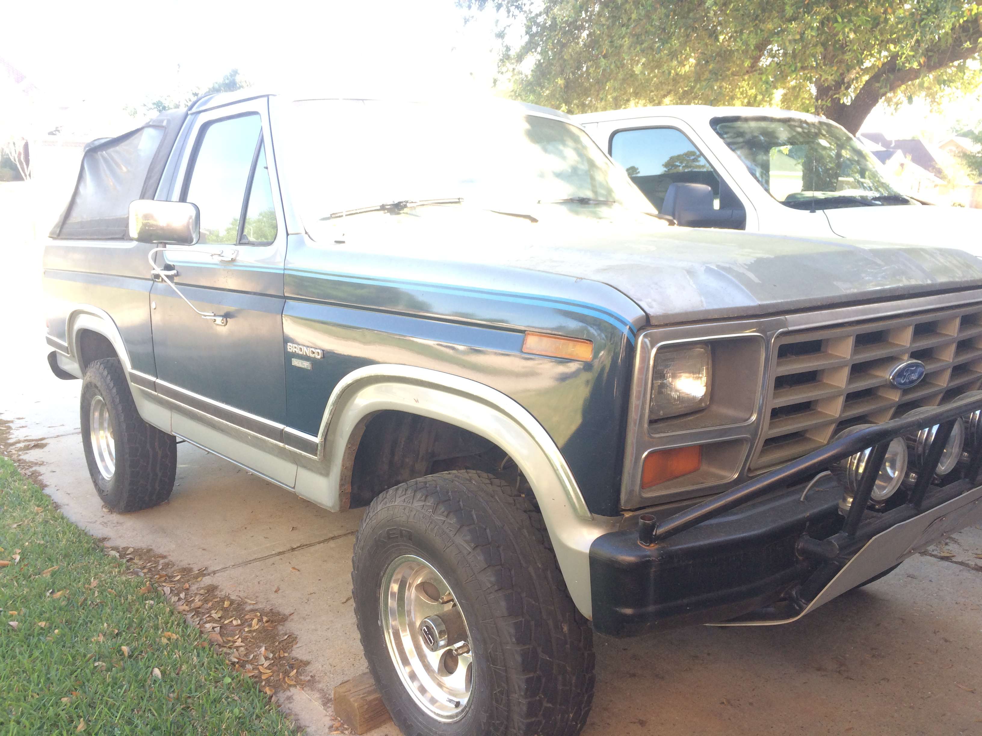

Looking good! How do you like the soft top? I want the same soft top for my 81'

I like it. Installation was a bit odd, could have been my poor reading comprehension skills. I think the designers could learn something from Lego when it comes to intructions. There are some gaps where the top meets the body but I haven't had any leaks. The bottom attachment for the rear window is a permanently mounted crossbar that I found to be a pain in the ass. Couldn't load anything taller than the tailgate. So I cut that off, trimmed it and riveted it to the tailgate. Those are the only complaints.
It's a buttload lighter than the hardtop. All windows are removeable for an open feel with sun shade. Removal is pretty easy, only takes a few minutes. Overall quality is pretty good. Felt a noticeable difference in driving vs the hardtop.

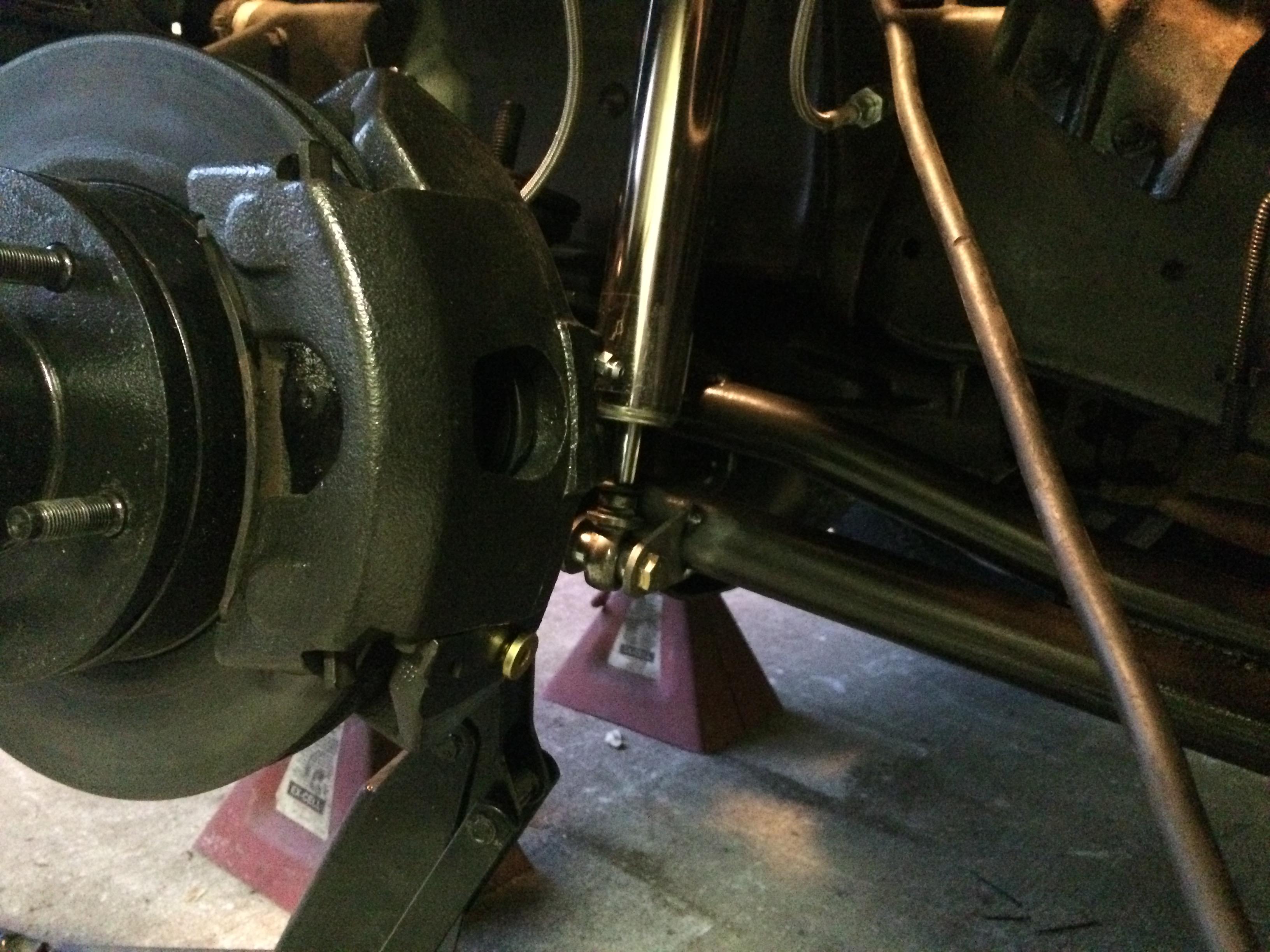

Was able to collect a few more bits and pieces. Lee at Raceshock talked me into a full set of 12" short body 7100 RR's he had. All rebuilt, revalved and ready to go. Tacked in the mounts and checked for binding... all good. Without coil I get a full 16" travel. With coil (which will be my limiter) I anticipate 13" useable travel. Still have an inch plus of shaft at full compression and full droop, so I should be more than safe in the off chance I get airborne and land hard.

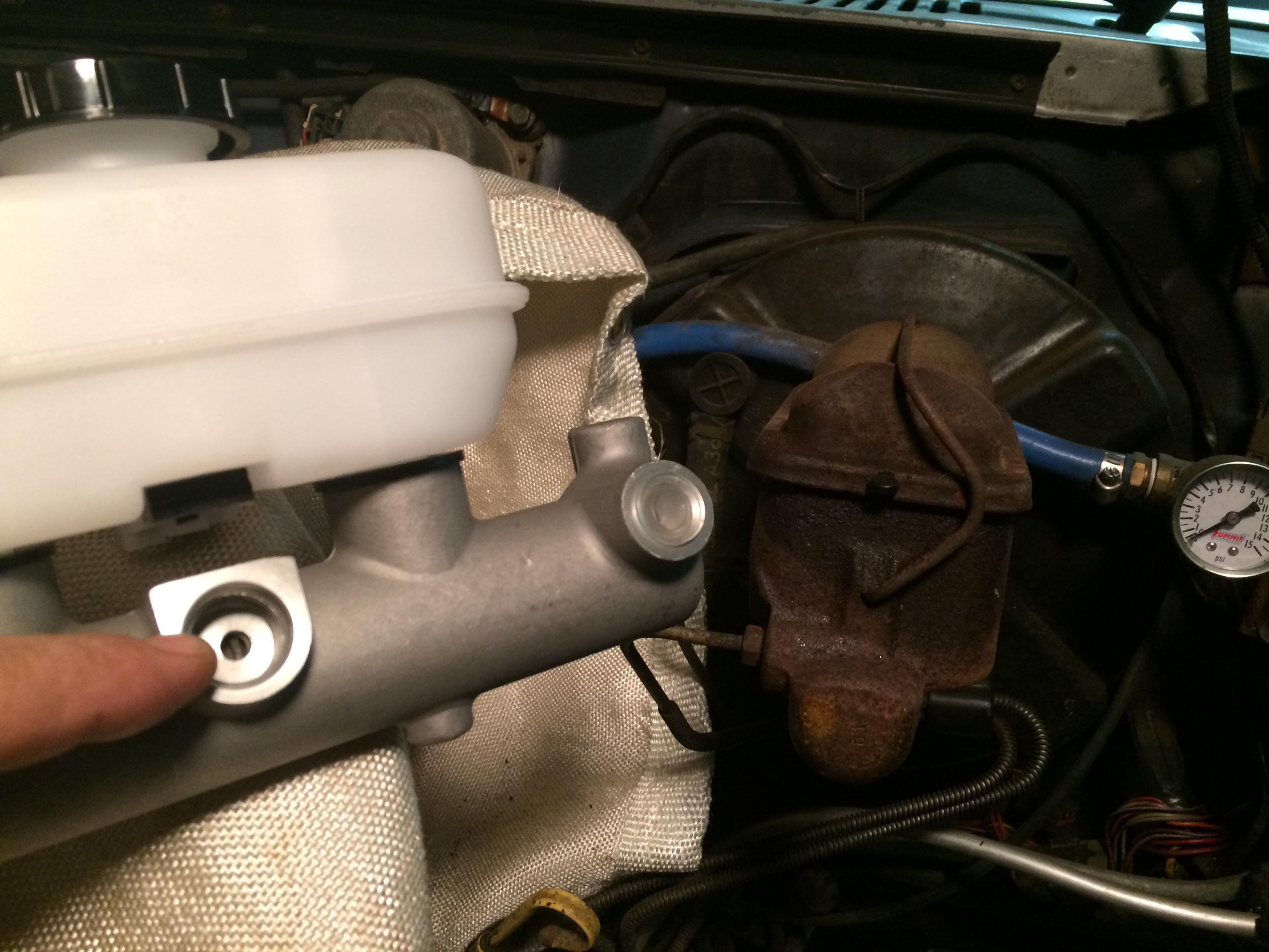

What adaptor do I need to find for this?
Want to keep basic brake setup, but damn I loathe the original cast master cylinder.
Bought a later model M/C and now I'm scratching my head.

It was an odd size. I'd say get one off a later model and put it on your brake line. When you droop out the front make sure the axles can still turn. The center u-joint likes to bind up and you may need to clearance it. Also at droop jack up the passenger side and look at the inner axle where is come out of the window in the beam.

Yeah, there's a couple things I need to take a good look at when I get it all back together. Gonna have to rethink the upper coil retainers, make them heavier/stronger.
Got an education on the passenger side stub shaft after I installed the trac-lock differential. Unable to install the C-clip I used the ol' spring in the slipyoke trick. I'm curious how much equal droop I will get before the axle tops out. I already clearanced the center I-joint and welded the cap in place.
As for the master cylinder, I found a part # for a piece that goes there but no real answer as to wtf it is. I'm assuming it's a residual valve. But I've lurked through other threads and see a few people have renoved them and ran to a prop. valve for rear discs. I'll keep digging a hoping someone is able to enlighten me.

I can't remember the size. I think it's m12 or m20. I think there's a 2 in it. Haha. It needs an oring or one of those metal washer with the rubber on it. I bought a plug for mine and drilled and tapped it 1/8 npt and put a -3an adapter in it. All mine is -3 now. I'll take a pic when I get off work.
