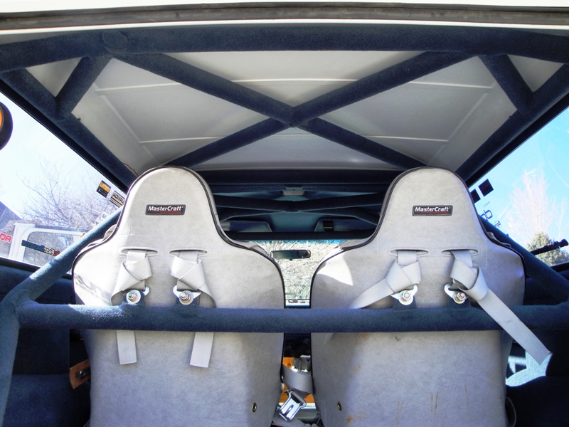

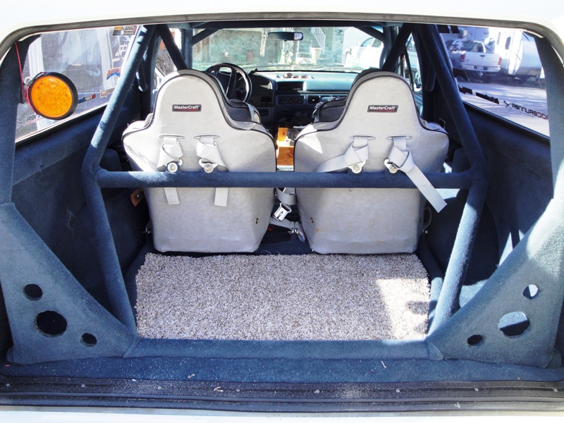

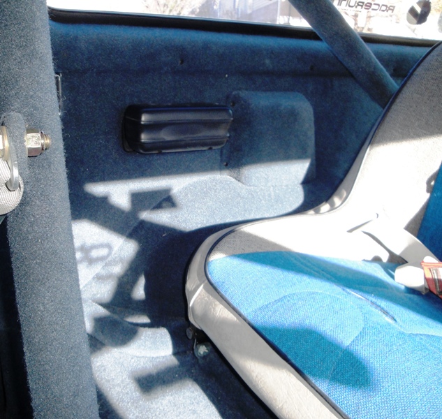

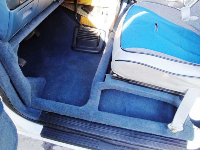

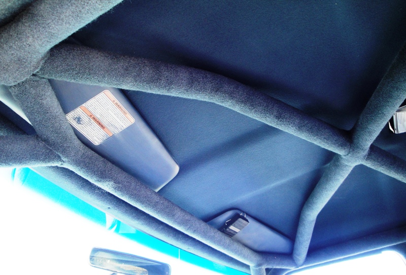

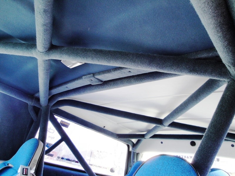

Soooo, I thought I'd provide an update on my latest enhancement...a brand new interior! Something I've been wanting to do since I got the Bronco out of the fab shop back in February of 2010....and now it's done. Gone are: the 6 open holes/gaps in the floor where the safety cage tubing passes through...the bare floor covered with the OEM rubber mat...the heat and dust that floated up through the holes...and the NOISE! Ugh...the noise! It drove my family and I nuts driving out west to Nevada to watch the BOR Wendover 300!
So, here is what I spec'd for the interior re-do:
  1. Remove all OEM rubber matting
  2. Thoroughly clean the bare metal floor
  3. Apply rust preventative to all floor surfaces and underside of floor deck
  4. Seal/close all open holes in floor (especially where the safety cage passes through) using flexible foam sealant/rubber grommets
  5. Apply spray on bed-liner to treated metal floor surfaces
  6. Apply thermal/noise barrier to top of bed-liner surface
  7. Top with heavy duty automotive carpeting, front to rear
  8. Clean, treat, and wrap all interior safety cage tubing
  9. Cover the rear interior quarter panels with the covering similar to the safety cage wrap
  10. Remove and replace the factory OEM speakers with new Kicker DS65 2-way 6.75" (F) and DS693 3-way 6x9 (R) speakers
So, a local Salt Lake City interior shop by the name of The Seat Cover Factory did exactly that for $2,300 plus tax (and more...a new headliner, carpeting of the tailgate access cover at no extra cost...) Sure, it took a month a half, but well worth the wait!
I can now carry on a normal conversation, and even talk on my cell without issue...and it's almost too quiet now! But it was all very much worth it! No noise, no heat/cold, and no more dust...and it's all sealed up now with the appropriate preventative coatings so I no longer need to worry about corrosion. Phew!
Enjoy the pictures...

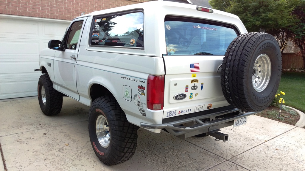

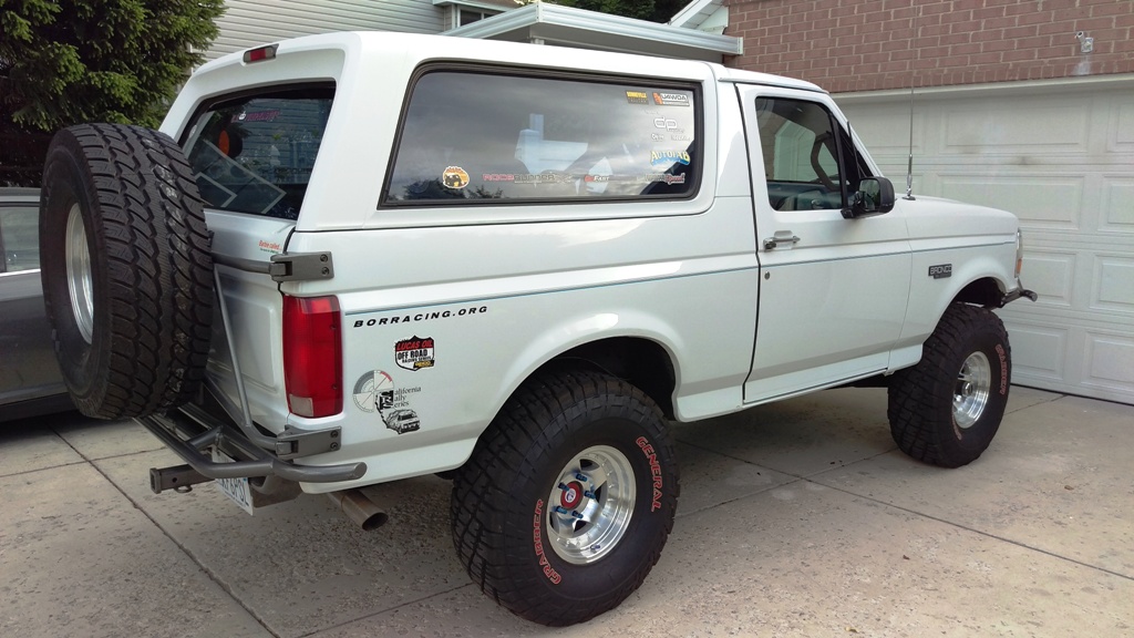

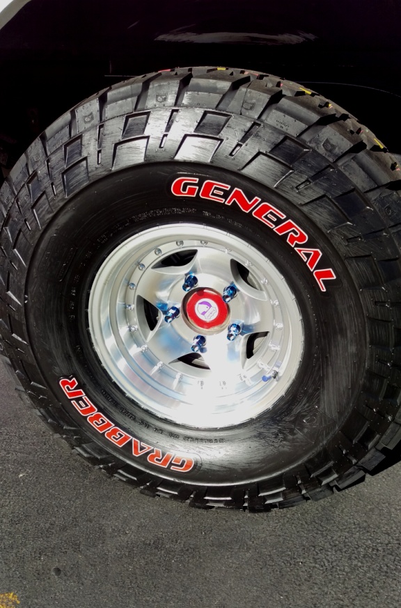

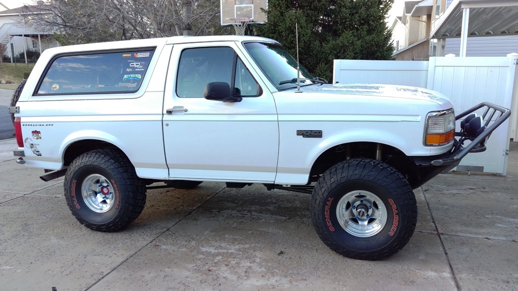

Just washed and photos taken of my new'ish AR23 wheels and General Red Letters, 35x12.50R15...
Now I need to go get it dirty!

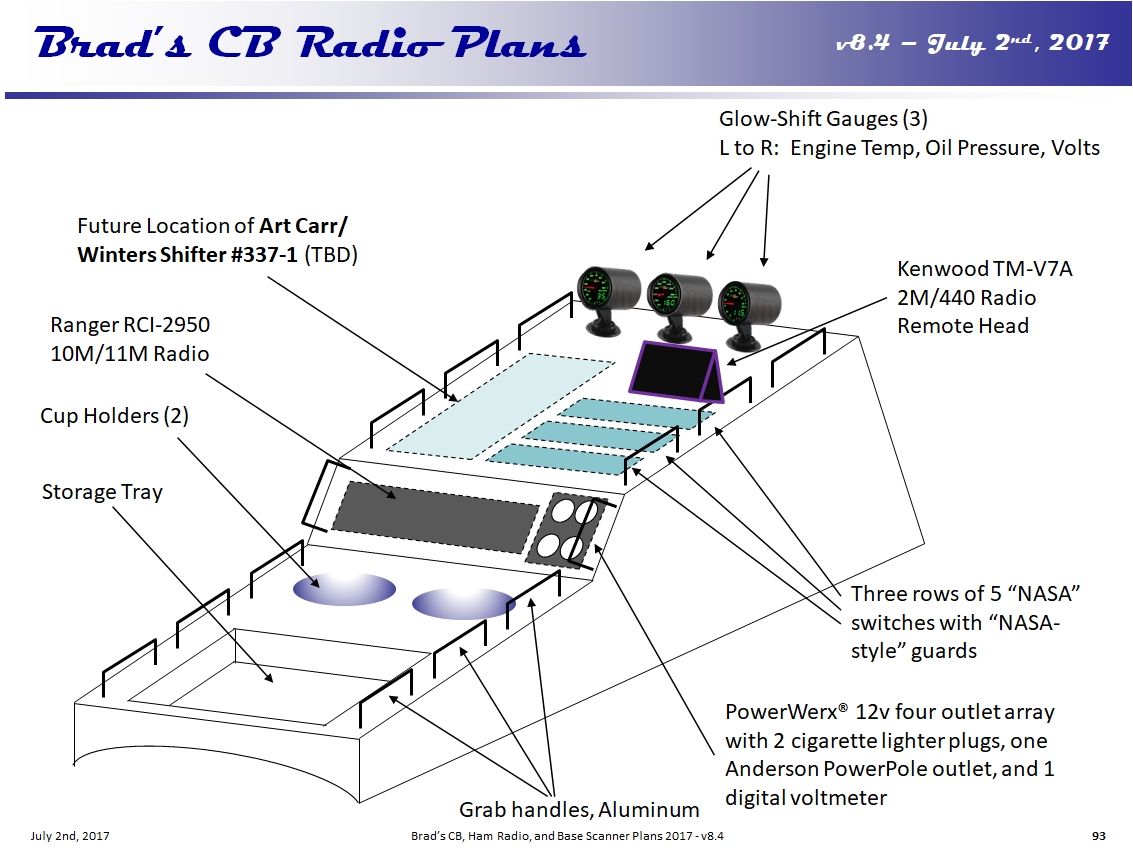

Today I'm starting my center console design, and will soon kick off it's fabrication, and then install of my two Ham radios (Kenwood TM-V7A 2M/440 and Ranger RCI-2950 10M), along with some gauges from GlowShift...and of course an assortment of cup holders...natch! I've embedded a photo of the center console design below...
2017-07-23 14.21 Brad.jpg (325.03 KiB) Viewed 2710 times
96 Broncospeed AR23 Wheels 15x8 (1024x768).jpg (211.77 KiB) Viewed 2710 times
96 Broncospeed New Generals & AR23s (2) (smaller).jpg (298.32 KiB) Viewed 2710 times
96 Broncospeed New Generals & AR23s (4) Smaller.jpg (241.38 KiB) Viewed 2710 times

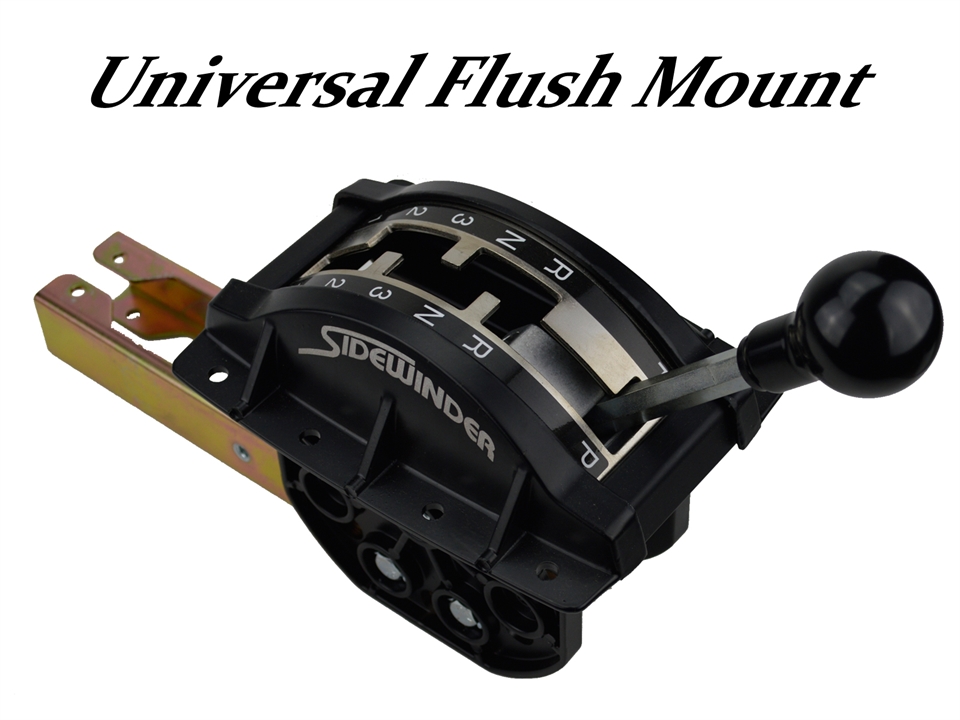

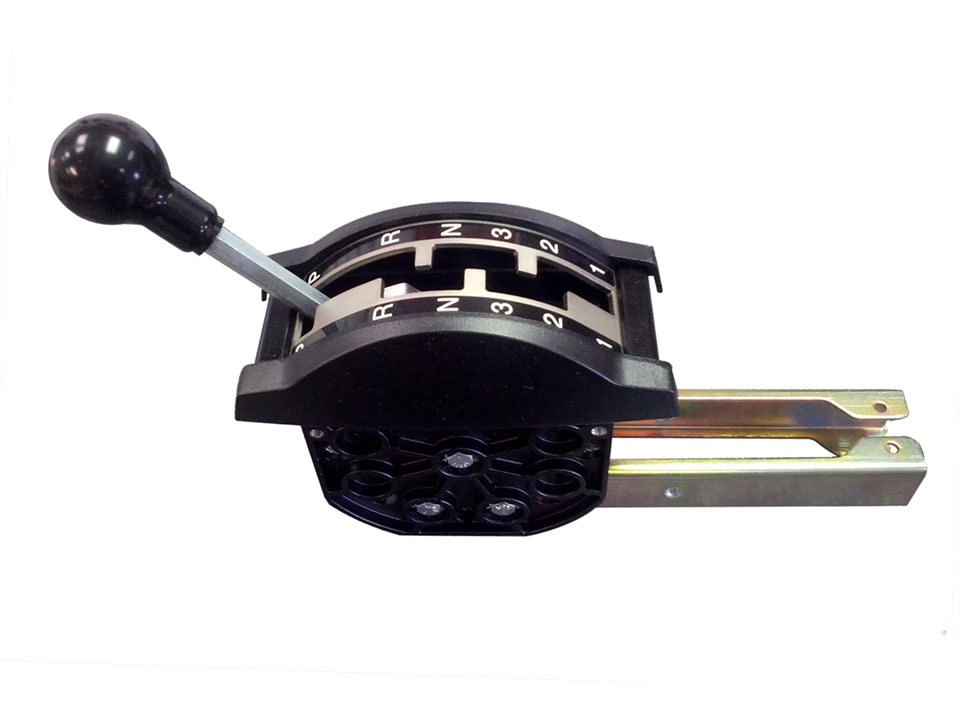

(I'm still considering a flush mount gated shifter from Art Carr/Winters (#337-1, E4OD regular pattern) for the center console...but...I still haven't made up my mind on that. Besides, how would I route the OD button from the stalk? I guess folks just move the toggle to the dash... E4OD Shifter - GoFastBroncos.com)
Art Carr Winters #337-1.jpg (116.79 KiB) Viewed 2710 times
Art Carr Winters #337-1 (2).jpg (219.74 KiB) Viewed 2710 times

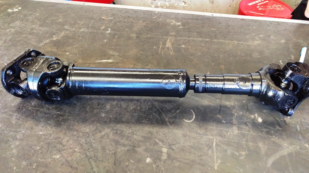

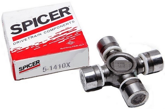

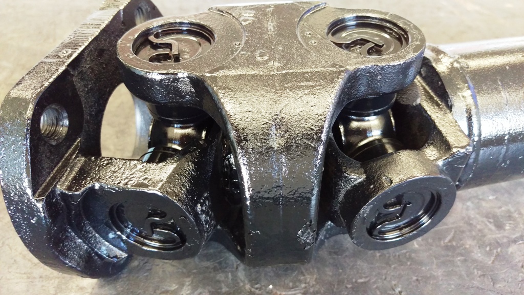

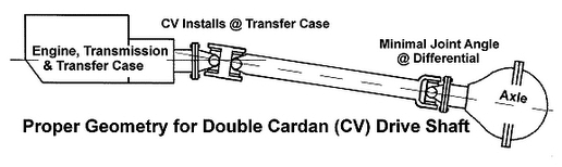

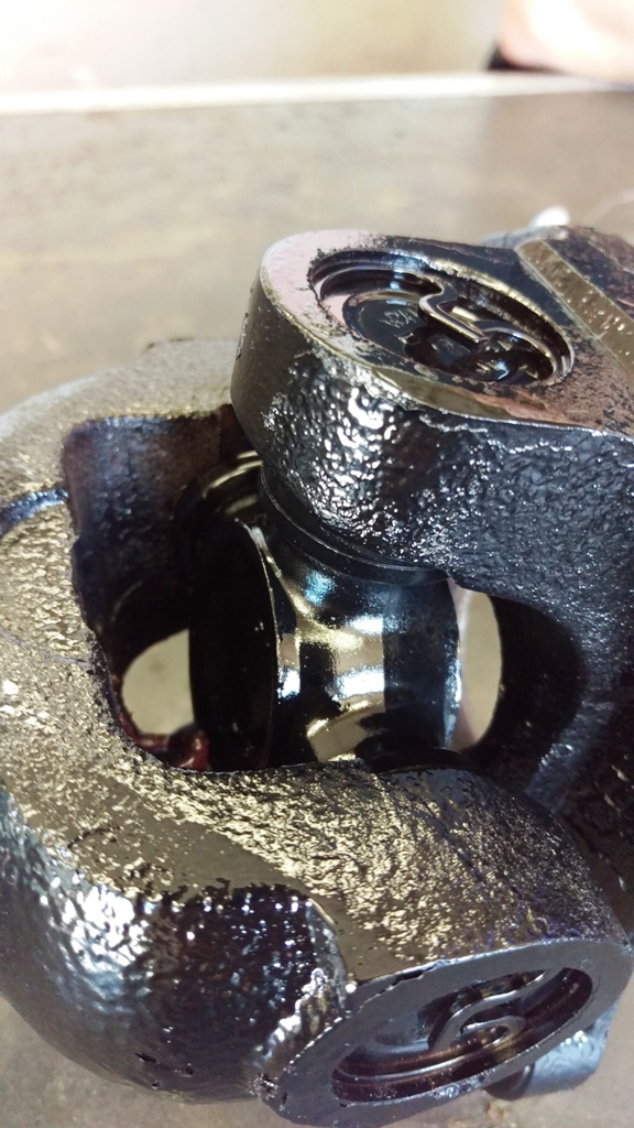

  1. Clocked Rear Axle & Spicer "Life Series" HD Lubed-for-life U-Joint Upgrade by GRS Drivelines: I cannot believe that I waited 8 years to get this fixed. As it turns out, my original fab shop installed my Autofab rear suspension with the 8.8 axle pinion in parallel with the output shaft of the transfer case. So from day 1, I've had this annoying vibration and sounds from my rear axle. When I took the Bronco to a local shop last August (GRS Drivelines, SLC UT) for some new greased-for-life Spicer U-joints, they said they'd only work on it after I had my rear axle properly clocked. It needed to be where the 8.8 pinion was in alignment with the incoming driveshaft (e.g., nearly zero deflection in the rear U-joint.) So I went back to my fabricator and he properly clocked the rear axle as desired (see picture). In doing so had to shorten the Autofab trailing arms wee bit. But when I drove away, all the noise and vibration vanished! Holy cow! I then took it over to GRS a week later and they installed the new Spicer "Life Series" 1350s in the double-cardan joint (along with a new centering kit), and a 1410 u-joint in the rear. Suh-weet! Talk about smooth and quiet performance? The trip to Boise and back last month was truly a pleasure with this new driveshaft!
    GRS Driveline Upgrade - 1024x768 (4).jpg (236.82 KiB) Viewed 2706 times
    GRS Driveline Upgrade - 1024x768 (3).jpg (279.94 KiB) Viewed 2706 times
    GRS Driveline Upgrade - 1024x768 (2).jpg (247.19 KiB) Viewed 2706 times
    Spicer Life Series 1410 U-Joint.jpg (111.89 KiB) Viewed 2706 times
    Bronco Drive-shaft Alignment.jpg (45.69 KiB) Viewed 2706 times

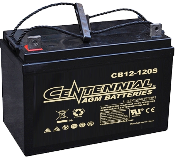

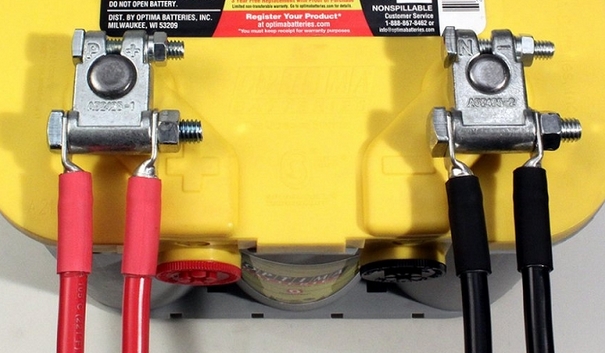

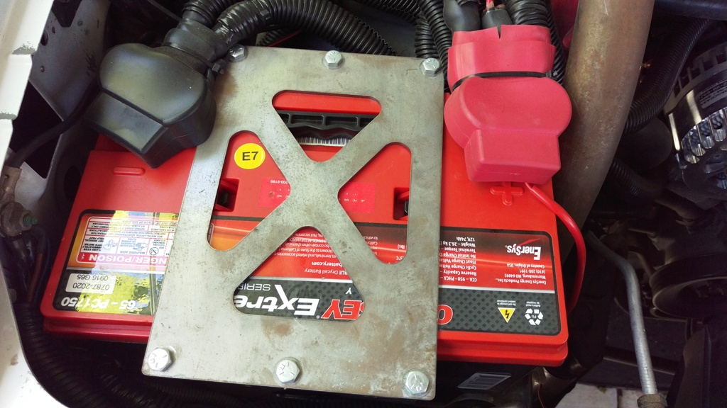

  3. New Dual AGM Batteries - One starting & one amateur radio deep-cycle high Ah rating: I purchased a new Odyssey #PC1750 (950 CCA Group 65 AGM starting battery) for the engine compartment, and a back-up Centennial #CB12-120S (118Ah deep-cycle AGM for the rear compartment) to power my two amateur radios (a Kenwood TM-V7A 2M/440 radio, and a Ranger RCI-2950 10M radio). The two radios will be wired directly to the Centennial battery using Anderson PowerPoles and red/black zip wire. James also installed a Stinger battery isolator as well.
  4. New High Amp Alternator - DC Power Engineering 270 XP (270 Amp 3G) https://www.dcpowerinc.com/7768-6k-270-xp.html: James works with DC Power Engineering for nearly all his competition audio systems (often times using dual and triple alternators!), so with my unique power demands (Hella 4000 and Hella 500 off-road lights, Massive #BX4 4x120W stereo amplifier, ham radios, 10M linear amp, future sub-woofer, etc...), 270 amps will be more than enough...and with 180 amps at hot idle (200F) , I should have no worries for any future upgrades.
  5. New HD Battery Mounts from Artec Industries: I've actually been driving around with a smaller Group 31 starting battery for years...as the Autofab shock hoops prevented the OEM Group 65 battery from fitting into the stock battery tray. D-oh! So I made sure that when I upgraded both batteries, that each would get it's own HD off-road battery tray/mount! I found Artec Industries (here in SLC) at the SLC Off-Road Expo 2016, and they make some nice mounts...so I went with them. James found a way to mount the PC1750 the same way the stock battery was mounted, so I didn't have to relocate the vacuum canister or anything else on the passenger side of the engine compartment.

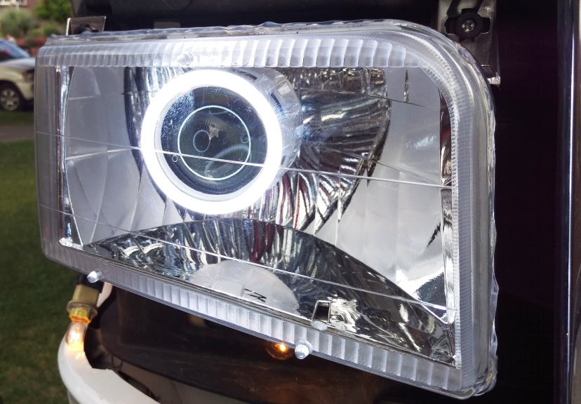

  6. New HID Projector Headlights and New Rear Euro-Style Housings by HID Retrofit LLC: My old housings were cloudy and the left one's internal reflector was loose and rattling around inside...not to mention the water inside the housing. So I found HID Retrofit LLC here in SLC, and the proprietor built me some real nice clear housings with chrome reflectors (not that I need them), using some cool HID reflectors with hi/lo beam and halo rings. The halo rings also flash in amber when that side turn signal is on, but remains white otherwise. I first used these new lights at the Idaho Rally International last month in Boise, and wow, what a difference. There is a sharp cutoff on lo beam (they have to be raised again as they are just too low) as I find that I overdrive my lights on dark back roads. I also had him upgrade the rear lights to some new Euro-look clear lights that have a dark bezel. Really a nice improvement all the way around!

  • Custom Center Console for Ham Radios/Accessory Switches/New Glow-Shift Gauges/Cup Holders

Big 5 Wiring and Batteries...
Military Battery Terminals.jpg (153.56 KiB) Viewed 2706 times
Centennial CB12-120S AGM Deep Cycle 118Ah Battery.jpg (188.72 KiB) Viewed 2705 times
New HID Projectors (3).jpg (229.37 KiB) Viewed 2704 times
New HID Projectors (1).jpg (187.9 KiB) Viewed 2704 times
