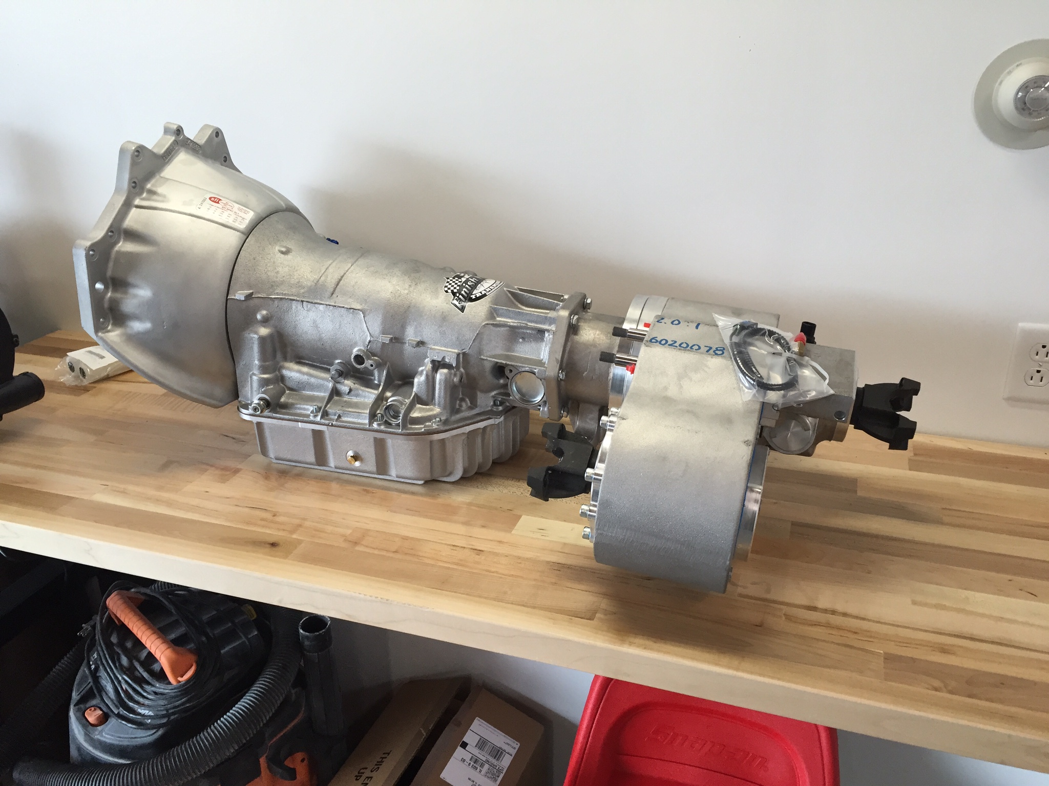

LS3/TH400/Atlas II

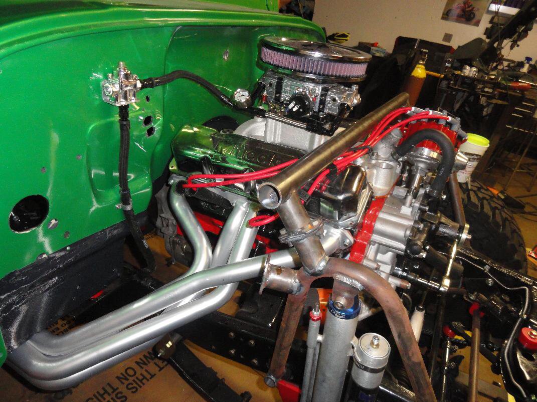

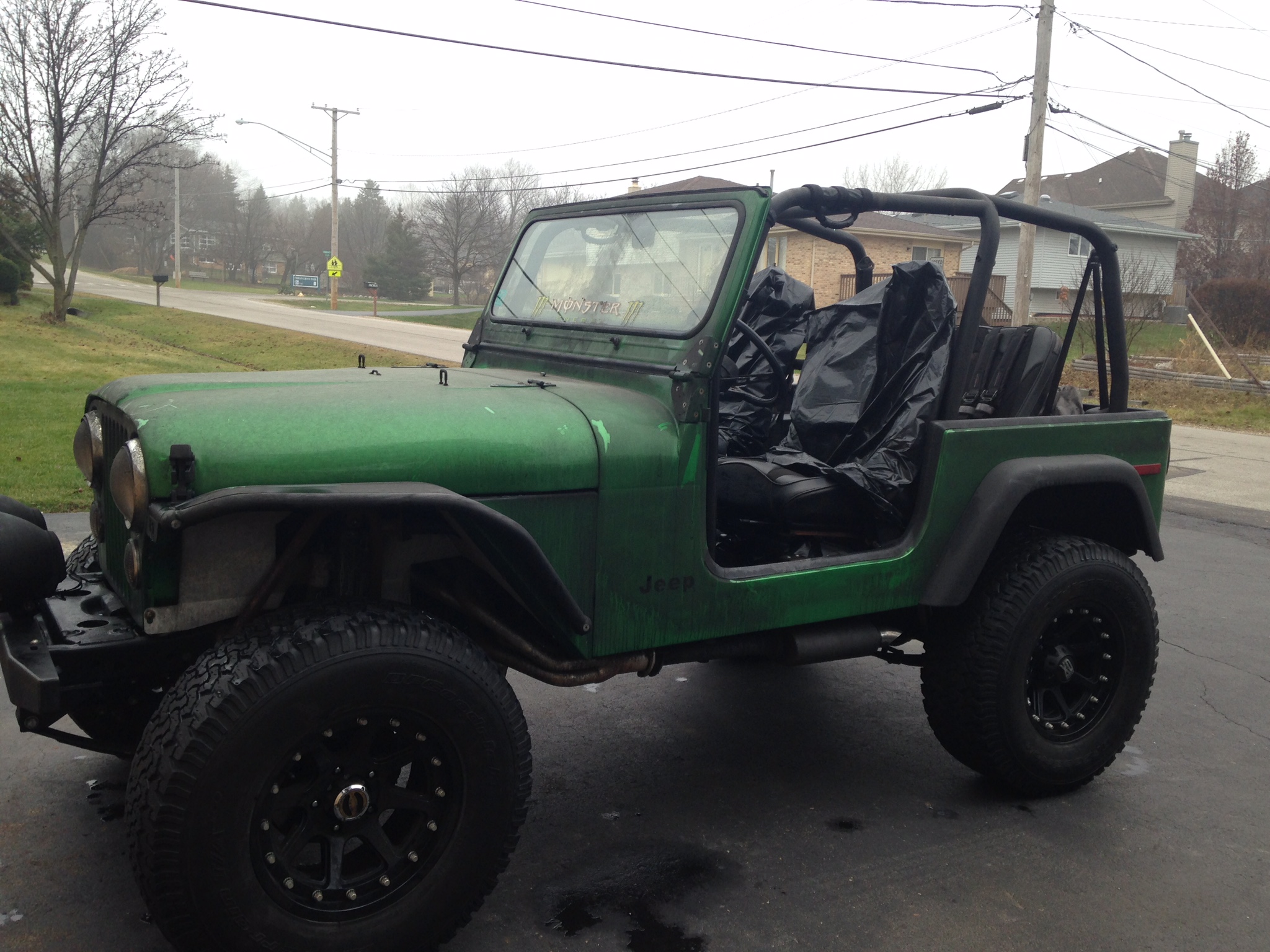

This is the jeep that has it's soul in my Bronco. It was a frame off restoration done entirely by myself with the exception of the paint. It had a build AMC360 running race gas and around 400-450hp, 4.56 gears with Detroits, 35" BFG's, mid travel leaf springs with Fox bypasses, full cage, Mastercraft seats, etc.
- IMG_2387.JPG (104.36 KiB) Viewed 2676 times
- IMG_2388.JPG (140.52 KiB) Viewed 2676 times

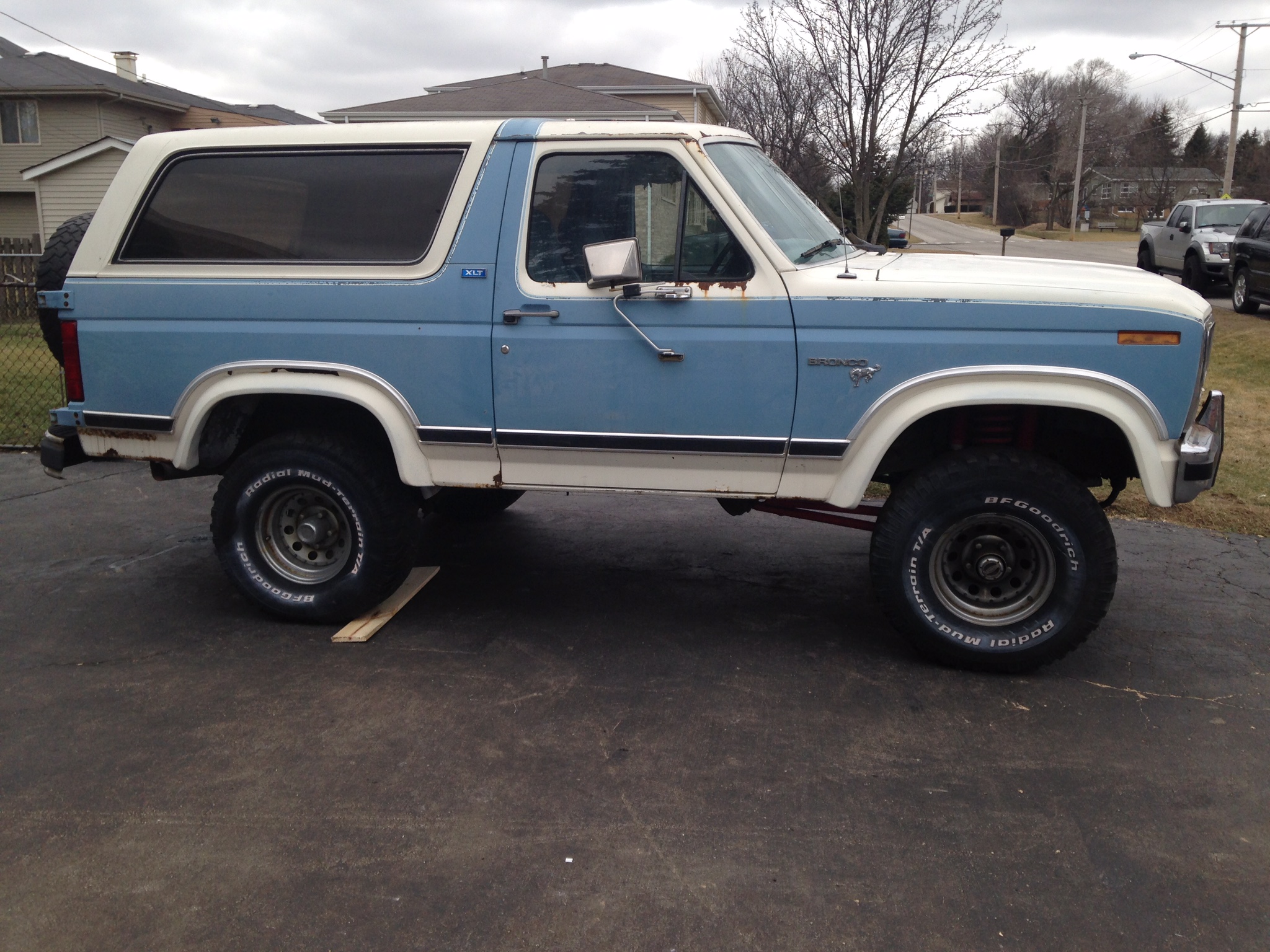

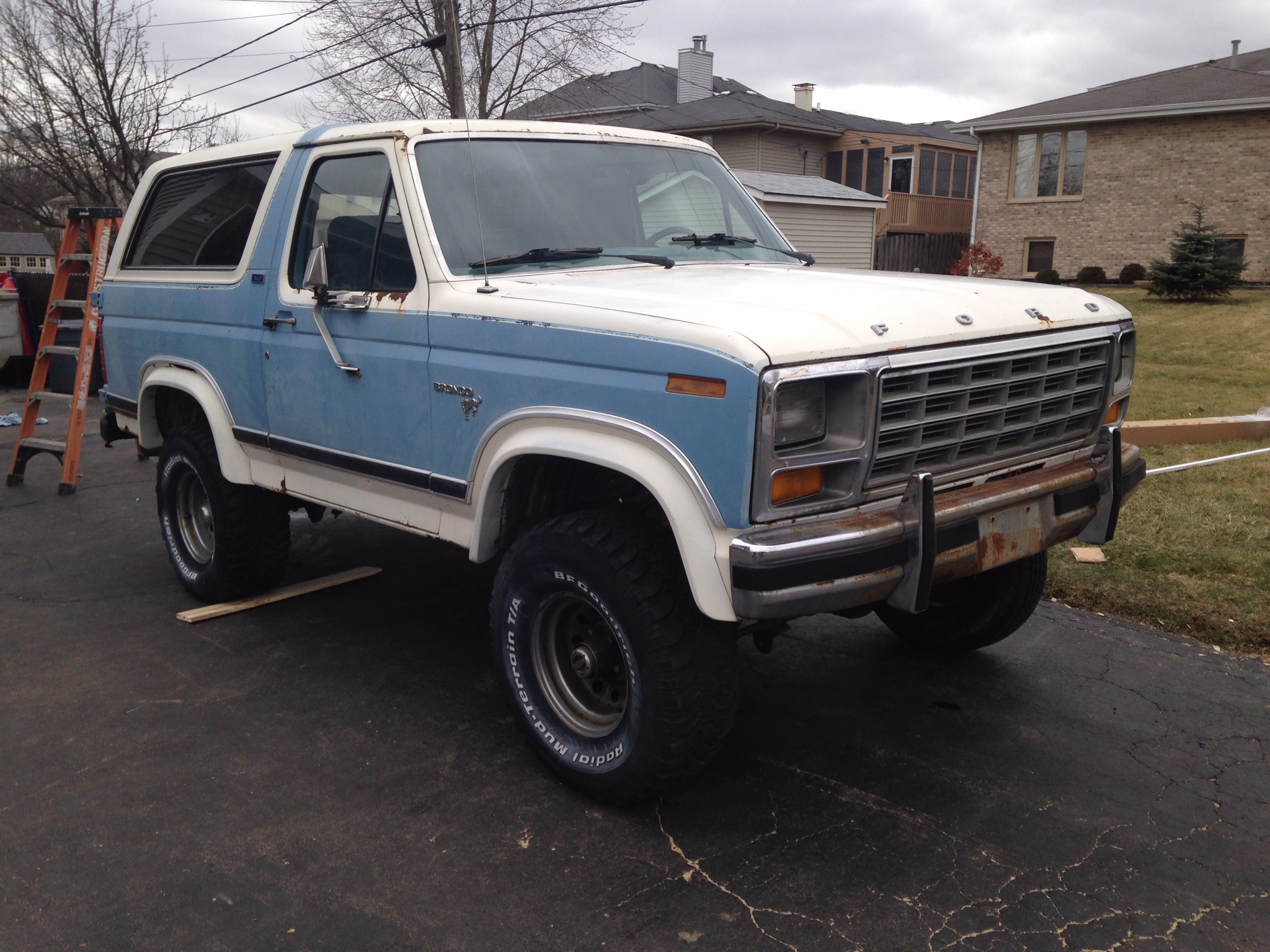

So here's the Bronco. It's an 81 Ranger model which was pretty much loaded. It's got power everything, 351m, C6. I wish it weren't optioned out so I'd have manual windows and locks, but oh well. I gave the drivetrain to my buddy since I will not be using any of it. It also came with an old school Rancho 4" lift kit. It will stay that way until phase 2 of the build when I go extended C&T front end with coilovers, full float widened 40 spline 9" rear and 4 link. So far I've only gutted the interior and cleaned up the engine bay. I will be boxing the frame and welding all the front cross members to the frame before I install the new drivetrain. I plan on going full chromoly cage front to back as well. I have aluminum solid body mounts and ordered up a ton of chromoly tubing. Most of it will be 2"x.120", but I also have 2"x.095", 1.625"x.120" and 1.625x.095" tubing for gussets and mounts. I bought 320' of it since it was cheaper by the qty. and I can sell what's left.
- IMG_1722.JPG (620.21 KiB) Viewed 2675 times
- IMG_1724.JPG (536.77 KiB) Viewed 2675 times
- IMG_1723.JPG (514.25 KiB) Viewed 2675 times
- IMG_1589.JPG (974.12 KiB) Viewed 2675 times
- IMG_1588.JPG (965.56 KiB) Viewed 2675 times

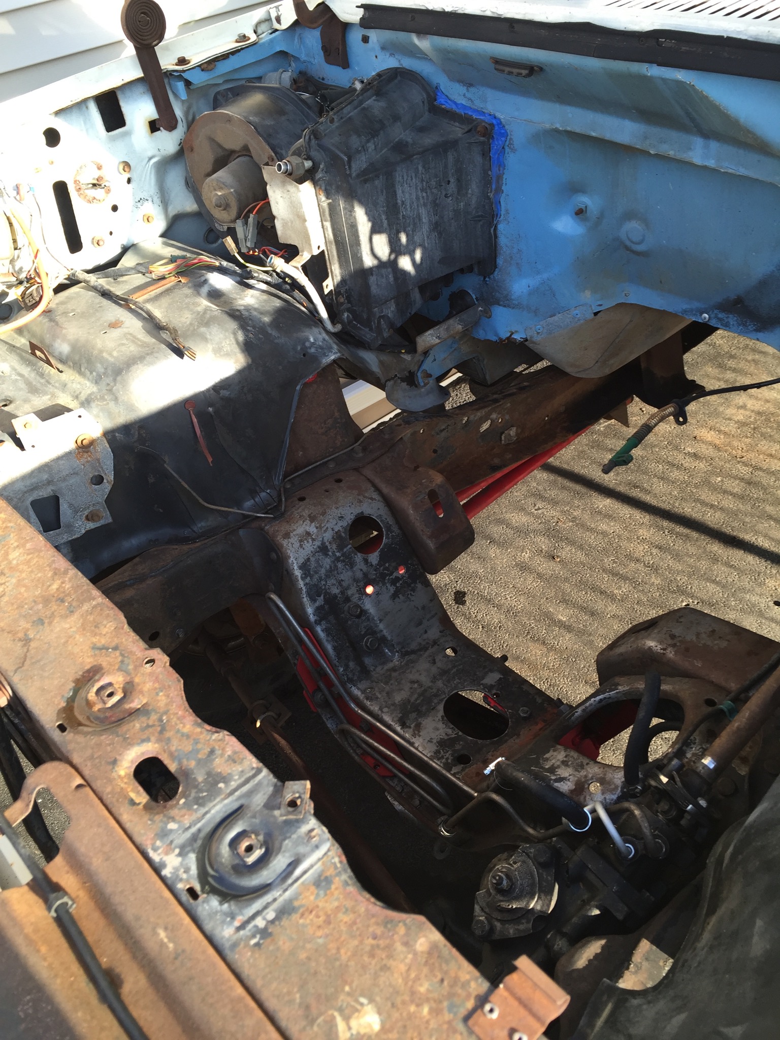

Cleaned engine bay

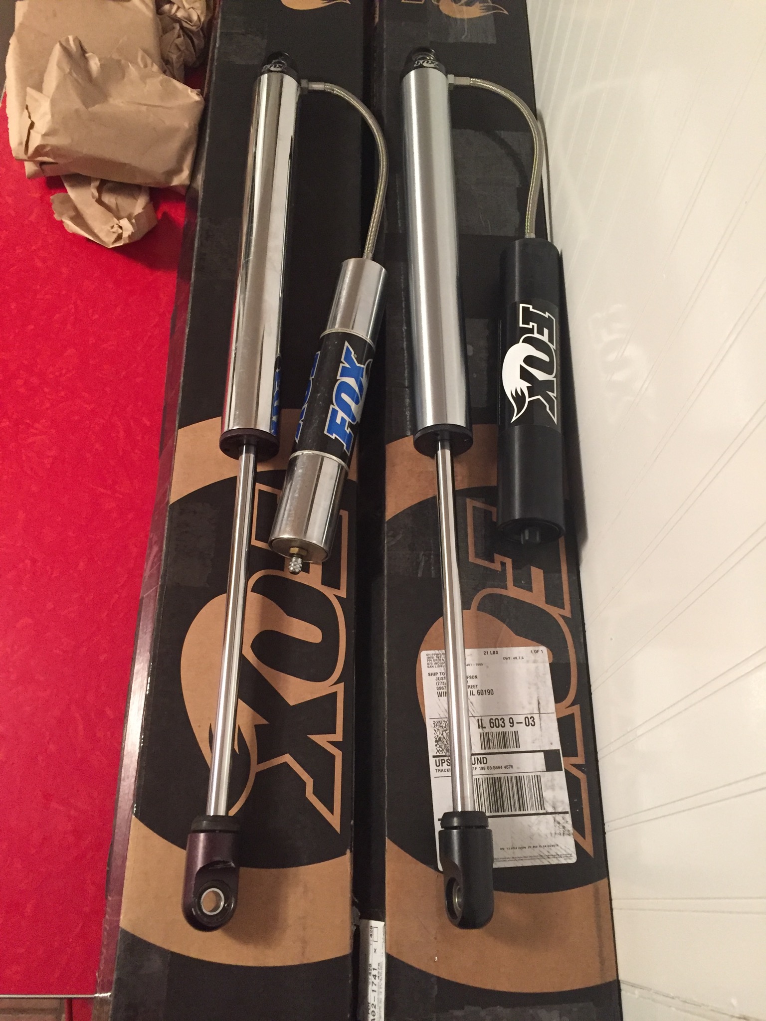

For now, I'll be running the suspension pretty much as is. I did pick up some FOX 2.0's for the front since the 25 year old Rancho 5000's are ready to fall apart. I will be sending out my old rear Raptor Fox 2.5's to get rebuilt and revalved for the rear of the Bronco too. I kept my mint 35x12.50-17 BFG KM2's from my jeep for the Bronco, though now i'm thinking of going 37"s. I got a great Black Friday deal on some 17x9.5" Raceline beadlocks so they are all mounted up

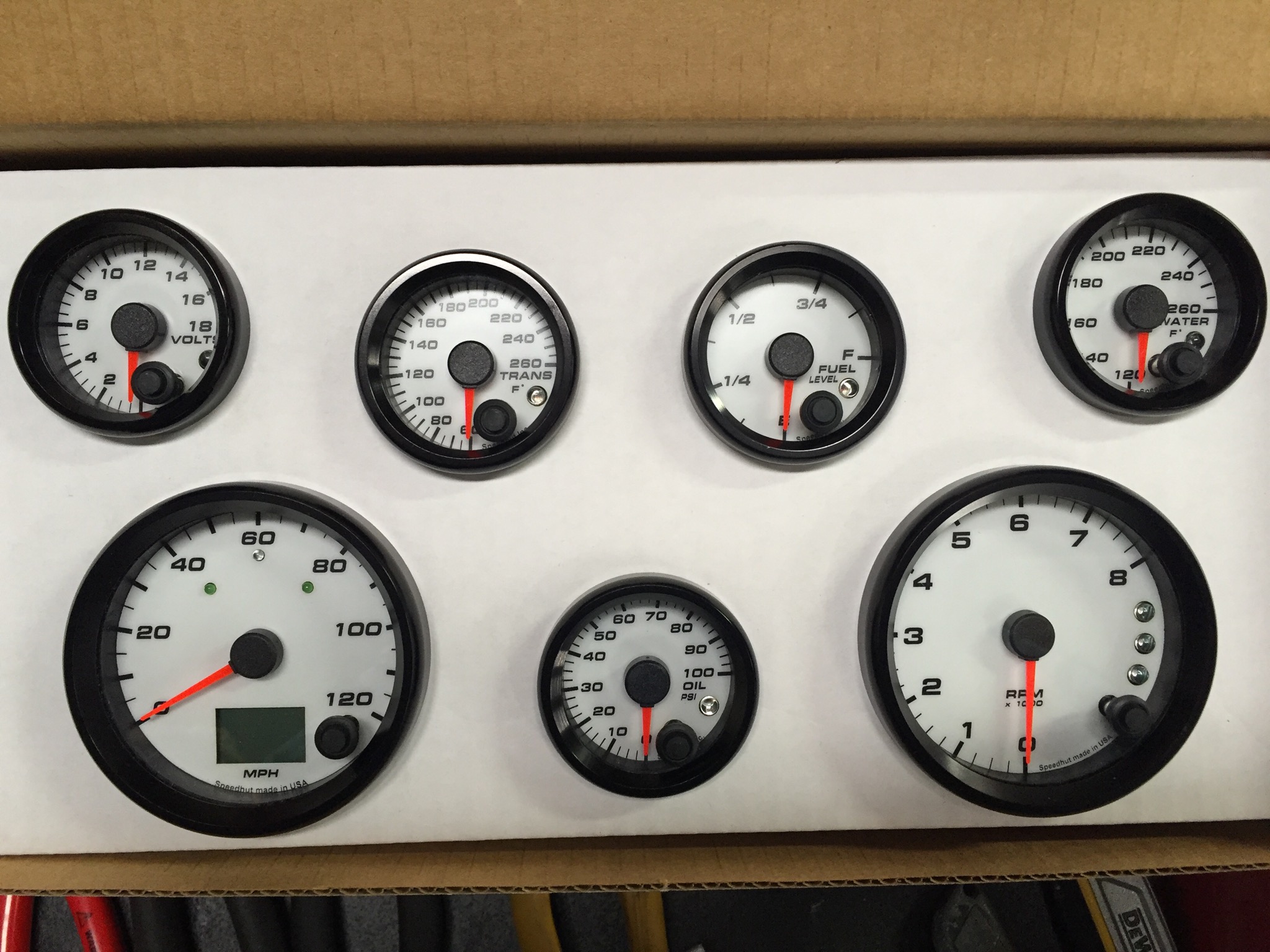

I ran Autometer's in the Jeep, but wanted to try out the Speedhut gauges. They are made in USA and will easily hook up to the LS platform. Autometer's need a lot of expensive senders to use them on an LS motor.

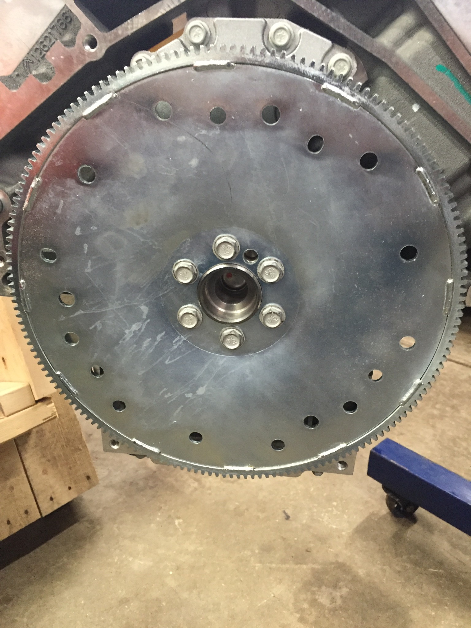

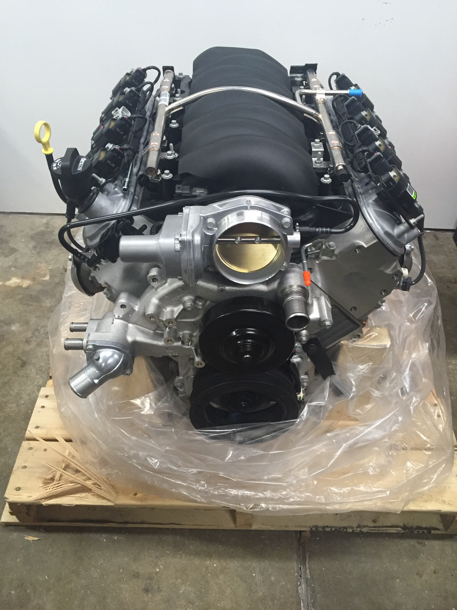

So, I know I'm going to catch a lot of hell, but I'm running LS power. I learned my lesson the hard way building an AMC motor because I wanted my jeep to be "all AMC". I had over $7,000 into that motor for 400-450hp and it just wasn't worth all the aggravation. FORD is not sponsoring my build so I'm going with what I think is the best bang for the buck. I bought a crate GMPP LS480 LS3. It's rated at 480+HP, all aluminum, capable of handling much more power, and is SMALL. I have future plans of adding a 4.0L Whipple super charger and this is a good platform for it. I am bolting this up to a TH400 and an Atlas II. I had Finishline Transmissions build me a reverse manual valve body TH400 with 300M input/output capable of 1500hp. They installed a super bell bell housing and B&M cast aluminum pan as well. I wanted the case as strong as possible with the Atlas hanging off the back. I only wish the Reid racing case was in my budget! I ordered the Atlas with a 2.0 low range since I will never be rock crawling with this and so I can actually use the low range if I want at the dunes. I am running a Circle D HD SFI flexplate and one of their billet 3,600 stall converters and a Winters shifter.
- IMG_1757.JPG (646.01 KiB) Viewed 2668 times
- IMG_1653.JPG (707.94 KiB) Viewed 2668 times
- IMG_1654.JPG (765.45 KiB) Viewed 2668 times

LS3
- IMG_1649.JPG (970.25 KiB) Viewed 2668 times
- IMG_1647.JPG (908.51 KiB) Viewed 2668 times

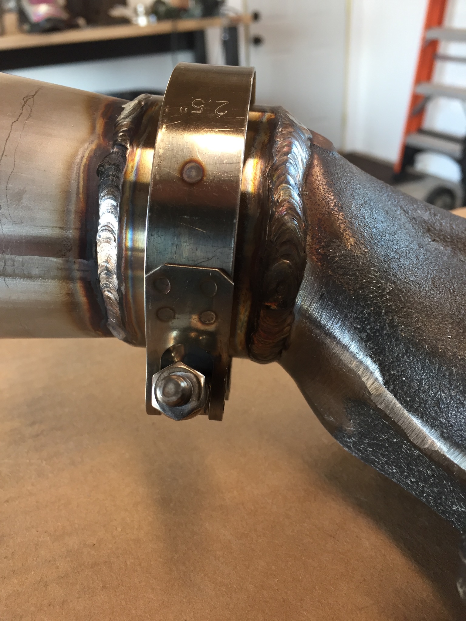

I am going to run the stock manifolds for now. I did cut the 2 bolt flanges off and weld on some 2.5" V-bands. Then I welded 2.5"-3" reducers on so I can run dual 3" exhaust. It's a little big right now, but I don't want to redo the exhaust completely when it gets supercharged and long tube headers.
- IMG_1756.JPG (690.82 KiB) Viewed 2669 times
- IMG_1747.JPG (678.41 KiB) Viewed 2669 times

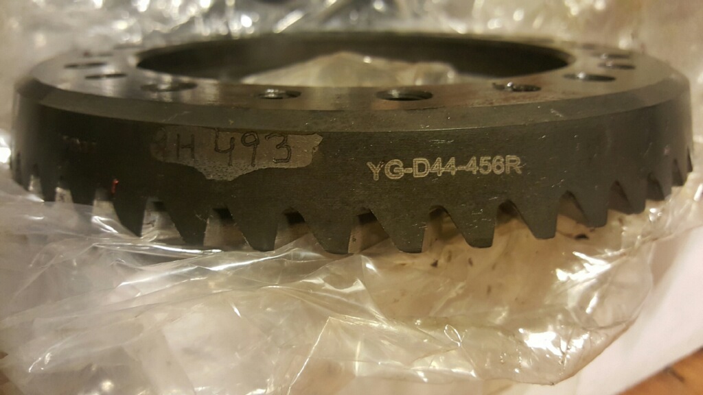

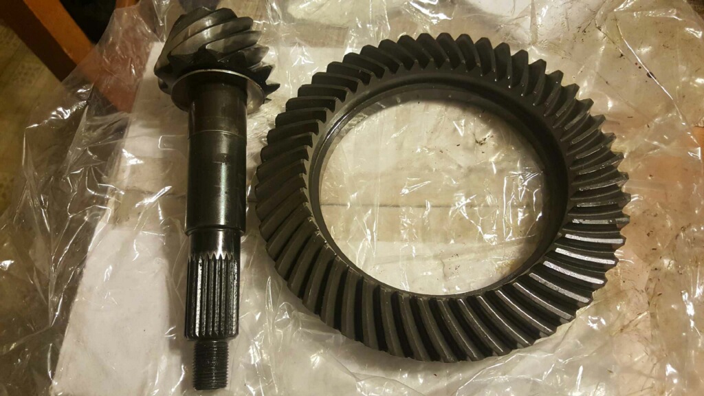

I picked up some front Yukon gears and open carrier. I went with 4.56's for now. If the RPM's are too high with the 3 speed, it will be my motivation for going up to 37"s.

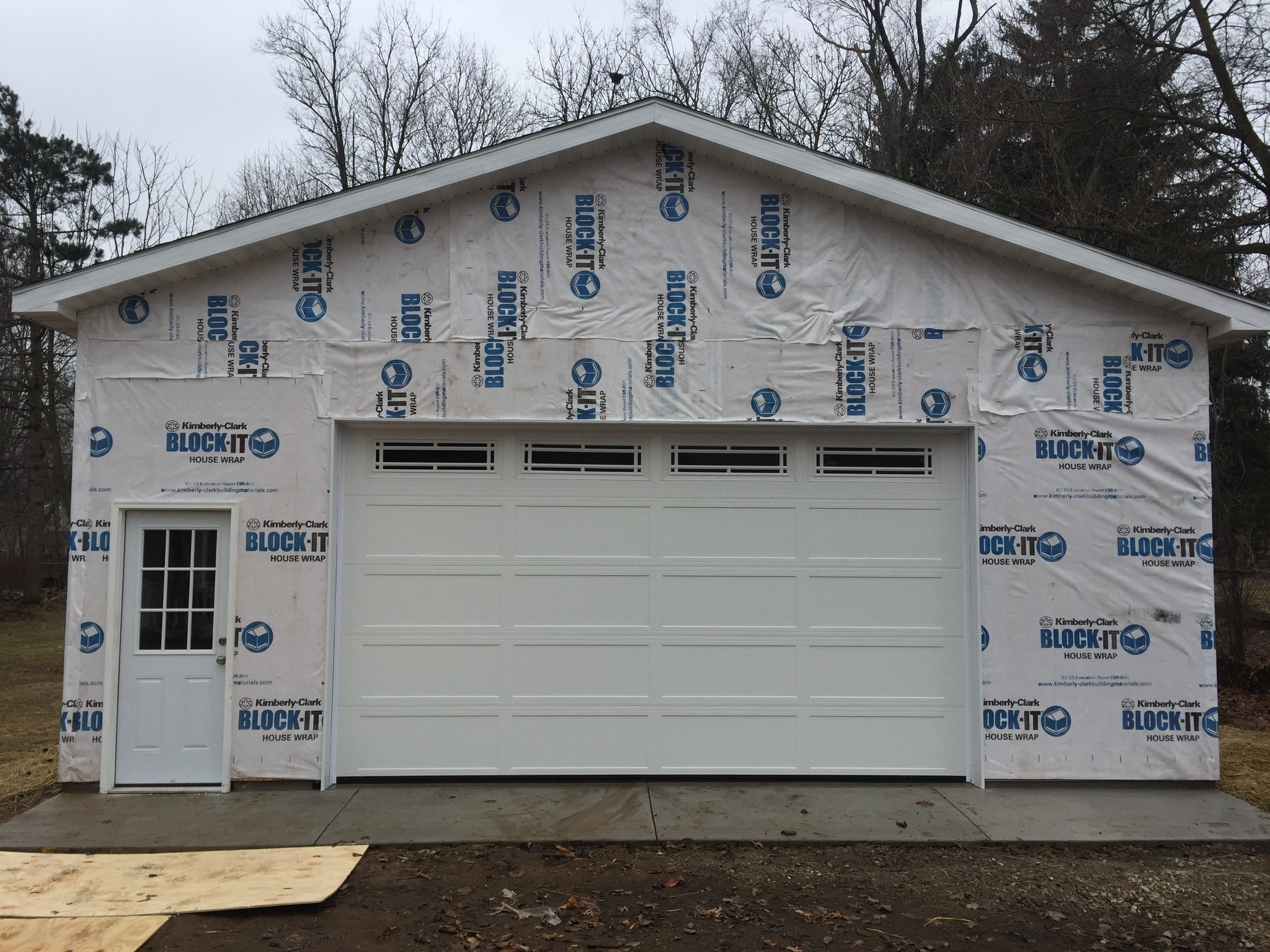

So this is what I sold my Raptor to build. It's taking longer then I hoped, but I'm doing it mostly myself with some help from friends and the wife. The plan is to put a 2 post lift in the back for the Bronco and make the back half the shop. The front half will be where I can finally park my truck and my wife can finally park in the front attached garage. I went with vaulted trusses so I have at least 13'6" on the outside of the lift and 15'6" in the center. There shouldn't be any headroom issues. I also went with 2x6 studs since the walls are almost 12' tall, plus it will allow me to add more insulation. And I put in as many windows as I could budget for. I HATE working in a dungeon so natural light was imperative. I have a 16'x9' garage door so I added windows to the top panel for more light.
This is where I'm at as of now. I'm waiting for my siding to get delivered. It's been back ordered 3 times now and I'm getting impacient. Then I can buy all the electric supplies and start running that. I'm putting a 100A box in the garage since I need 5 220V outlets. I am also running 1" gas pipe to the garage for my 2 Reznor 125,000btu shop heaters.

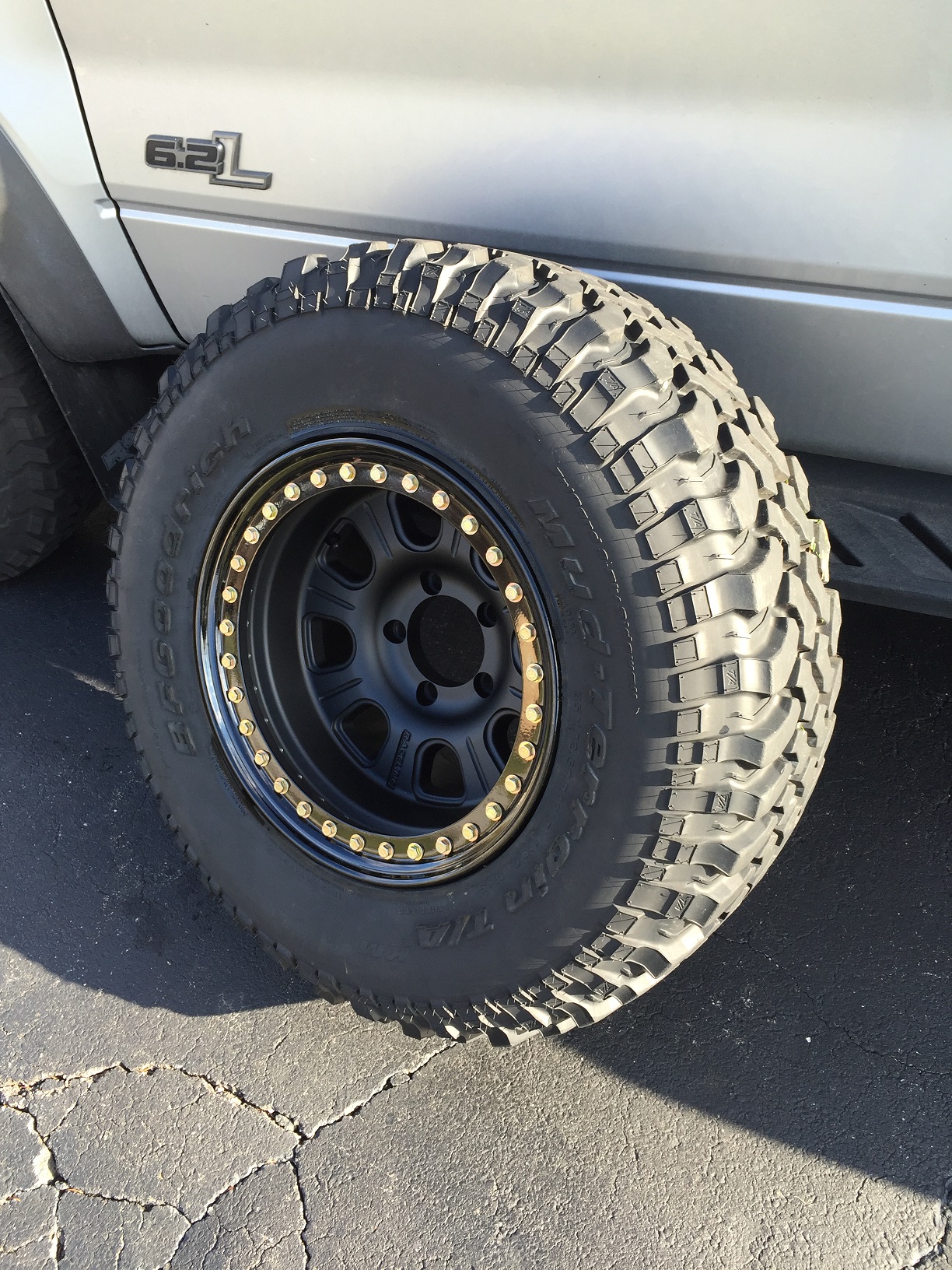

BFGs mounted up
- bfg2.jpg (825.81 KiB) Viewed 2658 times
- bfg.jpg (818.22 KiB) Viewed 2658 times
