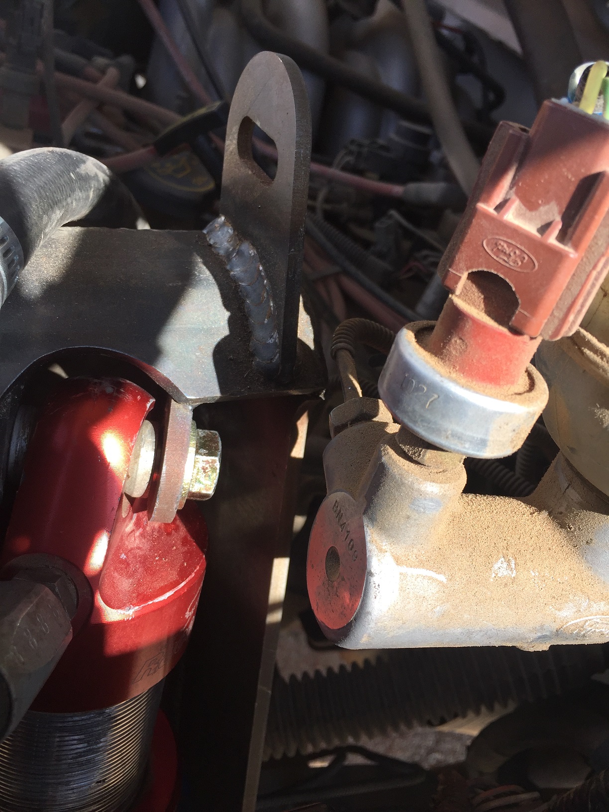

VintageIronFab,
They ran me $700 including shipping. They are 4130 chromoly and bolt directly into the stock bucket locations. In the passenger side pics you can see that it clears pretty much everything very smoothly. I might have to re-locate or redesign the "coffee" can location but other then that it fit snug. For the driver side, I to manuever some things out of the way - mainly misc stuff like hoses, cables, brake lines, etc. It cleared the master cylinder no problem. I will take some pics when I get home and upload them for you to see.

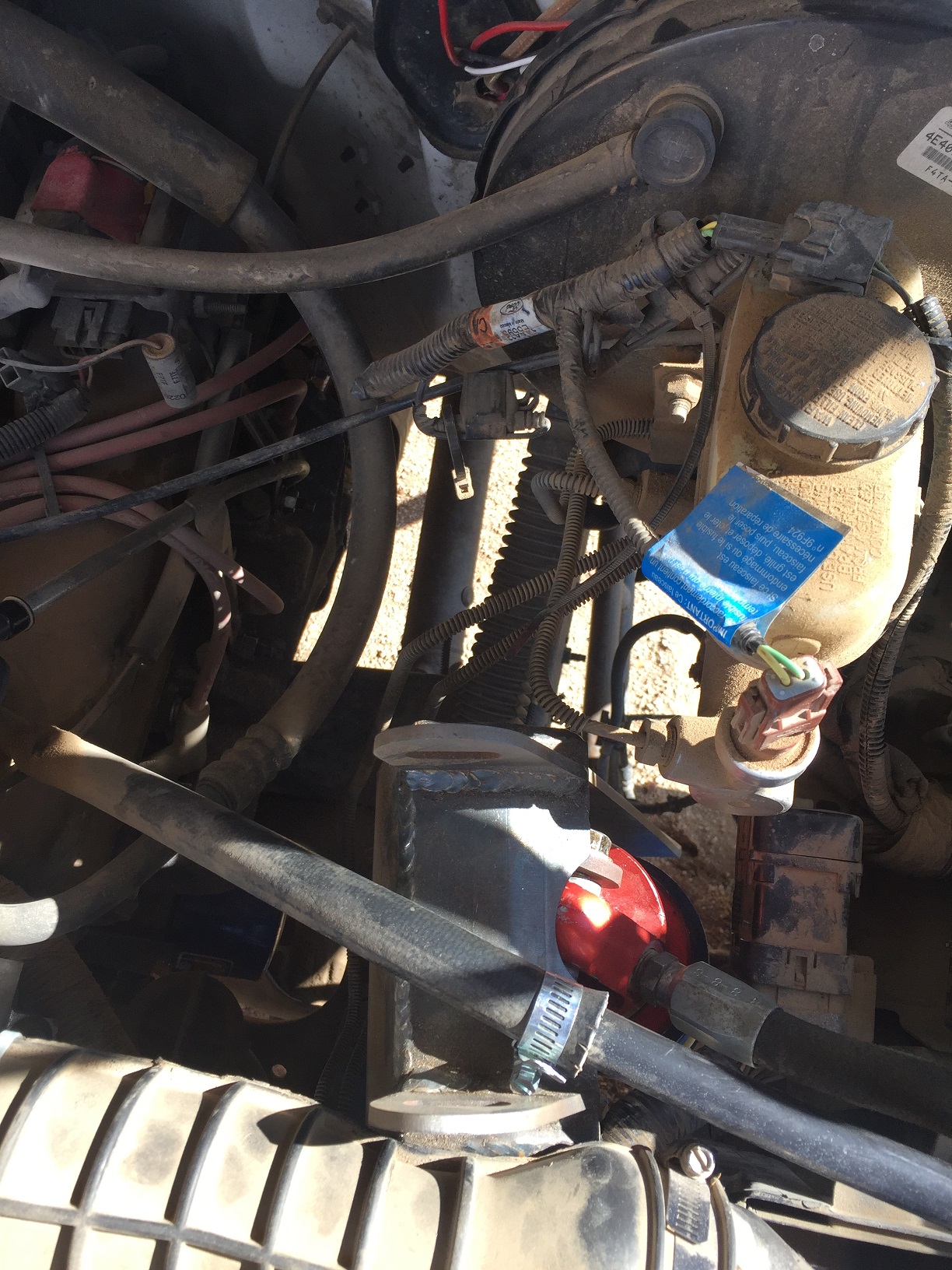

I apologize for the delay on the pictures VintageIronFab. I have been swamped with work and school. I finally had some time to work on the bronco. I ended up fixing my camber problem by cranking the preload to about 1.5". I have some slight positive camber now but I am pretty sure that was due to the angle I was at when I measured. I know for sure there is some wonky toe stuff going on, but that is easy to fix with a tape measure alignment.
As far as clearing the master cylinder on the driver side here is picture from the front of the bucket:
front view of master cylinder
And here is a picture of the top view of the bucket:
top view of master cylinder
You can see that it clears it fairly well - how well it will clear it if I were to upgrade... mmm I don't know yet. The only thing I ran into as far as clearance goes was all the wiring that is there on the fuse/power box and my air filter setup. Luckily I was able to move all of it out of the way and do some mild re-routing. The other thing that was in the way was the braided lines that go into the master cylinder. I had to sort of push those further back, and up to the right in order to clear the bucket. But now they run smoothly behind the bucket.
