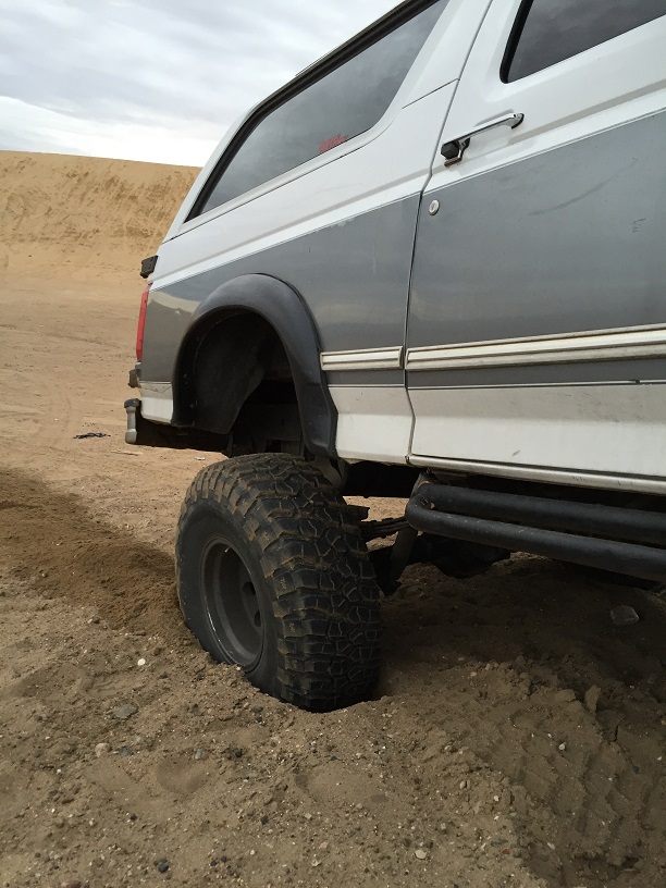

Baby flex with sway bar removed:
baby flex front sway bar removal

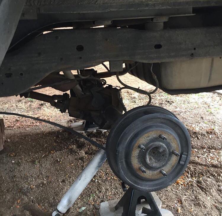

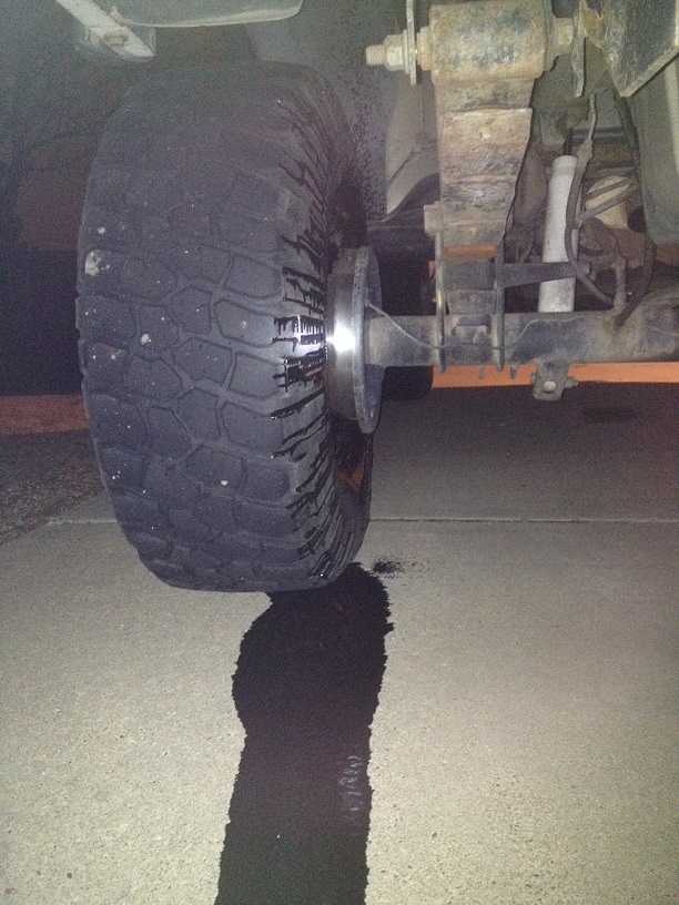

Rear axle C-clip broke and destroyed the entire rear end:
c-clip destruction
c-clip destruction

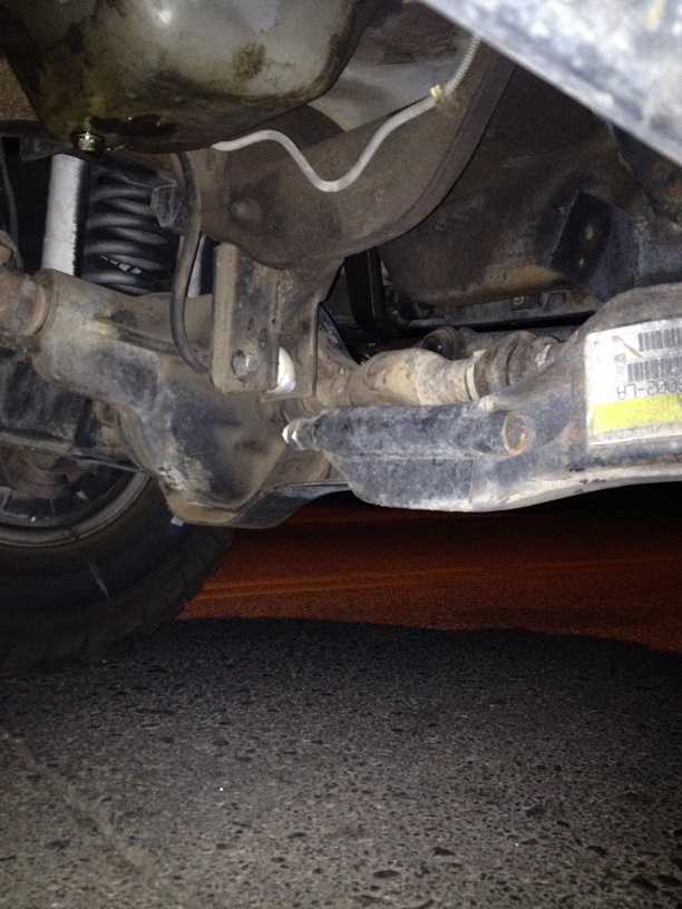

Few months later, front axle heim joint pivot broke:
heim joint pivot point

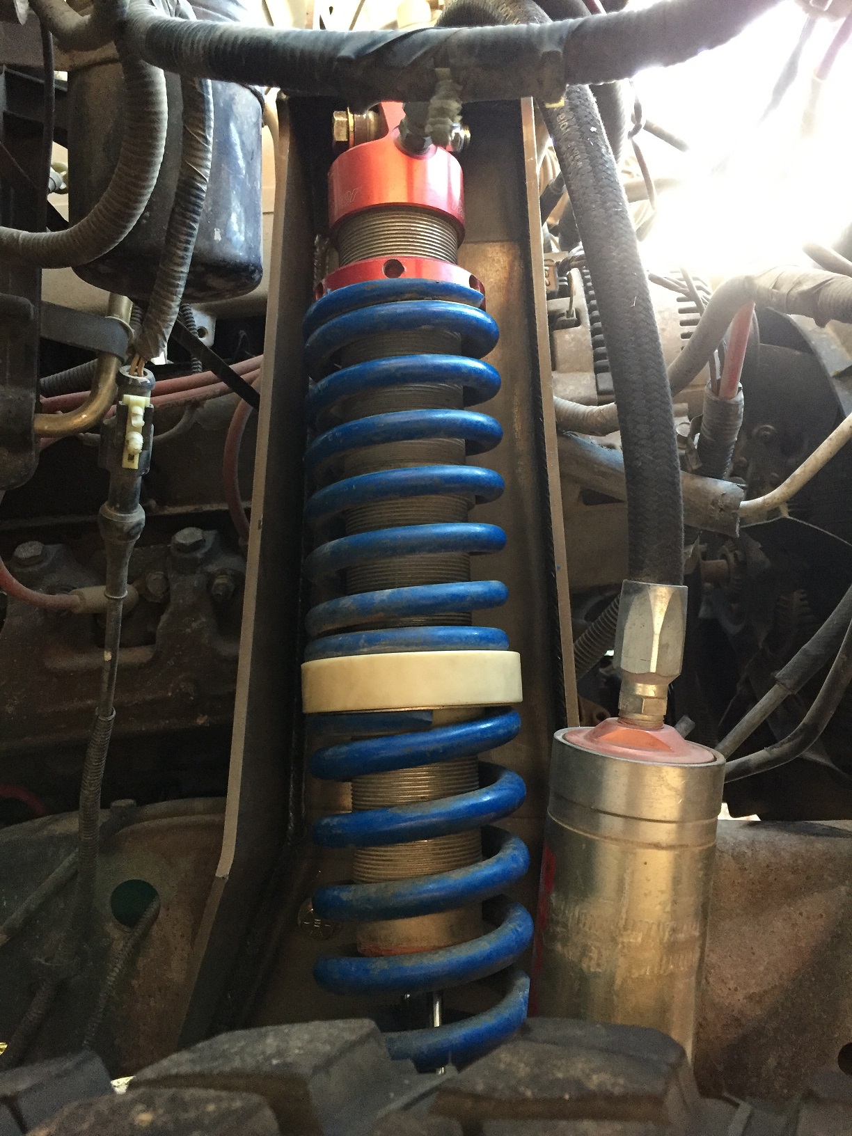

Well I picked these up a little earlier then expected! 2.5x12" Sway-Away coil overs running a 500/600 spring rate. I have no idea what the valving is, but it was valved for a V8 so it should work out great.
coil overs
coil overs
I have my mounts being made by Dave @ Threat Motorsports, which should be here in a few weeks. And, I managed to score some King 2.5x12" smoothies for the rear of the truck as well.
Hoping to have this all put together by end of November!

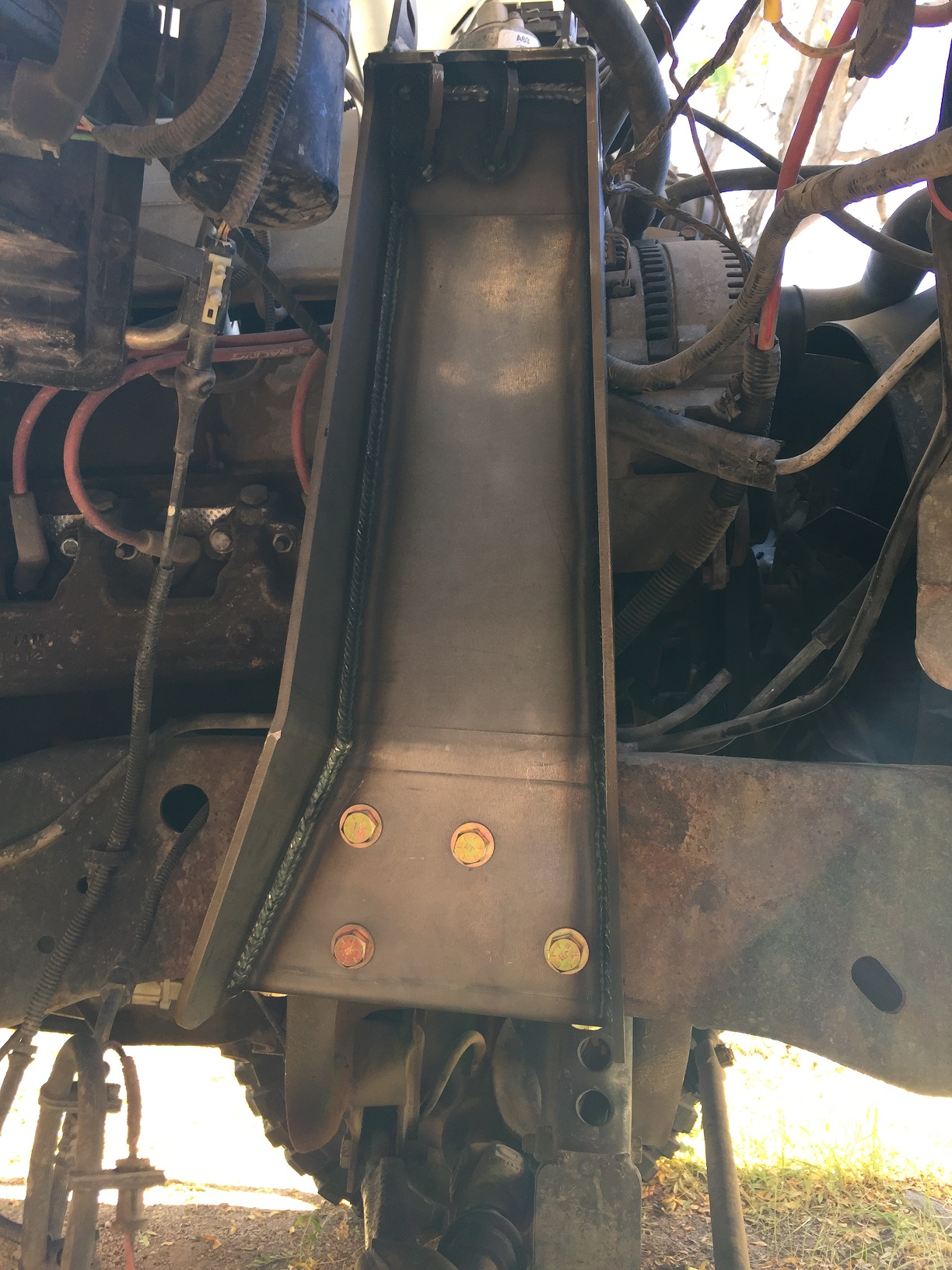

so Friday my coil over mounts came in from Dave @ Threat - love the way they turned out. Very clean and timely. I wanted to get started on Saturday but things came up which delayed my start until Sunday morning. They bolted straight up for the most part - although I had to ream a few holes. They were only off by maybe 1/8" or so.
Bucket mounted
Bucket mounted

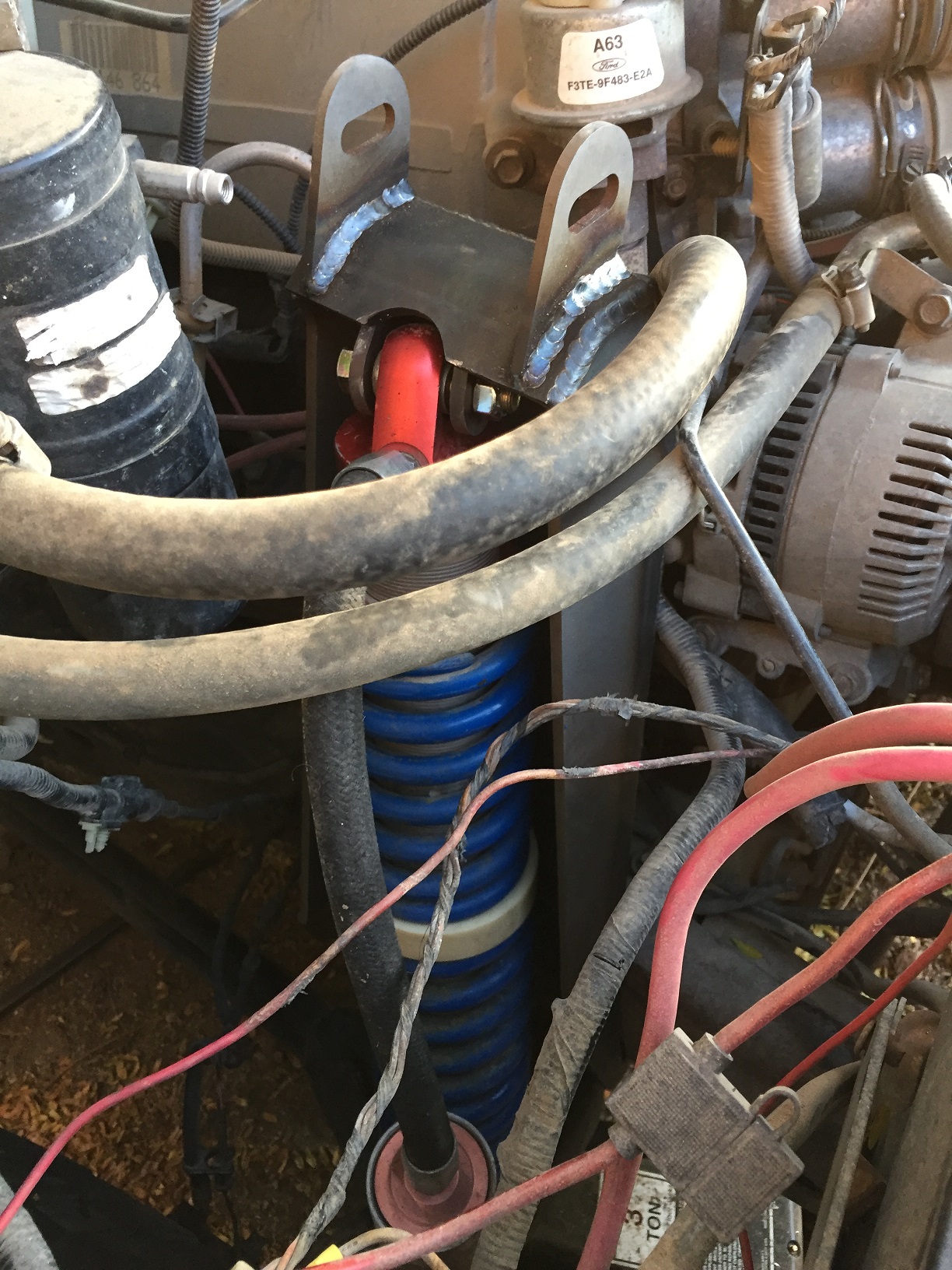

The mounts also cleared everything on the passenger side as well - there are a few hoses that need to be re-routed, but other then that it was solid.
top of bucket
top of bucket
I'm still amazed by the welds, probably because I am a horrible welder myself.
close up of bucket
close up of bucket

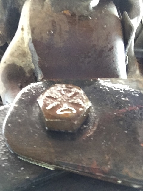

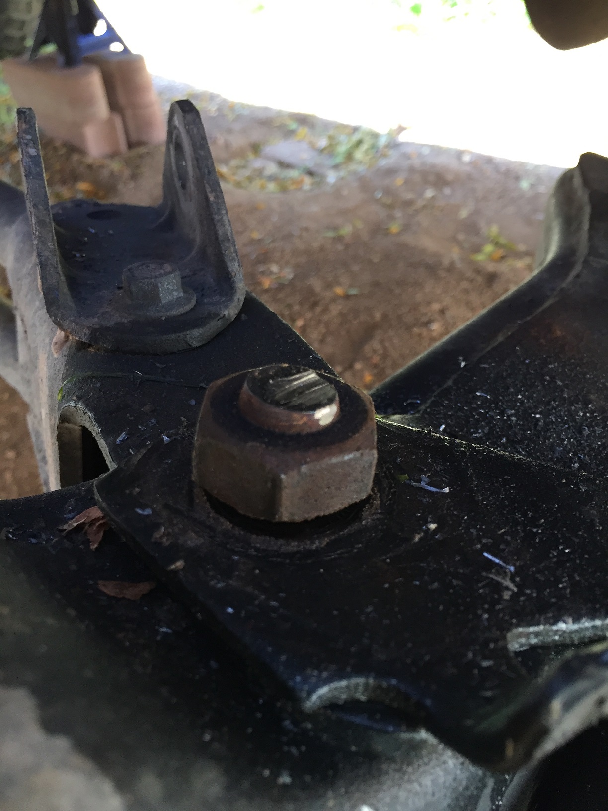

The bottom one on the other hand... was a hole different story. I had soaked it prior to starting with some penetrating oil and it still was not budging. I ended up having to use an 8ft pole as my cheater bar in order to get enough leverage so that it would finally break. Once I got it spinning, I could get it out with the impact no problem.
lower radius arm stud
I had removed the upper bolt to grind off some clean surfaces in order for clean contact with the welds. Upon putting that bolt in somehow the threads got nerfed at the beginning. So off to the hardware store so that I could get a tap and die set... best $70 bucks I have ever spent. It worked like a champ and the upper bolt began sliding back through no problem.

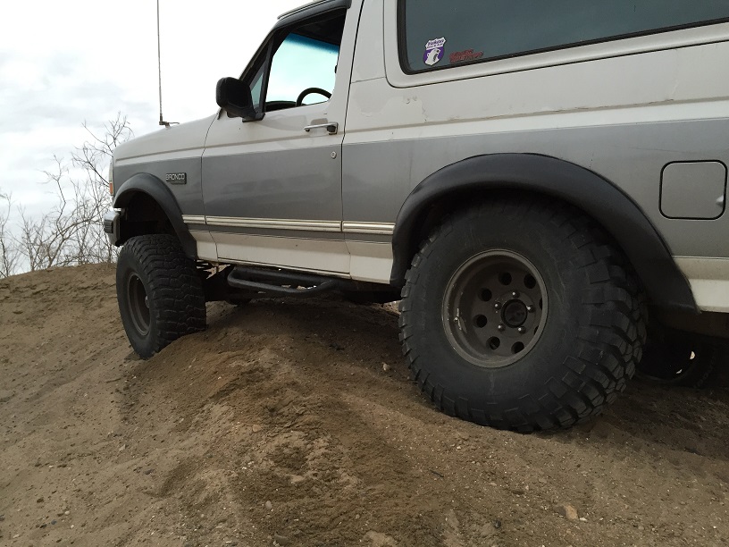

Well Sunday we had a local GoFast get together with some of the other prerunners in town - so it prompted me to get my butt moving on my driver side. Wednesday I started tearing down the driver side to get it prepped for the new bucket what not. Had everything off and bolted up in under an hour or so. Thursday I was able to finish up with the installation and clean up some things here and there. Friday evening I was ready to cycle the suspension and find my lower tab mounting locations - this is when I also came to the conclusion that my little welder does not like thick stuff. Luckily, my buddy brought his 220v and was able to help me out. Took about 45 minutes and the bronco finally had coil overs on it.
I buttoned everything up and began cutting the inner fender liner so I could retain a somewhat stock look. Driver side was complete.
On the passenger side there is a hose that runs to the top of the water pump and up into the firewall - it also has a little cap that you can turn (not sure what it is), but it was being crushed by the bucket so I tried to bend it up and out of the way. I ended up putting a hole in the tube and anti-freeze began dripping out, wonderful! After cutting the old section off and sliding the hose back on, I got it seated on there. Sunday was a good shake down, the truck felt good. That same coolant hose broke again, no idea why. I had to drive it to O'Reillys with coolant pouring out of the truck in order to get a replacement hose. After about 45 minutes I was able to get it to stop and finally hold. Back to the trail!
Had some good tests and shakedown runs, I am very pleased with how the truck handled. One concern though is I have a huge camber problem. If you read my posts in some of the other boards, camber and my truck just do not get along and I have no idea why.
I set my preload initially at 3/4" on both sides. The driver side had about a -2* camber angle roughly and the passenger side sat at about -5*. I had an alignment done on the truck before the coilovers and I was sitting at -2 & -3*. I tightened up my preload a little bit more pushing it to roughly 1"-1-1/8" and I am sitting still at around -1 on the driver side, and about -2 on the passenger.
Any ideas on what I need to adjust or how much more preload I need? The spring rates are 500/600.

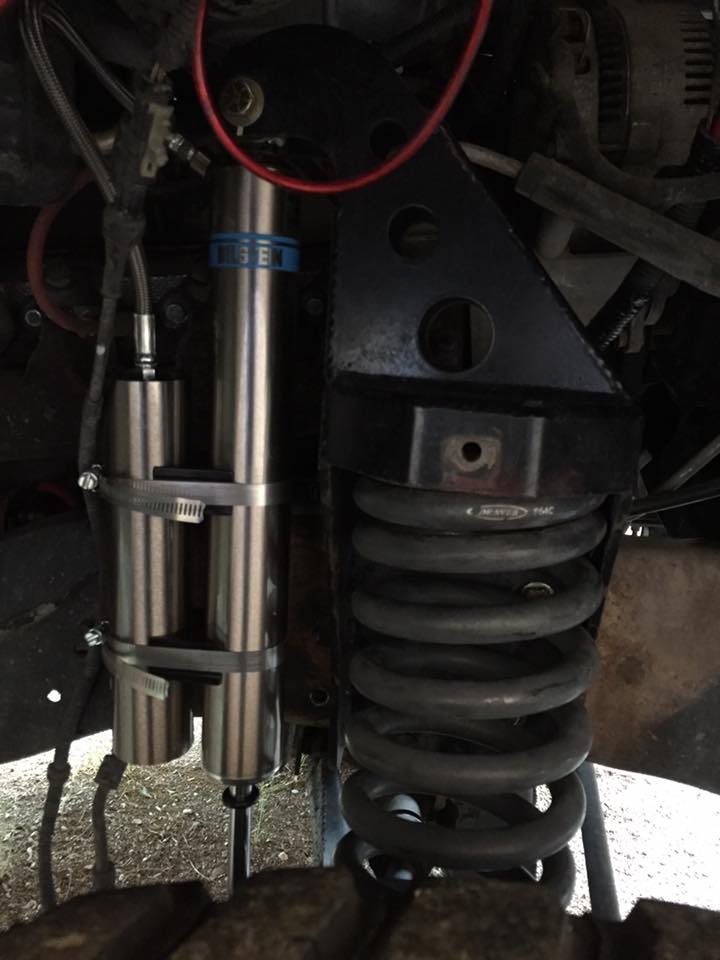

Well I wasn't able to get a whole lot of pictures, but I did manage to snap one of the driver side completely done. I really liked the way the inner fender liner structure came out - almost gives it that stock look.
