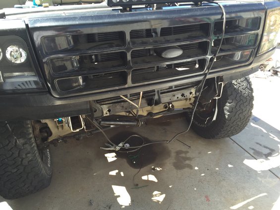

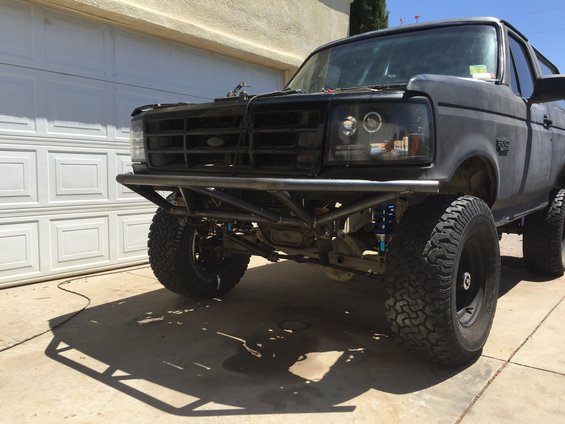

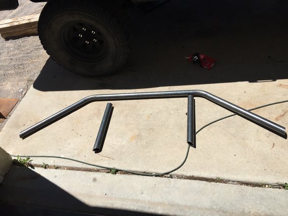

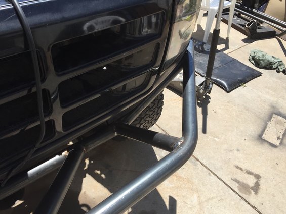

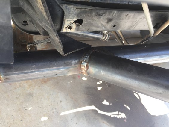

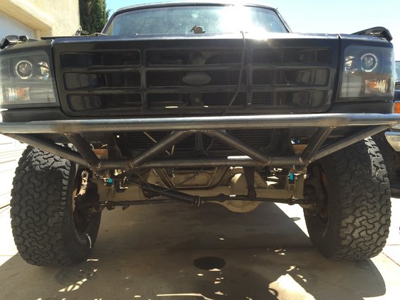

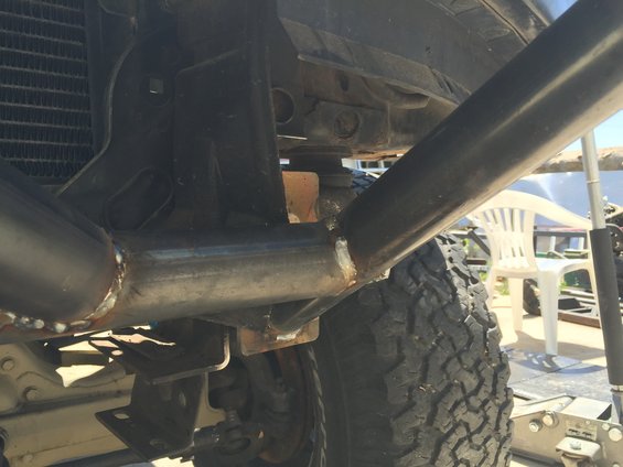

The last 2 days I worked on the front bumper.
Here is what I came up with, it still needs some work and more support.
I wish I could say my welds are A+ quality. They look like a drunken sailor with bad eyesight and a shaky hand did them at times. Better than the pidgeon shit sculptures I used to make, but I have a long way to go.

I am with Tchajagos on this one. Looks cool, but it does not protect much down under it. This is the last one I built for a friend from a bunch of left over tubing from a couple cage projects. This is a Chevy bumper but the skid plate tubes going down protect the bottom of the radiator and on a Bronco those tubes with a cross tube between the frame rails helps protect other steering components from a direct hit.

Yeah for sure, i definitely have more work to do on it.

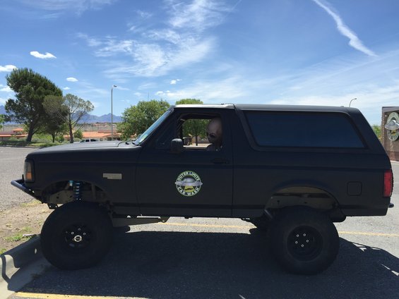

And here is Bob the alien driving the beast to work.
