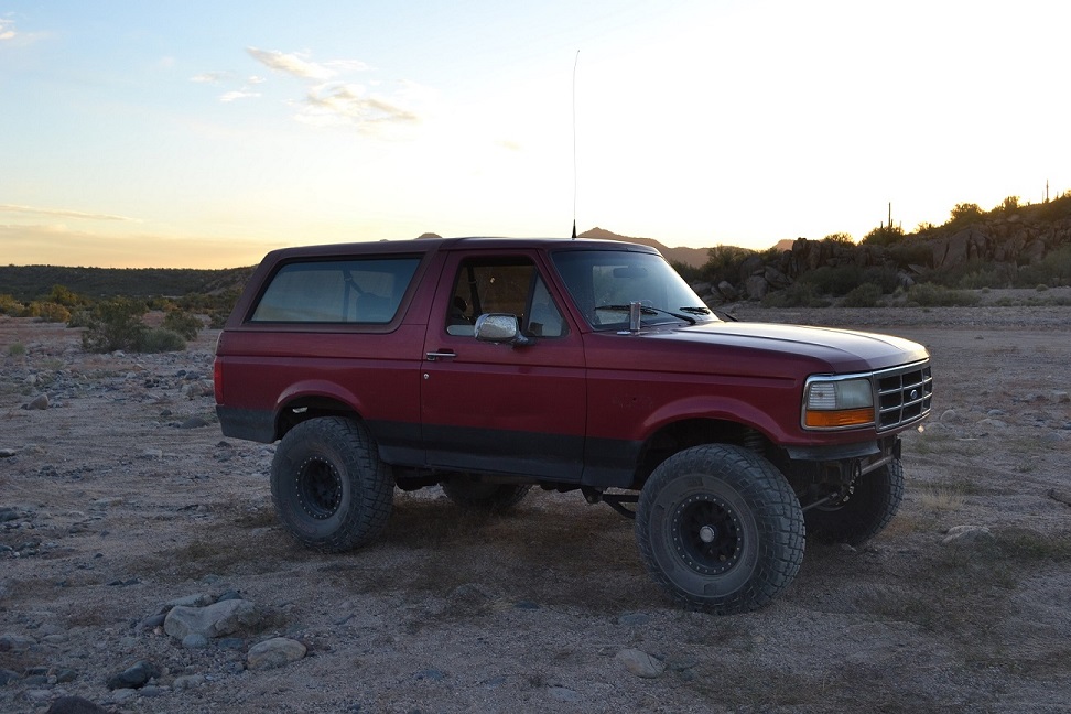

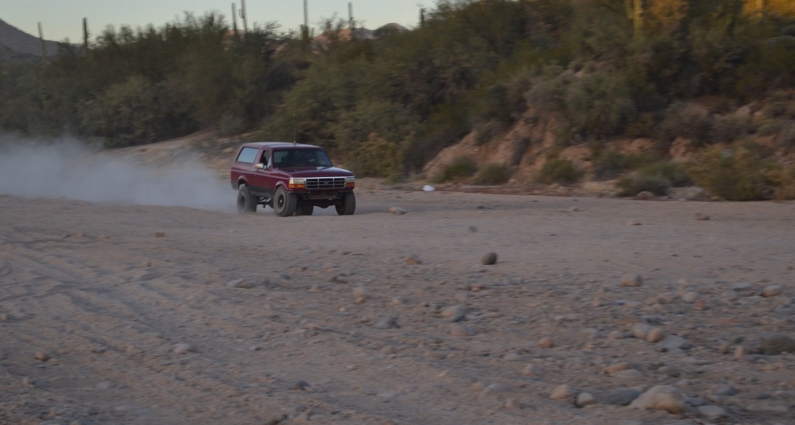

Some shots from yesterday. Had a quick test session for one of the shop Raptors that is getting picked up, so I brought out Añejo for moral support, and the tools that were still packed in her from Mexico.
- sideSmall.jpg (222.32 KiB) Viewed 1975 times
- bump.jpg (215.11 KiB) Viewed 1975 times
- atspeed.jpg (295.15 KiB) Viewed 1975 times

Sikkkamore?
- Posts: 444
- Location: Prescott, AZ
Re: Baja 1000 bound - Anejo
Really cool shots!!!

RyanDS650X wrote:Sikkkamore?
Yup
