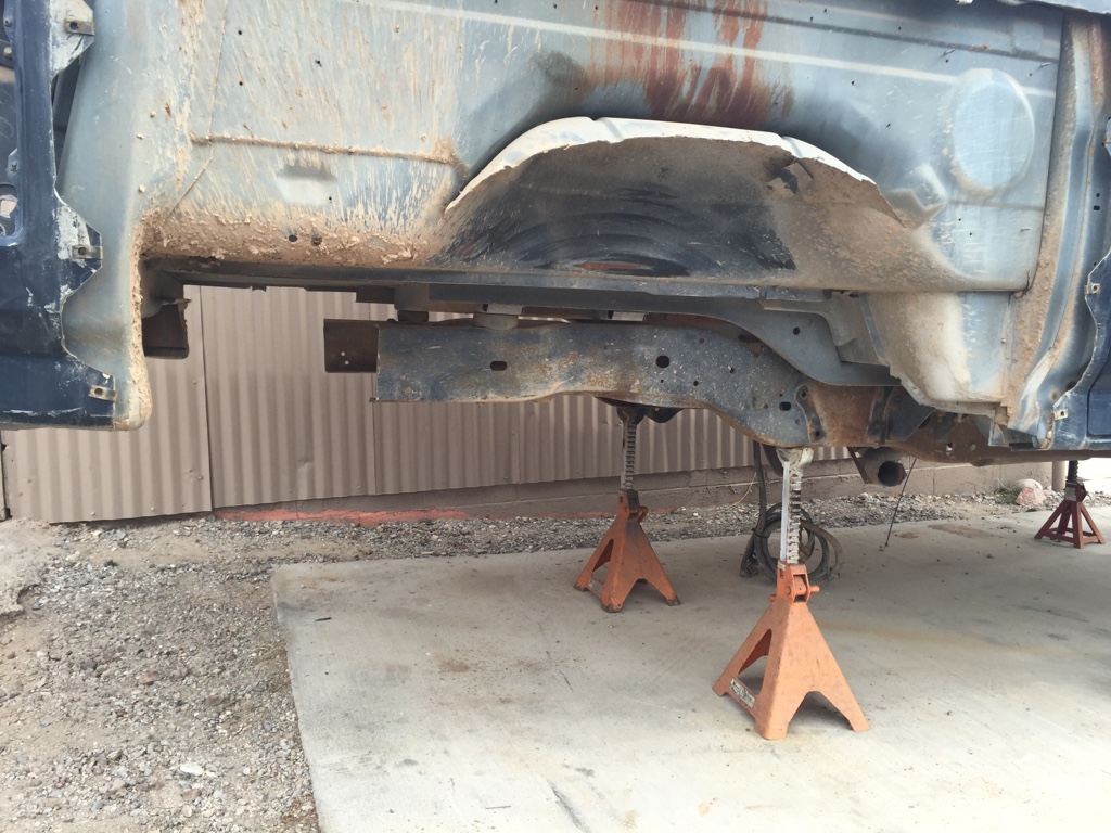

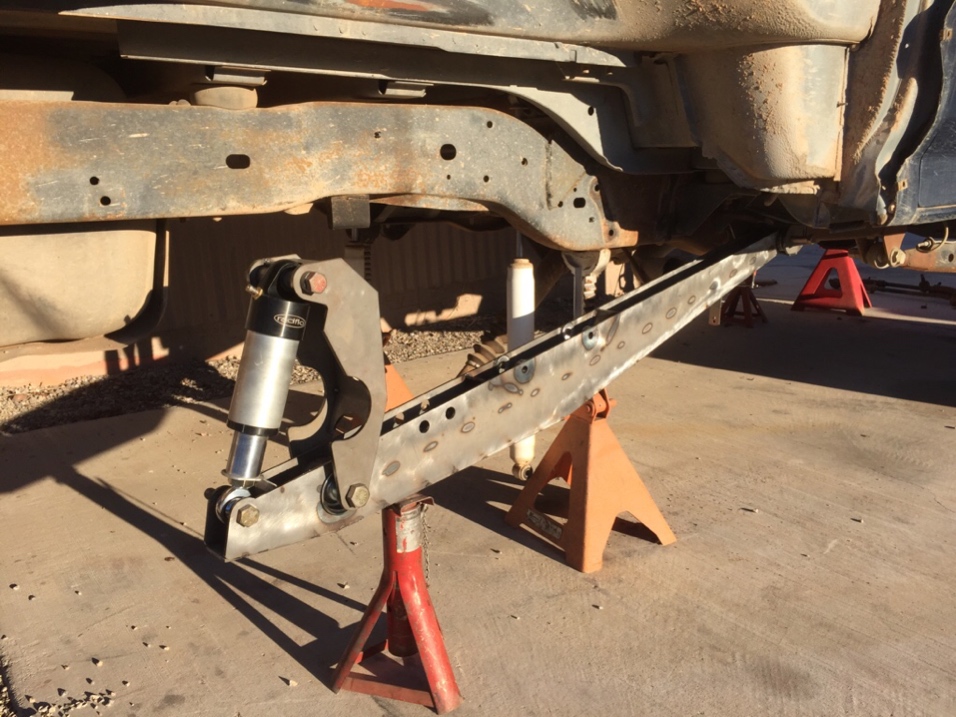

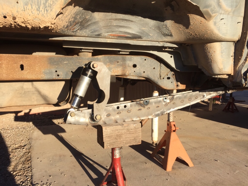

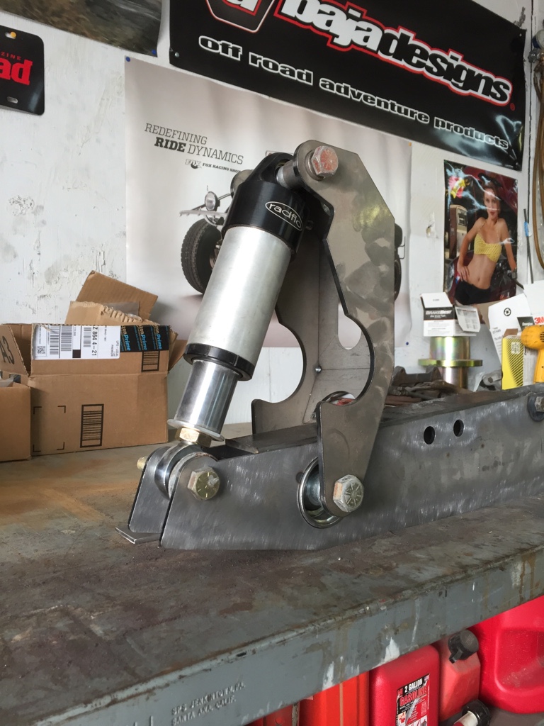

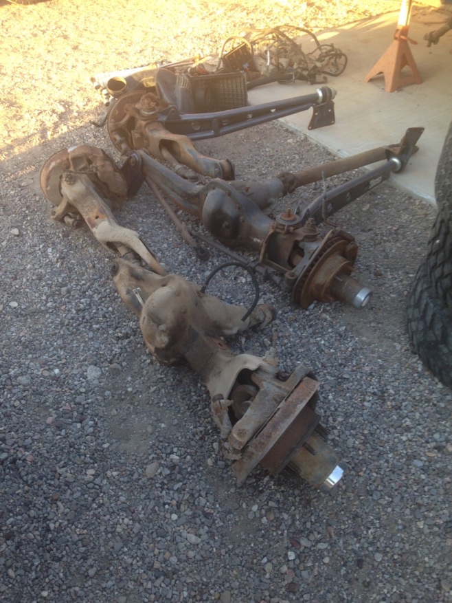

I scored two bolt on diffs, one to put in the Bronco and another as a spare. My jig parts for the rear end are all machined up. Started welding the link parts together. Next on the list is fuel tank and crossmember removal & start cutting holes in the body.

Judging by the pics looks like about a 8-10 stretch? What's the plan for glass? That is the one thing I regret, not biting the bullet on a stretch.
Re: Philo's 93 Bronco aka "Lucky Bronco #3"
I was guessing 4-6"....
I'm gonna go with 7"

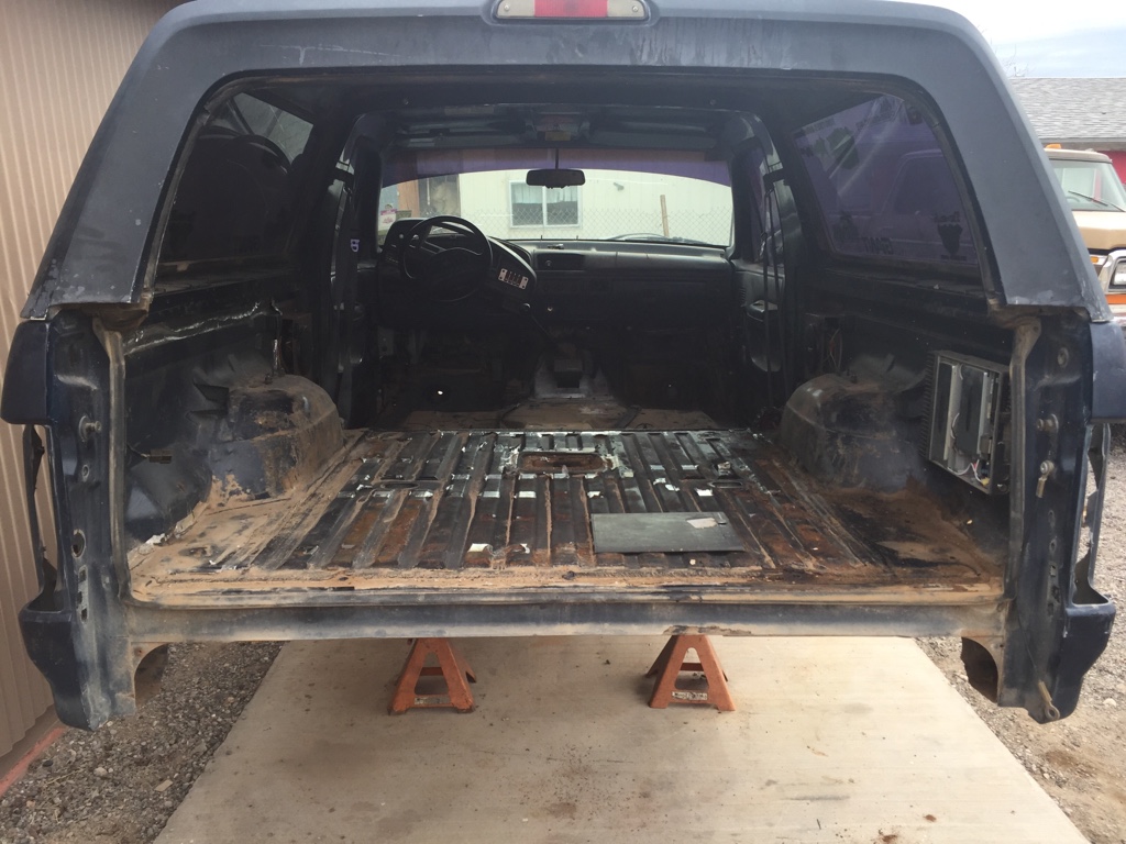

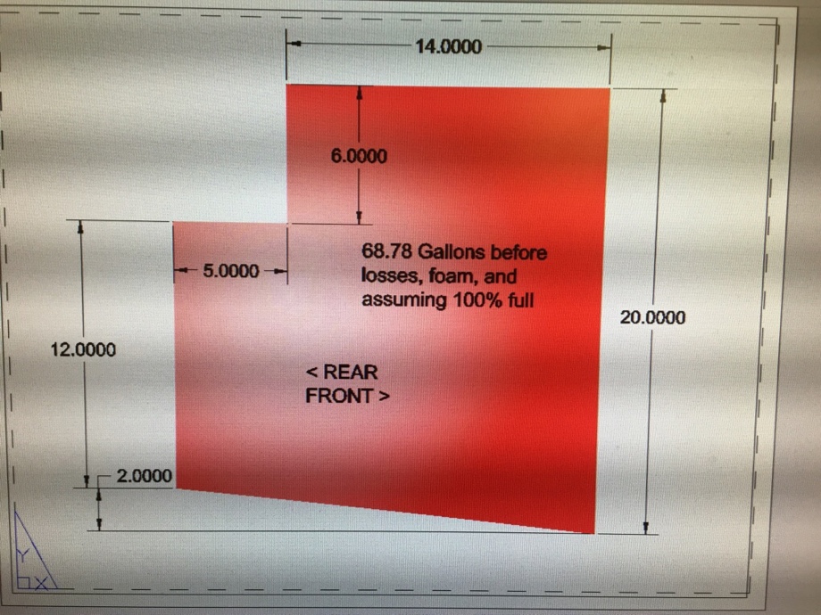

Pulled the fuel tank, removed the fuel lines and vents, gutted the interior, cut part of the frame off to fit a fuel cell, and drew up a quick fuel cell design. Gotta call Harmon tomorrow to get the cell going. Should be 55-60 useable gallons when done.
Looks like there will be room for two buckets in the rear, two 37" spares, and 38 x 24 for cargo. It's going to be cozy.
I still need to cut the rear crossmember out after I build something to hold the frame in place. Sheetmetal work should be simple. Going to Rhino line or Linex the back after sheetmetal to keep it quiet and easy to clean.

With all this work, how come the daily driver link setup instead of a 4 link?
Phoenix0783 wrote:With all this work, how come the daily driver link setup instead of a 4 link?
Geoff is a friend of mine and I wanted to prove the product can work just fine. Took way to long for me to do, as a bunch of trucks have these setups and work. There is some packaging issues with the upper link if I went with a traditional 4 link too.
There really isn't much more work this way.
