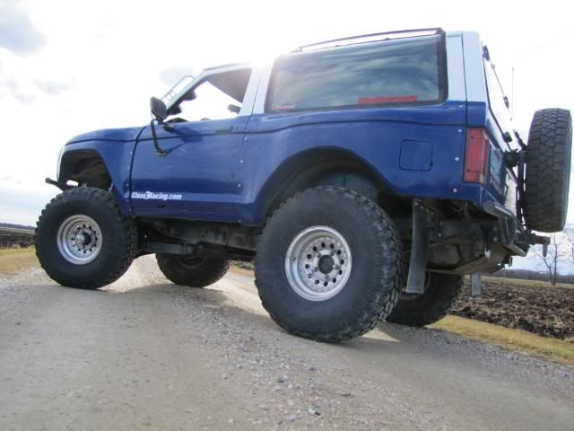

Truck is a 1987 BroncoII 4x4.
Engine is a 1991 4.0L out of a Ranger. 95TM ported heads with modified TB and headers, Electric fan, 130 Amp alternator, and dual batteries. M5OD-R1 five speed transmission with a manually shifted 1354 T-case.
Front axle is a plated, trussed D35 with D44 outers. 4.10 gears. Rear axle is a 1990 ranger 8.8 W/Explorer disc brakes packed with 4.10 gears and welded diff.
Lift is a mix of custom parts 3.5" suspension and 1" body. Extended rad arms. Coils are 5.5" Early Bronco Coils with an F150 coil bucket and extended shock mounts. Rear is a combo of custom parts. Durango Leaf springs, with a shackle flip using a custom 2" drop shackle bracket w/stock shackle. Rancho RS9000XL's all around. Quads on the front and a pair out back.
Body enhancements are Round light conversion, with LED markers. Custom built Fiberglass quarter panels, front and rear. Custom built bumpers and modified tire rack.
Wheels and tires are an OutlawII style wheel with 35x12.5-15 ProComp Mud tires.

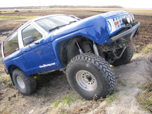

One action shot for good measure.
1987 BroncoII 4x4

Thanks guys. It's sure changed since I first had it built. It's going to be changing a bit more again in the near furture. Exterior mods are about finished. Just thinking of making a fiberglass hood skin and maybe some door skins.

Thanks Brian, ya there is a short blerp there about the custom fiberglass quarter panels. There will be more custom fiberglass parts to come.

It's a modified Stock grill. I removed the oval badge from the drivers side and made fiberglass fillers for the lights.
I lucked out with the LED markers and found some that fit the grill openings perfect.
I try to make things look as stock as I can get. So far it's messed with the heads of many.
