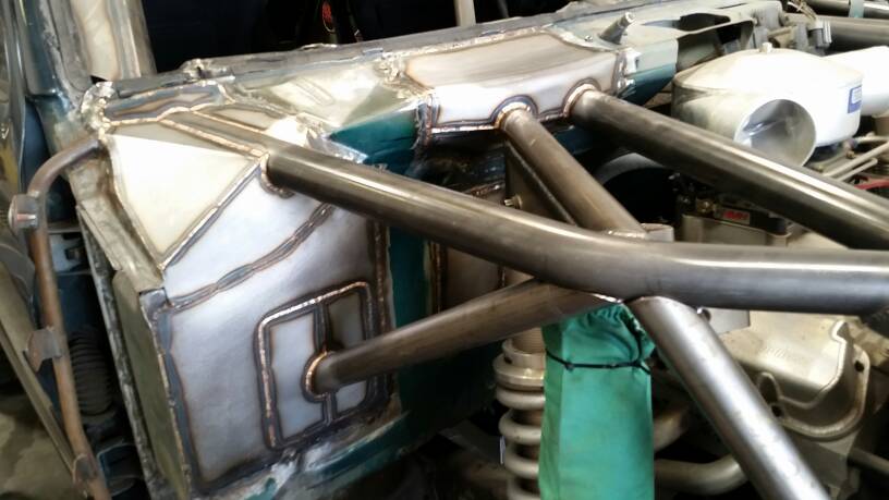

ChaseTruck754 wrote:Lookin good. Man I don't miss patching up factory sheet metal like that. Maybe it's just me, but the Si Bronze rod just seems to fall on there & lump a bit, plus there always seemed to be some glue or paint I couldn't get to on the factory metal that made the stuff pop & just be a crappy experience all together.
Your not alone there. There's nothing more I hate than the smell of burning factory glue, and the all to familiar pop. Maybe cho has a secret stratagy but I can't stand that stuff. However you pulled it off cho it looks great.

Thanks guys, patching sheet metal definitely is not one of my favorite things to do. The key with si bronze is to make sure the material is clean and well prepped. For sure my rod of choice for most thin sheet metal work. It welds really fast due to its low melting point which prevents warping and blowing holes in the material, it also is soft so it will flex without cracking.

A pic from this am [attachment=-1]uploadfromtaptalk1402025698312.jpg[/attachment]

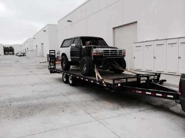

Here's a quick picture I took of Scott's Bronco all loaded up and headed to CRB. I can't wait to see what Curt comes up with!

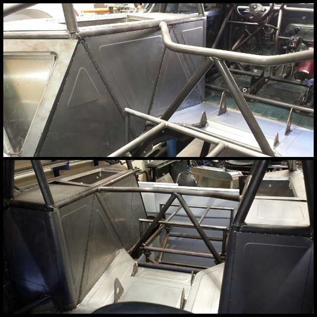

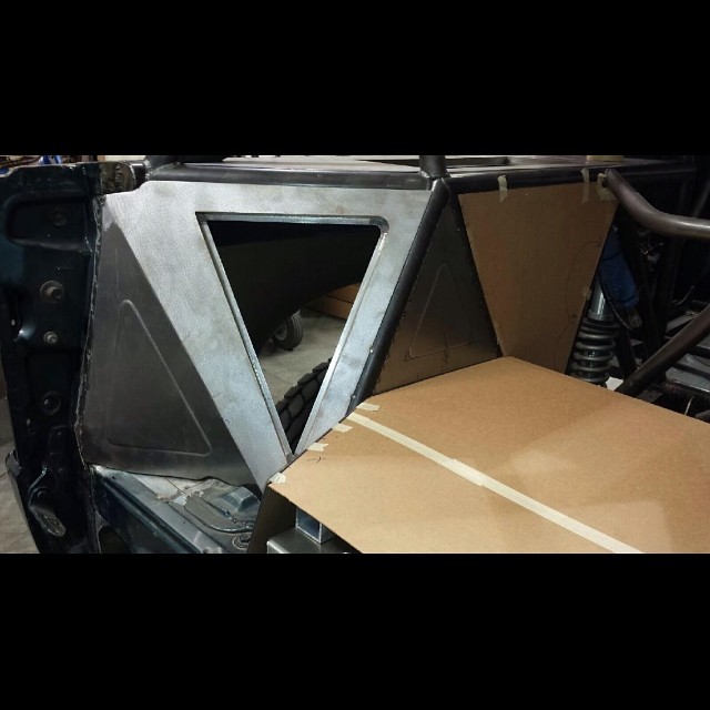

Some progress CRB Curt made on the rear so far. That opening will have a door with flush mount latches and a storage compartment behind it for a tow strap, etc. I'll have that on both sides. Can't wait to see how it all turns out.
