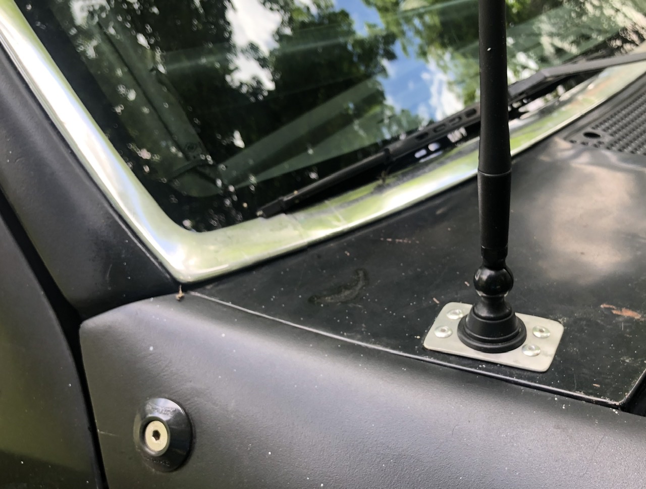

I’d cut out a rectangular plate of .0625 aluminum, round the corners smooth and rivetit right over the hole. Brush the aluminum with a scotch brite pad and it’ll look rad. That’s what I did as a base plate for my non-oem antenna.
Re: Antenna Delete Ideas
https://www.ruggedradios.com/index.php? ... ts_id=2923
Can be used for a UHF antenna, too. I put a little stubby antenna on there... looks cool and fills the hole.

Post by sydude »
Quick and easy!
