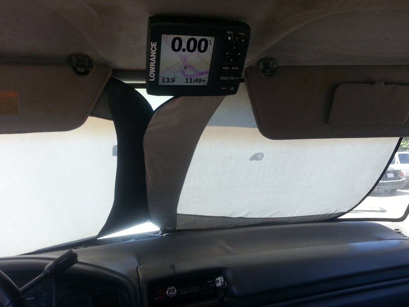

No pictures but mine is mounted above where the rear view mirror is. Great visability but pushing buttons on anything but smooth road or standing still is out of the question. When playing with different features my arms get real heavy too.
I'll try and snap a picture at lunch today.

Little smaller than what your running but heres mine

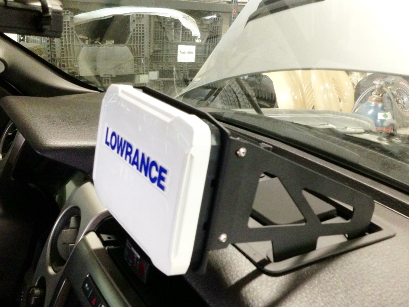

I saw a raptor today with a really nice dash mounting bracket. It brought the unit a little further out than the lowrance bracket. I never ran a big screen unit like some of you, I had mine mounted on the dash, I like having it in my line of sight.
Re: Lowrance HDS-8 mounting location?
Here it is Image
Let's try again...
