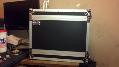

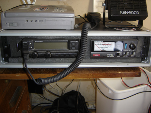

PaulW wrote:David nice work.
Can you give us the details?
I put these pit box radios together for guys that do remote pits. A few years back I was doing a pit for JCR Team Honda down
past LA Bay for the 1000 and Honda gave us a pit radio that had been screwed to a piece of plywood. After a 50 miles on a ruff dirt road the radio was beat to death. It was in our pit captains truck, so not my fault. Fortunately I pulled out my 110 watt kenwood from my truck that worked great. We got lucky and got it all up and working about 10 minutes before our 1X bike and the helicopter. We did a 17 second fuel, water and bike check, then our guy was off to take 1st place.
After that race I started thinking of a better way to setup pit radios. I have been a sound engineer for 26 years and what came to mind was the equipment flight cases we use to transport rack mount sound gear. I picked up a rack mount shelf and mounted the radio and a antenna tuner to the rack shelf and put that in the flight case. Then what I did is mount a external speaker in the back cover. For power I picked up a 50ft, 10g extension cord like you use in the garage. I cut the 110v plugs off and combined the white and black wires to make it a 5g wire and used the green for ground. Then I put a Anderson winch plug on my F350 in front and rear, along with one on the extension cord to give me a direct connection to the batteries in the truck. At night we put the truck battery charger on the generator along with our light. Great setup
I have now made 11 of these pit box setups with a Kenwood 110 watt radios for teams.
If you have to haul a pit to a remote area, this is a great way to do it.
