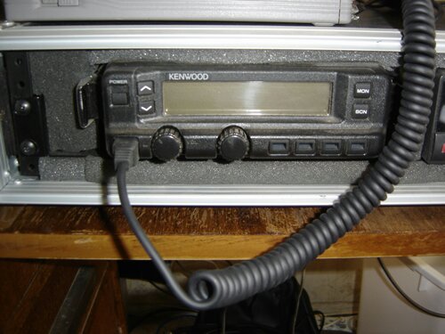

Here are some pictures of the pit boxes I have built for several teams.

I like!

David nice work.
Can you give us the details?
