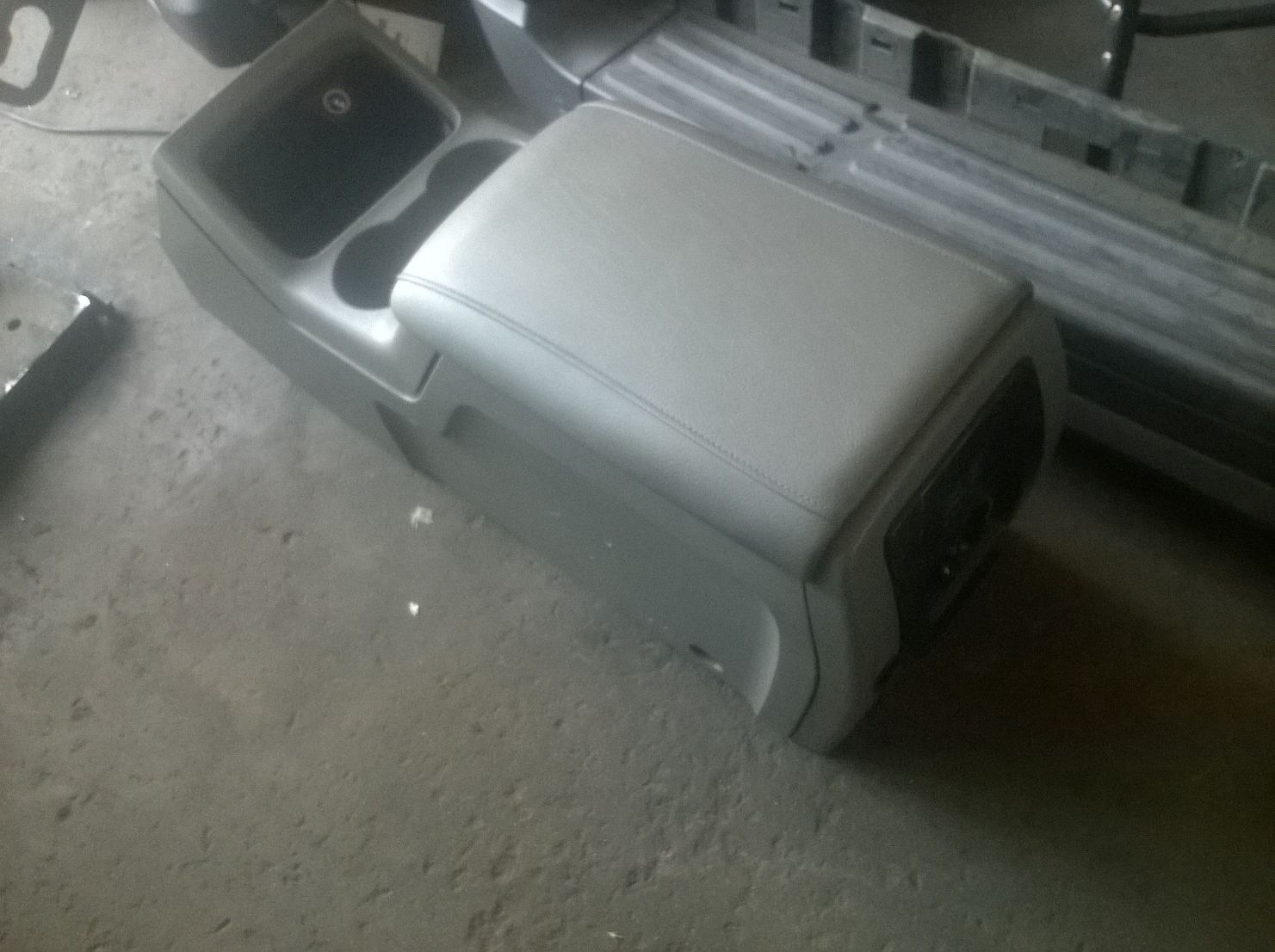

tcm glx wrote:Expedition Center Console:
[img]http://i137.photobucket.com/albums/q207 ... 7a06f0.jpg[/img
Who's rig is this with the Expedition center console? Can someone tell me the year(s) this model comes out of? I may attempt this while the Bronco is in rehab right now.

Re: Lowrance HDS-8 mounting location?
That would be mine..........console is out of 2004-2008 expedition.

Thanks for the link Tony.....my Cousin lives in Riverside and grabbed it for me today:
Expedition console.jpg (176.62 KiB) Viewed 34824 times
Fantastic!! You will like it.

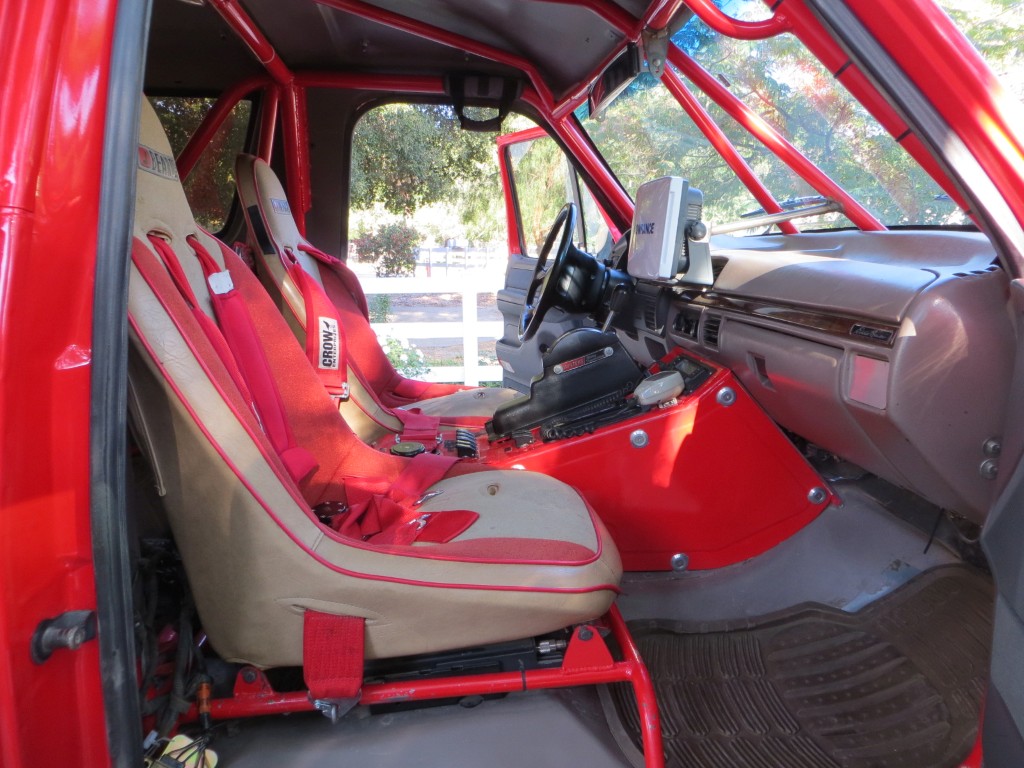

I have an HDS 7 on the dash with the stock mount, Works well.
The Rapturd mounts are OK. I have one cheap if somebody wants one

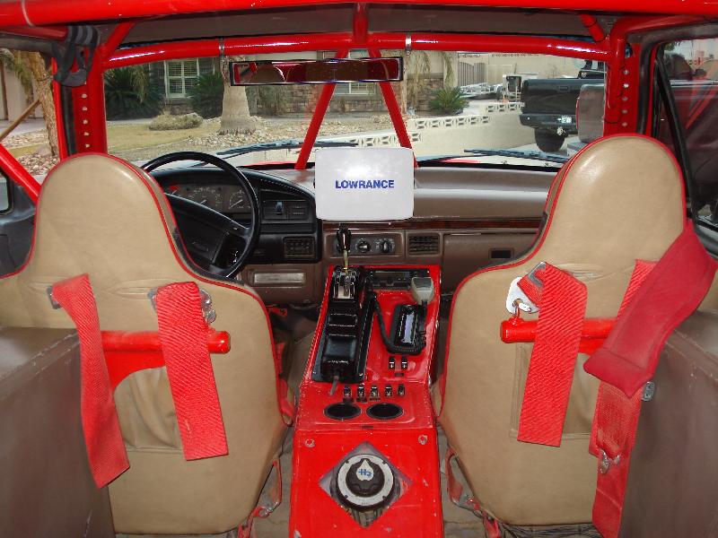

Nick wrote:Let's try again...
You have a winner there. To be useful and actually use it, you have to be able to see it and be able to reach it.
Post by PaulW »
The one above sure looks nice. I doubt if it will work for my use in Baja because if the cantilever and excess vibration. However the cantilever sure would make it more user friendly as far as reach from the drivers seat. A strong reinforcement under the flimsy dash is definitely required to minimize the issue. Many of the cool mounts are only suitable for the Mall and undesirable in the desert.
My 7" units present location is now pushed forward to be flush with the radio and I have now reinforcement top and bottom of the dash. Both the reinforcements are shaped 3/8" plywood and the wood is stiffer than the several throwaway aluminum versions that I have tried. The main issue with the wood is to hide the top one to make it look ok. I do not have the desired window cage Vees which I would have preferred for the mount.
