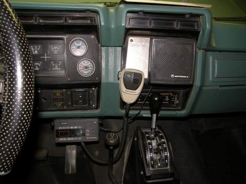

Yeah, the Maratrac has two major components, the transmitter/reciever and the control head. There are three secondary components, the umbilical connector cable, the mic and the speaker. In order to program them, you need an antiquated computer, a 286 or 386, motorola dos driven software and a programming cable. A good friend has the computer, cable and software and we program them here. They can't be programmed on the fly. But again, I've not really needed to.tcm glx wrote:hey Tom,
Those Motorola Maratracs..... i just popped on ebay and saw them. They look super affordable, how do you control the channel? Is it a base unti for power, then external mic, and external display for the frequency? I ask because I currently have a Kenwood tm-271, but I am looking to add a second radio.
The control head changes the channels, volume scan etc. It doesn't have an external squelch, it's controlled by the internal computer... works well.
I mounted the t/r on the rear of the cab, behind the passengers seat and the control head is mounted under the dash on the driver's side. I mounted the speaker and the mic on the center of the dash for easy reach and audio. The darn thing has like a 35Watt power source for the speaker and it's LOUD! So, trackside, I just turn it up and I can hear it pretty much anywhere in camp.
- Maratrac control head, mic and speaker
