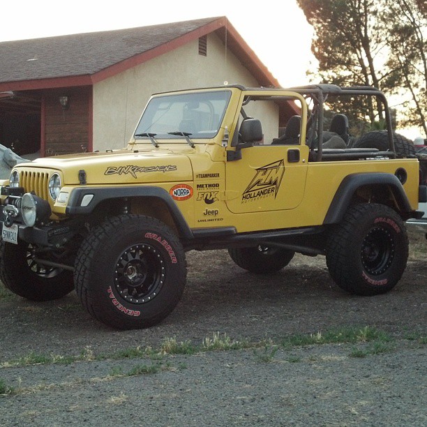

My old jeep had it mounted off the windshield frame and it worked great. It did not mess with my view at all cause of the placement it was pretty much hidden behind the frame on the drivers side.
Hey Brandon, do you have any details on that antenna mount... I'm going to be radio shopping here soon as well

It was just something fabbed up real quick. Piece of aluminum angle trimmed to fit. Pretty simple tab but make sure it clears the door and spaces off enough to buy you some clearance for the antenna. If you want and there is a demand you think down the road we can CAD something up so you can laser and sell through Craven MS. Pretty easy part.
Maybe Brandon...most of the JK guys run an antenna mount off the tailgate, but they just run cb antennas...
