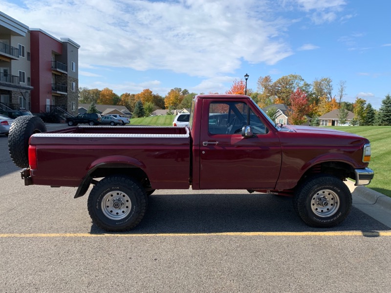

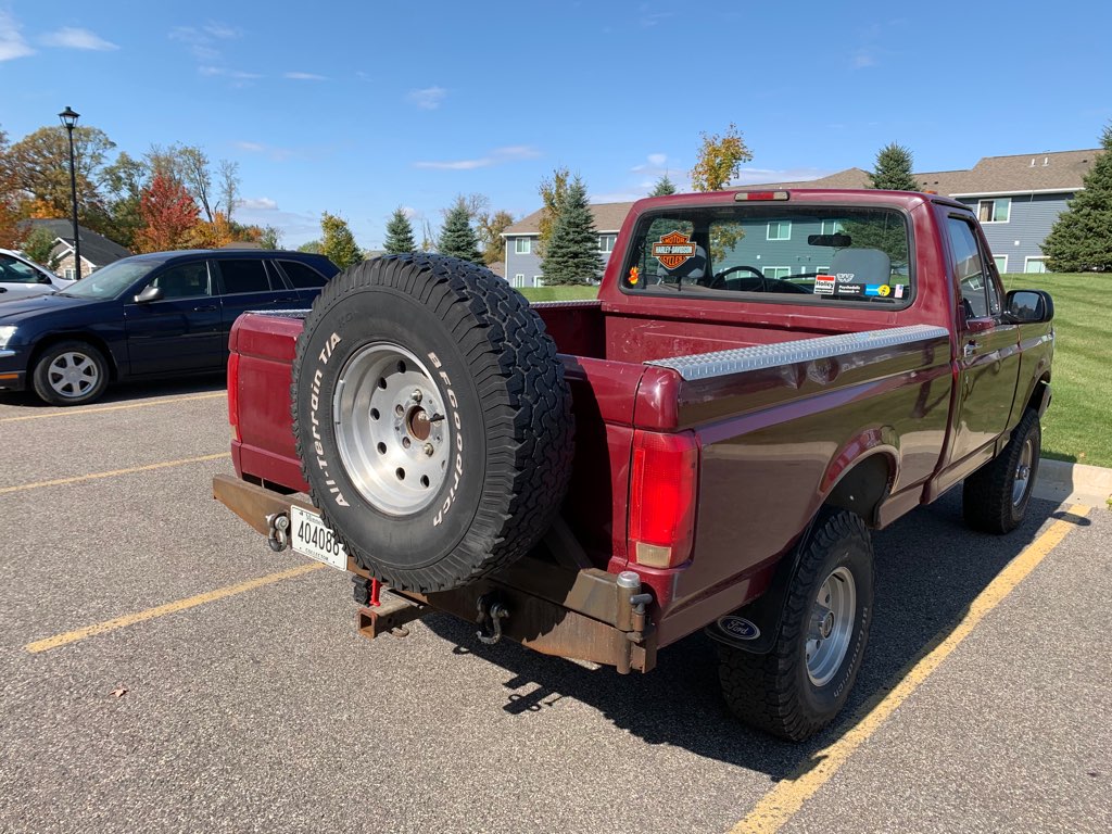

Just picked up this 1992 F150 5 speed on a trade for an old Harley (I definitely came out ahead on the deal!)
Its a regular cab short box. 4wd with a rancho 4" lift.
It has a mildly built 302:
Holley Systemax 2 with aluminum heads
70mm throttle body
Ford racing roller rockers
Lunati Cam
Hedman Headers & Holley aero chamber mufflers
Also has 4:10 gears front and rear with lockers
Can anyone tell me the best route to follow to put long travel suspension on this truck, given that it already has the rancho 4"? Anything special i need to take into consideration there? I was thinking the autofab long travel kit, but again, i don't know if the lift kit will affect anything.
Thanks for any info!
-Jeremy
