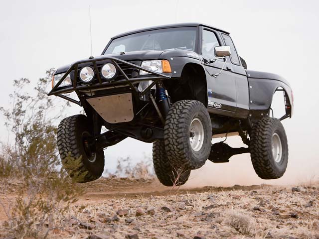

If you stay with the stock width D35, don't waste your money on adding heims to those radius arms. You won't get any seat of the pants performance increase and no difference in wheel travel.
Pete Albano's Ranger is stupid-fast on a stock width D28, bushing radius arms and coil-overs.
