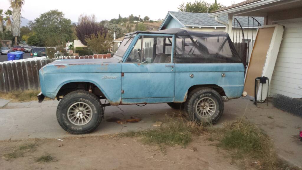

Hey all, my name is Tim and I have a 1966 Bronco. I'm different from most people that you encounter and always have been, but I'm ok with that: I started with a 3.3L Inline 6 and replaced it with a 4.1L Inline 6; next is going to be a Dana 30 SA out and Dana 50 TTB in; finally, equal length swingset steering and watt link rear. I think TTBs are underrated because they're not the status quo and even more so frowned upon in an Early Bronco because they couldn't be further from the norm. I'm on fordsixforum.com (all I6'ers) and classicbroncos.com (all EB's) and I joined this forum because I wanted information from the experts here: all of you. The intent of my build is two-fold, first and foremost: not to be the baddest rock crawler (my primary area of interest) nor the fastest desert racer, but to be able to go anywhere and have fun doing it; secondly and just as important: to have a one-off vehicle that challenges conventional practice and thought. I look forward to sharing here with you at Go Fast Broncos...
