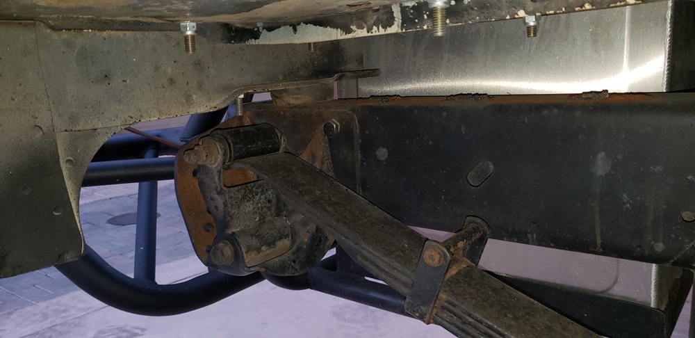

Looks like it will be a cool rig Capt. More here can better share leaf experience than I, but since the rear susp is clear in your pics I'll give it a try. From the condition of the undercarriage it looks like someone has been racing the beach!
Not sure about the ride height you describe, but your rig shouldn't look like it has a "lift kit" for sure. Those leaves look like they could hold up my F350, and the bumps are very close at static. And the shock shafts look a bit stubby like the bodies are a weence too long...... Funny position on that axle you'll have to renovate for sure.
Again not a leaf guy, but those I know and those I've seen run very hard and very smooth on leafs and matching components that are well beyond proven. Set aside the dollars required to do so, Desolate et al can sell you a weekend's worth of parts that will fix that rearend forever.
For sure Geoff has some valid magic.....I'm just not sure anything "Killer" is necessary.

if it was mine, id start with the following
- pull springs off coil overs, break down rear leaf pack and set it at bump, check to see if im leaving travel on the table. if so redo shock mounts
- it appears the rear shackle is stock and may be limiting travel
- get a 3.0 bypass in the back mounted outside the frame rails
- id move the air bump to the inside of the frame
Re: 1450 Bronco: Redo
Like you suspect & has already been noted, I'd change up the rear shock setup too. For the front end bumping metal (beam) to metal (frame) can be tough do to binding in the joints, etc. For the rear you should be able to swing it, although the link killer leafs may help in that endeavor.
The shocks would be better as far outboard as you can get them. Should be able to get them outside of the frame fairly easily with what all you talk about redoing back there.

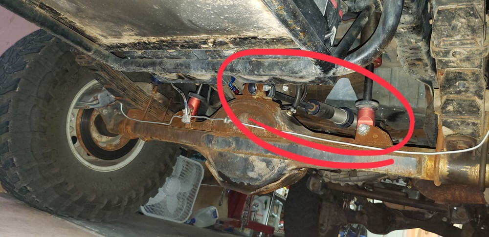

Becks_Bronco
Posts: 1275
Location: Antioch
Post by Becks_Bronco »
What’s happening here?
Very interesting build for sure.
Capt_Mike
Posts: 8
Joined: Tue Jun 18, 2019 6:11 pm
Bronco Info: 86 Bronco 1450 all glass, 393 Stroker C6, 35spline 9" full floater, dana44 cut n turn, 35', 5.21
Post by Capt_Mike »
Haha! That had me stumped too. Its an old school axle anti-wrap device. The idea is that it can extend and compress with travel yet still prevent wrap. I'm going to put a go-pro down there to see if it works. It seem that tabs should be longer to give it more torsional leverage on the axle. I don't know if its better than a two link? Do they work?
