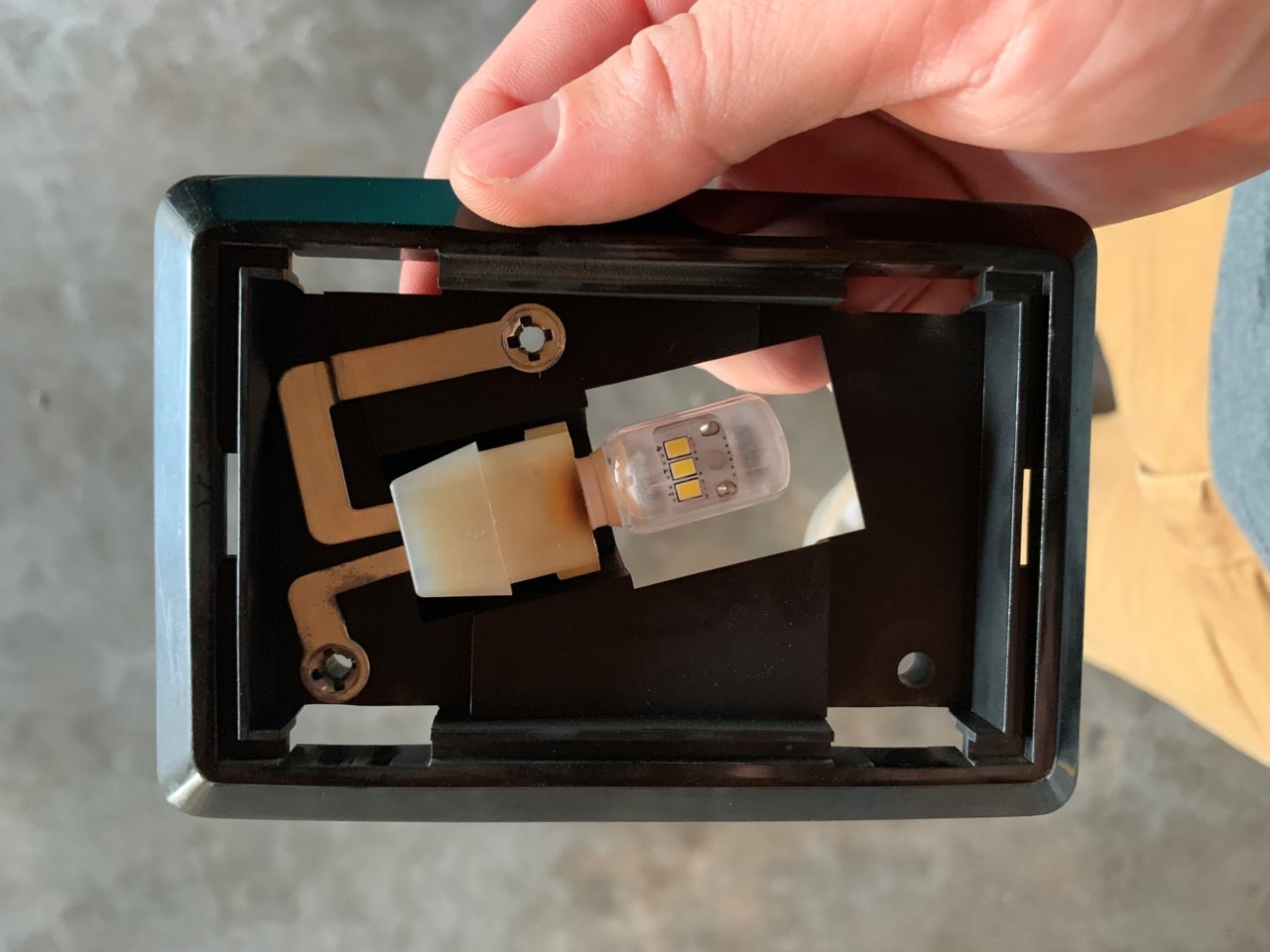

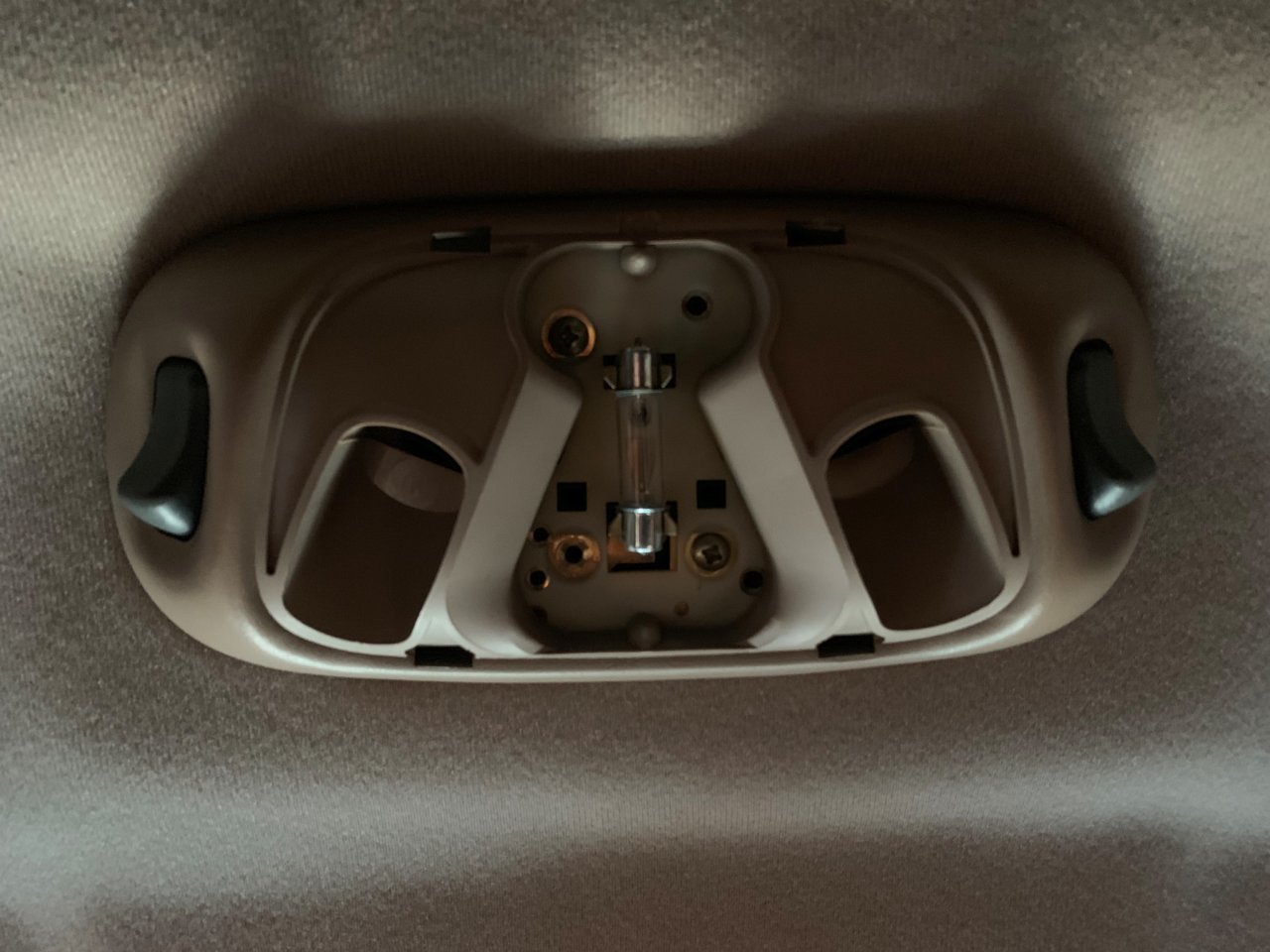

Mind if i pick your brain Nubreed?
This is my factory dome light with a Philips LED. Note the 2 mounting screws also power it.
This is the F150 Dome/Map light combo i bought on Ebay. Note the two re-used mounting screws, but there are 3 holes.
When i open my door, nothing comes on. If i turn on either of the map lights, the center bulb comes on too. If i turn on one of the switches, then open the door, it turns anything currently on, off, until i close the door, then they come back on. If both switches are off, the lights all stay off, so i'm confident i won't burn my truck down. Is there a way to configure this so the center light comes on when i open the door, and off when i close it like the factory setup? Do i just need to reverse the wires?

From what I recall, the factory F-150 dome light in my old rig had three screws. Can you get a screw in that third spot? If so, I wonder if that might make it operate the way you want? I'm great at swapping bulbs, but by no means an electrical genius. If it was me, I'd try the third screw and see if that gets it working the right way. Worth a shot!

I'm gonna give that a shot. Someone on FB said that the 3rd screw is a ground, which should fix it, in theory.nubreed71 wrote:From what I recall, the factory F-150 dome light in my old rig had three screws. Can you get a screw in that third spot? If so, I wonder if that might make it operate the way you want? I'm great at swapping bulbs, but by no means an electrical genius. If it was me, I'd try the third screw and see if that gets it working the right way. Worth a shot!

That's what I recall. When I swapped the headliner out on my rig, I remember the light doing weird stuff until I got all three screws in. Let me know if that fixes it!

3 screws didn’t fix it. If anyone has pictures of their light mounted with the clear lens removed, and of the two wires underneath with the light removed, that would be awesome
