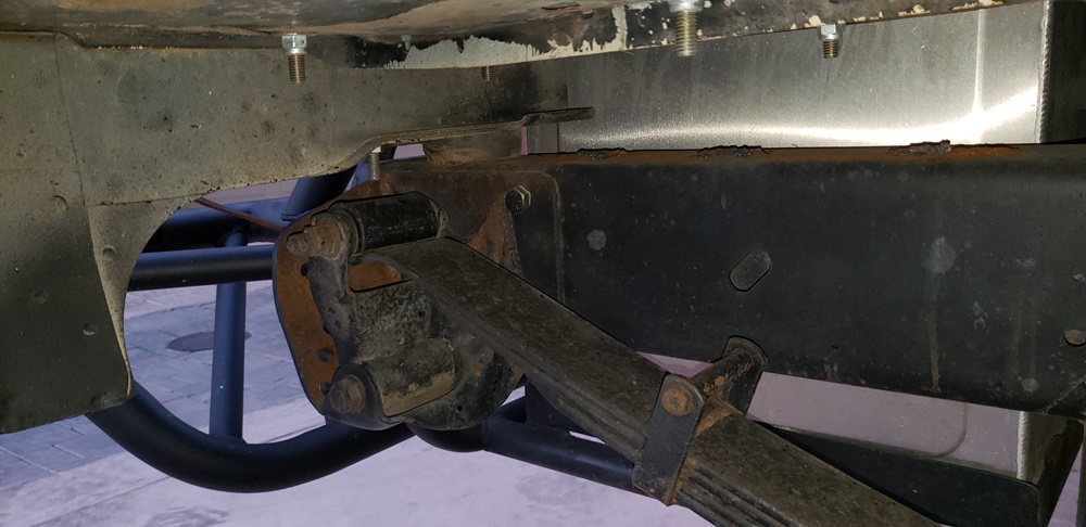

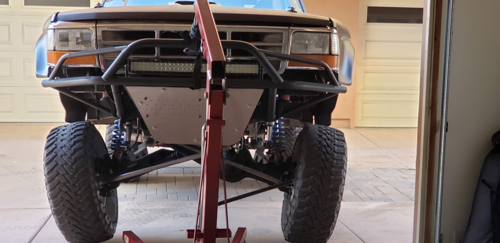

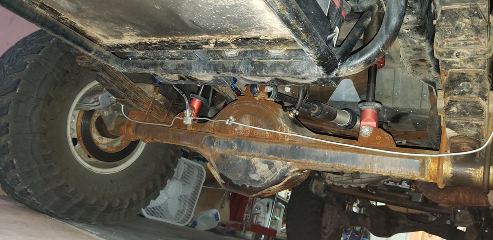

First, it the rig too high? There is a lot of space between the frame and bump stops that is unused. On the rear is about 12" of usable space that is prevented. Front is a good 6" of uptravel that is prevented. It's always on the bumps, about an inch of uptravel before hitting them. Someone said that is good as it works like a sway bar. (I'm thinking sway bars work like sway bars) But, maybe I'm wrong?
Is there a post on setting ride height?
It seems that the rear shocks should be moved outboard to the leafs, more leverage.

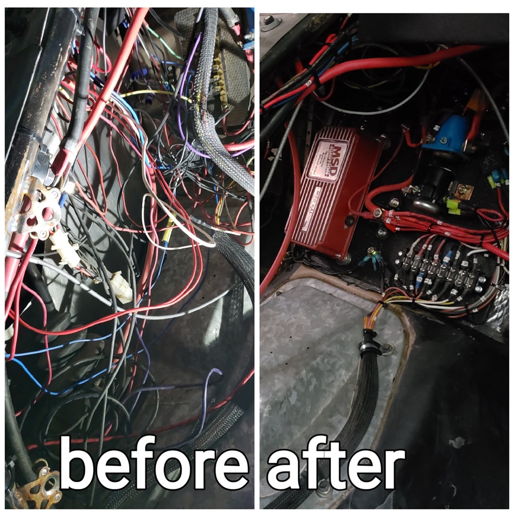

redid the all the wiring.
