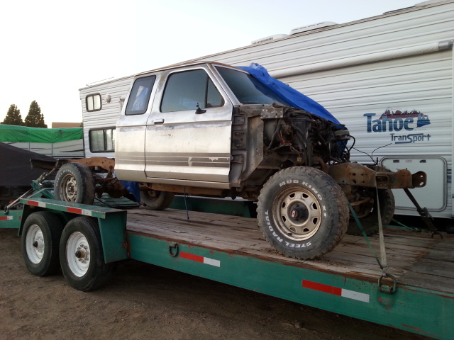

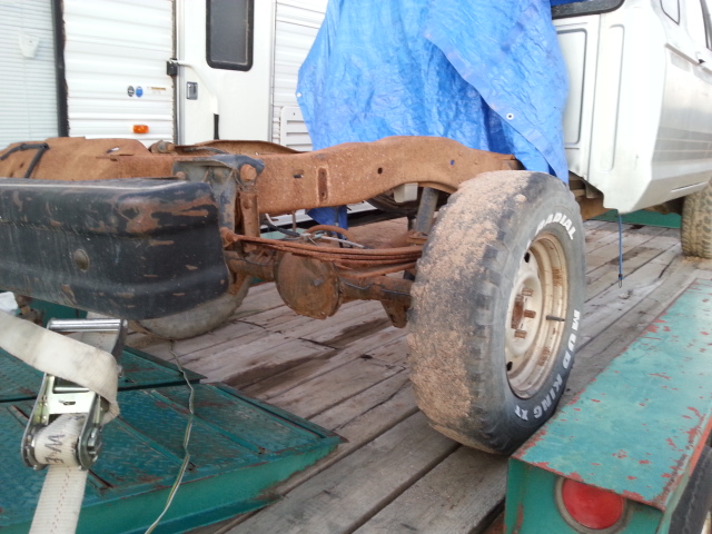

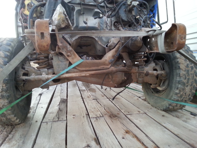

Well her she is. This is the way we got her, no motor, trans, bed, or front clip, which I liked because I dodnt half to take all that stuff off. We went to the junk yard today and found a good truck to pull the ttb from, which it has 4.09gears and right next to it was a econoline van with a 302 and c6 so were planning on making a trip next weak to pull the ttb and motor later on and the ttb is out of a 95 f-150.

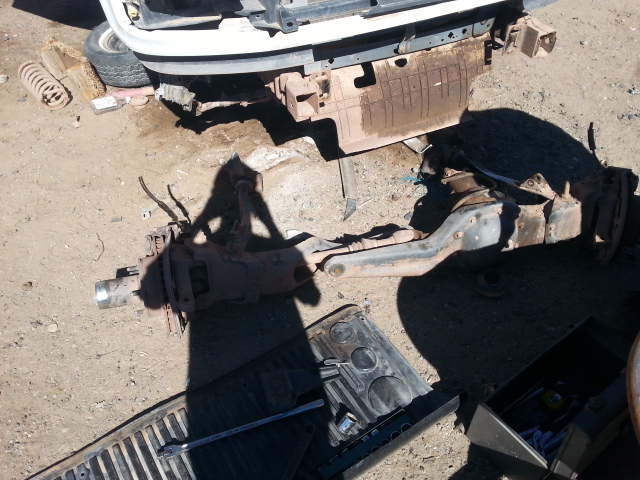

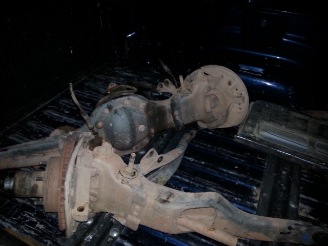

Well we made the trip to you junk yard, with my son, so we found a candidate for the ttb. The vehical was a 1993 ford f-150, and this one still had the manuel locking hubs wich was unusual, since there always torn apart, the only thing I dont like is it has 3.56 gears but I guess I cant be picky and I will just put higher gears in.

NIce! are you guys going to do a cut and turn on those beams?
I have read a little about it, and I believe there is a thread on here somewhere, and pretty much all you do is extend the lower balljoint location about 3/4". You will need to clearance the passenger side axle joint to get the most travel you can. Do you have any idea how much wider the d44 beams are compared to what was on the ranger?

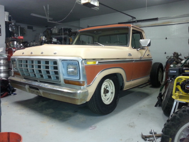

Also, my next build is a slammed f-100 for my wife, that is a sweet one you got there!
