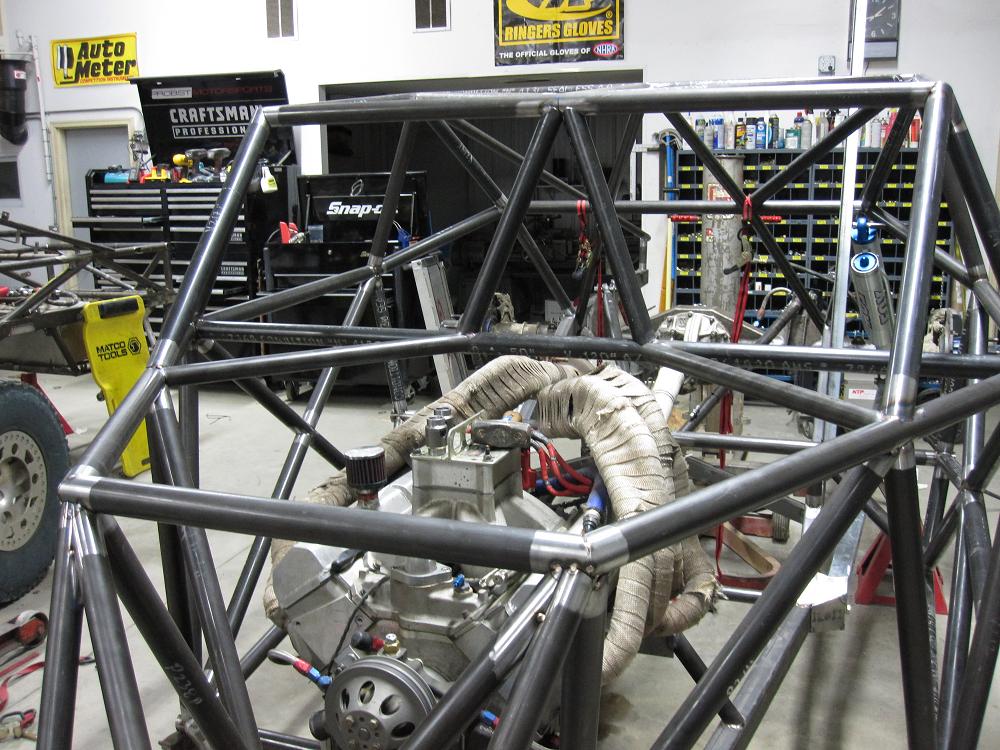

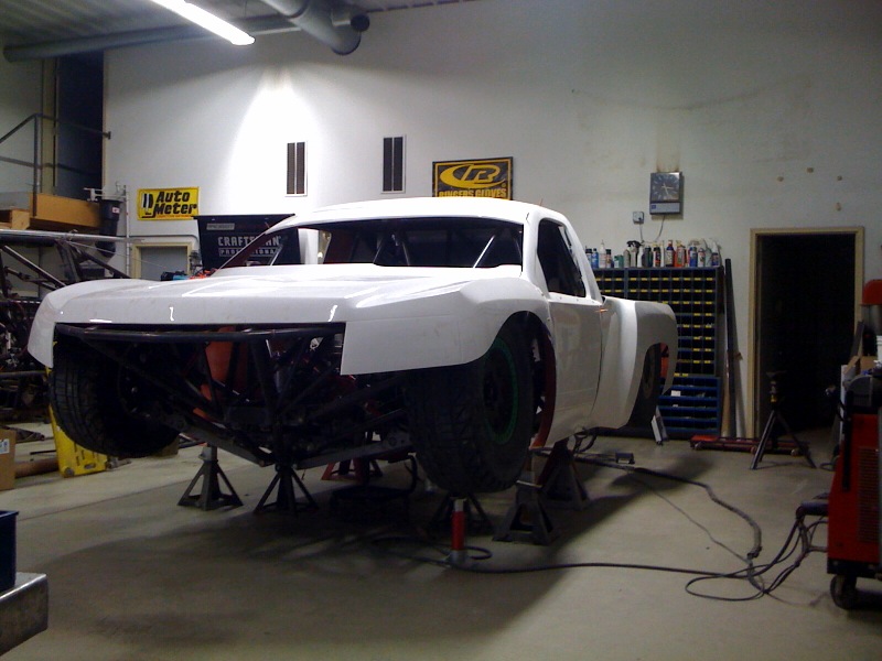

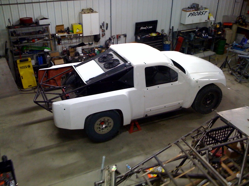

Have not really posted pics of much bronco progress lately and thought I would post some pics of why.
One week before christmas this truck was a phone call from Kevin Probst saying lets get a chassis tacked up and see what happens. It's be racing Next weekend in Vegas!

If it's racing that means it's done. ANd if it's done that means TIME TO GET BACK TO WORK ON THE BRONCO!
Lookin good Erik!

No bends! That's what I like. Are those cnc'd AL links?! Wowowow!
Re: Bronco Project killer!!

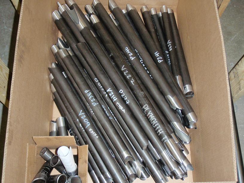

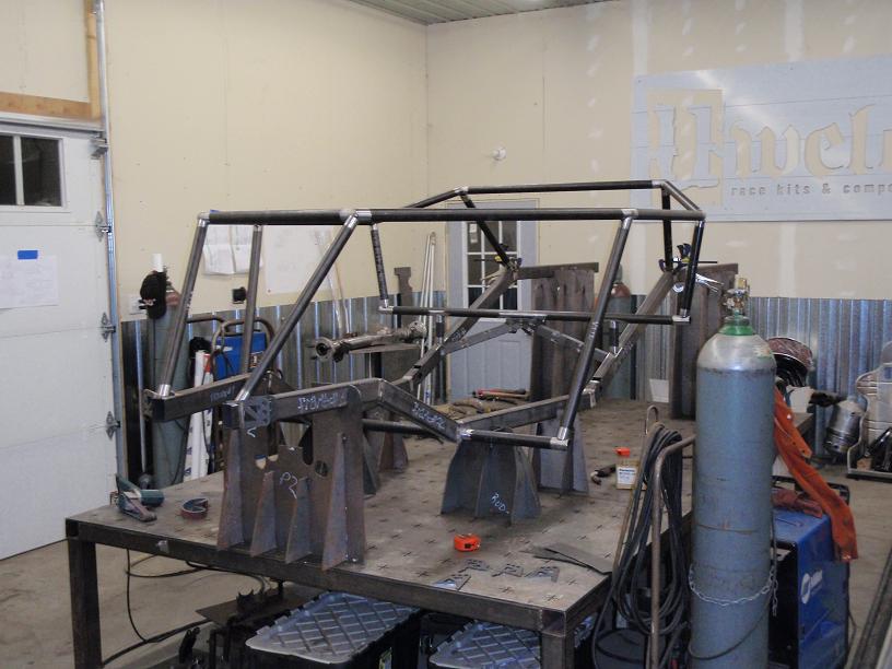

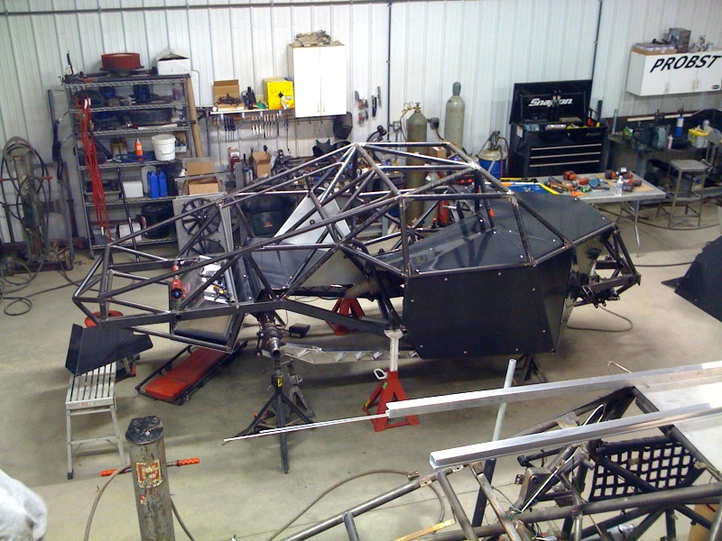

Thanks guys! I'll be back on the bronco wed! Yep, those are CNC billet lower links. Can't claim we made those though! I love having no bends in the chassis. All the tubing is laser cut and goes together really fast and accurately. There are no mitres that are not part of a multiple tube intersection. Kevin has been doing the finishing work and two of our guys have been staying down in chicago and helping him finish the truck.
