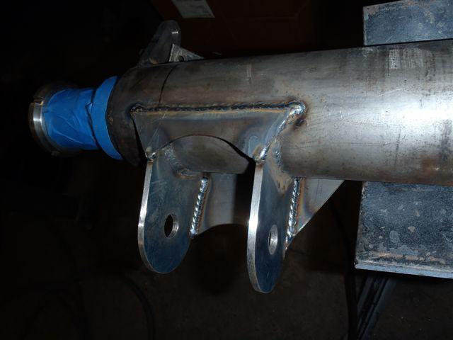

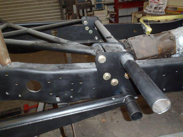

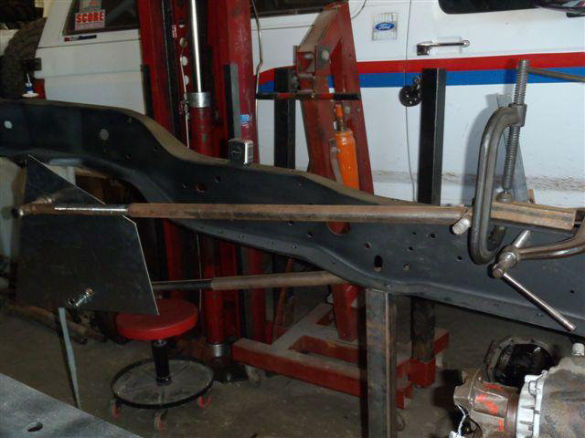

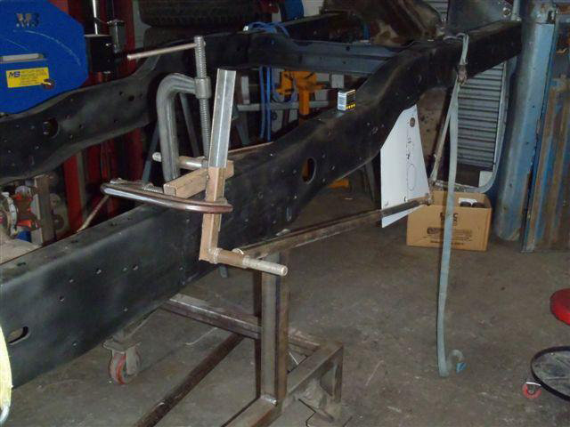

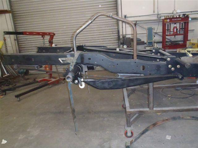

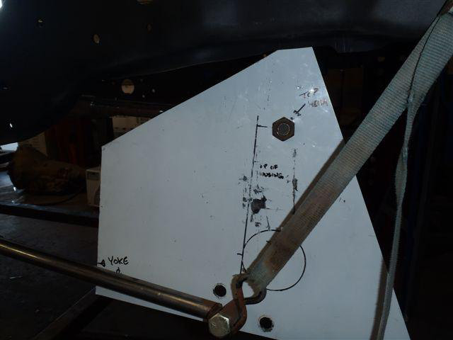

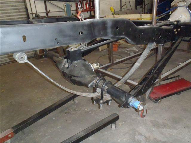

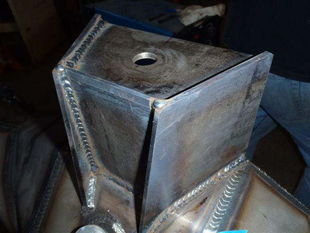

BajaChris wrote:I don't know about all the alphabet leaf spring names. But I have started my class 3 go fast
rear suspension. Here is a couple photos. The leafs will be based on a full size chevy leaf
which is long and symetrical. I'm putting the leafs under the axle and under the frame rail to
make room for the Bilstein Blackhawk and coilover on the trailing arm. At full compression,
the spring and shackles lay flat under the frame without any negative arch. At full droop, both
shackles allow for 25" travel. Dual shackle setup. It cycles 25" with less than 1/2" of driveshaft
plunge and good u-joint angles. Axle and engine in stock location, frame unmodified (not
even welding to it, everything bolts on). Tranny is a C6 race box from RDE (Rancho). T-case
is a NP205 with a NP208 adaptor, 8" shorter package than the BW1356. Anyway, thread title
is "start your go-fast build - rear suspension", so here you go.
- C3 (1).jpg (63.58 KiB) Viewed 49045 times
- C3 (2).jpg (65.82 KiB) Viewed 49045 times
- C3 (3).jpg (68.46 KiB) Viewed 49045 times
- C3 (4).jpg (68.59 KiB) Viewed 49045 times

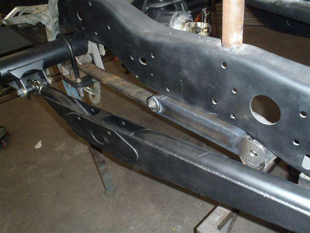

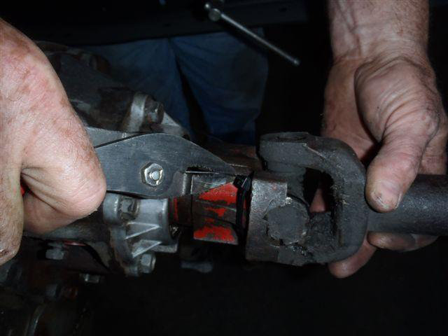

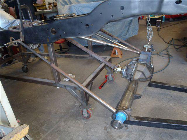

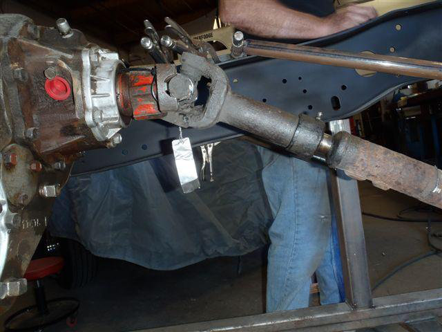

Here's a couple pictures showing the trial and error mock up for designing the rear suspension links. The tin plate has a side view of the rear end housing with a couple holes for different possible link locations. The links are telescoping and are tack welded, cut, repeat to try various link lengths. Then the link locations on the frame are held with c-clamps to make them
easy to move. The focus was to get the driveshaft where we wanted it. It's a bit like religon I guess, but I'm of the opinion that you must have minimal driveshaft plunge to have reliability under race conditions (where you are transmitting max torque while the suspension is cycling fast). So that was one of the areas of focus. We also focued upon roll steer and roll center. It's all a bunch of compromises. No such thing as a perfect setup. I started out in two dimensions, just looking at the problem from the side view.
- C3 (5).jpg (38.97 KiB) Viewed 49031 times
- C3 (6).jpg (66.45 KiB) Viewed 49031 times
- C3 (7).jpg (65.18 KiB) Viewed 49031 times
