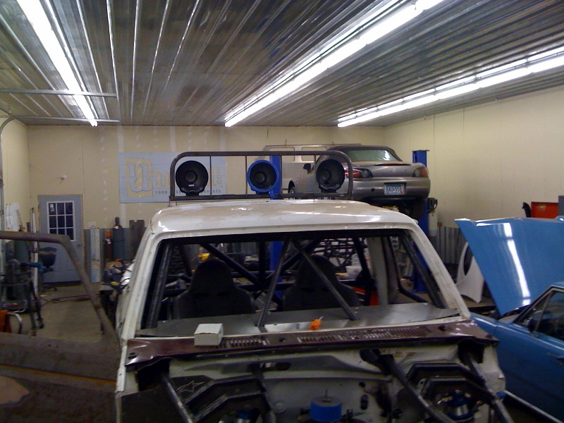

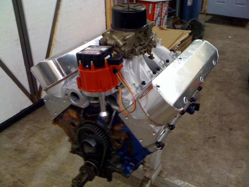

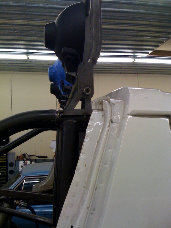

More pics of the "quick and dirty" build. Which has been less quick and more dirty! Haha! Alot of little things going on right now that make boring pictures. Buttoned up the motor, I'll wait to get it in the truck to make the headers. Also got my rallye 4000's in and built the upper light bar and ordered a linear actuator for it. It will hold 5 lights but is narrow to fit between the down bars. I got the tranny mount in the truck, and have been working on actually mounting fiberglass.
- motor1.jpg (131.17 KiB) Viewed 35310 times
- lightbar2.jpg (151.17 KiB) Viewed 35310 times
- lightbar1.jpg (122.92 KiB) Viewed 35310 times

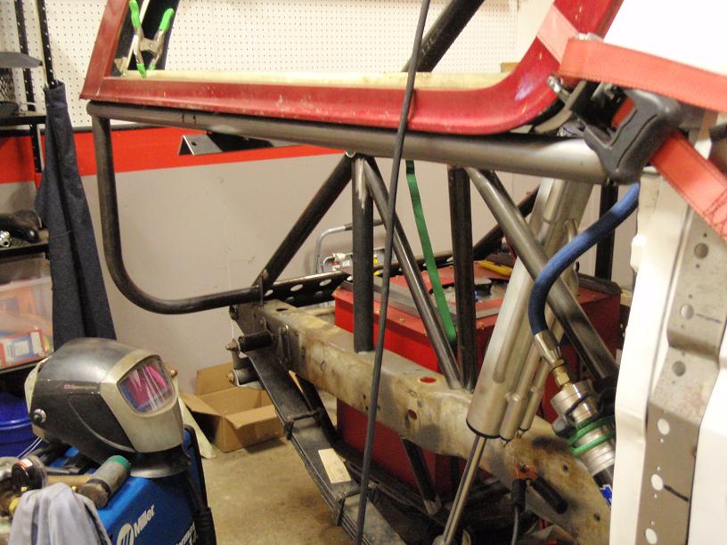

Also, you always liked the concept radius arms I drew. The real thing didn't turn out AS cool but they still look good enough for this truck and should be plenty strong.
All it takes is the push of a couple buttons to make another set! Let me know if you want some!
- Radius arms.
- PA280540.JPG (115.96 KiB) Viewed 34825 times
For whatever reason I was under the impression that longer radius arms are a no - no. I just read the entire SCORE rule book for general and Class 3 and figured out that it isn't. That means I need to make the cage in my Bronco legal and add a cell.... hmmmmm.

It only has to maintain stock concept.
"Number of shock absorbers and mounting methods are optional. Mounting points may be redesigned, strengthened and modified. Remote shocks are allowed."
Whoops, misread your post the first time! Do it, the more class 3's the better!
