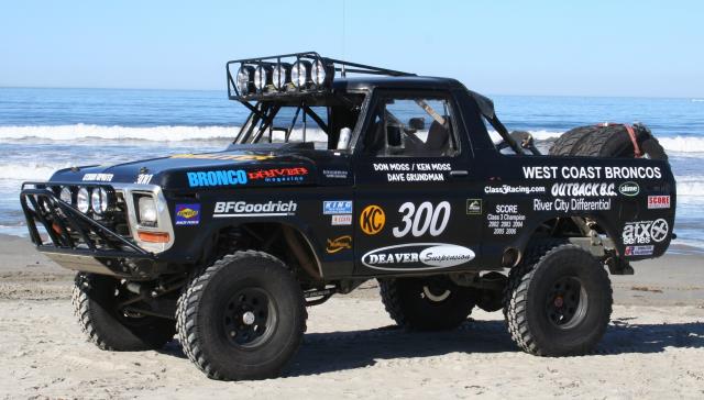

Thought I would start a brief post on the Moss Brothers Bronco to see how this all works out. I will try and add to it as time and questions arise.
History: This Bronco was built in the year 2000 specifically to run only the Nevada 2000 race to say we raced one of the big historic races. Well we didnt finish in time for the Nevada and moved goals to run the Baja 2000 race and just made it to that one. That was one hell of a race (1760 miles) to break in a new truck. We broke a lot of parts and learned a heck of a lot in that 65plus hours it took us to finish, but we finished and that is one of our achievements I am most proud of as a team. We took the next year off after the killer race then picked up in 2001 and have achieved 7 championships since then in SCORE racing and two Toyota Milestone awards. The best thing about racing with this group of people is since starting with quads then motorcycles and then the Bronco our finishing average percentage is in the high 90s. The average finish rate of a SCORE race, usually about 50% of the entries drop out.
Specs List.
-Motor 351W Aluminum heads installed in 2000, Shortblock untouched since built for circle track car in the 90s. All built by Don Moss
- Transmission C6 built by Don Moss. Full roller internals, manual valve body. Gate shifter built by crew chief Dave Grundman.
- Transfercase NP205 stock and bulletproof.
- Rear End RuffStuff Specialties Housing. Cone industries Axles and drive plates 35spline floater. Strange center section and spool with 4:56 gears set up by River City Differentials.
- Front end Dana 44 Heavily trussed by Dave Grundman. CTM u-joints, open differential, Slugs no hubs.
- Rear Suspension Custom leaf packs designed initially by National spring in 2000, Replacements now built by Deaver Suspension to match those. King 3.0 Bypass race shocks 16" travel offers approx 18" axle travel.
- Front suspension West Coast Broncos Radius arms and modified Heim end track bar. King 2.5" 14"travel coilovers strapped to quite a bit less. Plus 3.0 14" Bypass shocks in front of Coilovers.
- Steering UMP modified stock box, Race pump and large cooler. Stock tie rods and geometry. Coleman 1.5:1 steering quickener.
- Electrical System Dual alternators, batteries and redundant systems. Every load can be run on either system and are completely isolated from each other. Another Don Moss item.
- Lighting 10 KC HiLites HIDs. 8 are now the PODS 70watt (very nice)
Will post more photos and details later. Thanks for looking..

The beach shot looks like a special (tide comes in here) place south of San Felipe! Ill be sure to say hi next time you roll through contingency.
Re: MOSS BROTHERS 79 BRONCO CLASS 3 RACER
That second shot is just bitchin', Ken! What a cool start you guys had with that rig. I wonder if you guys realize how many fans you have.

Laughlin. Don playing with Stock Fulls and Trophy Lites .
The Beach shot is actually the Pacific south of Ensenada. Punta Banda.

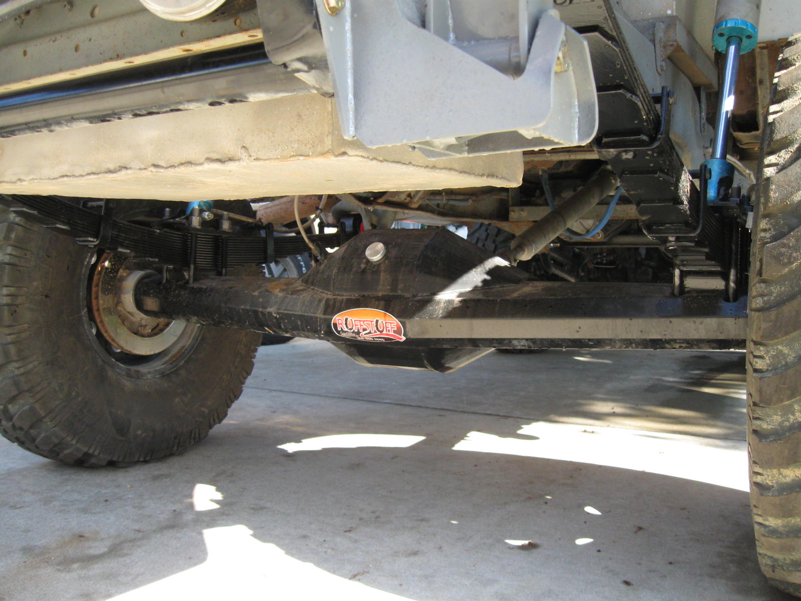

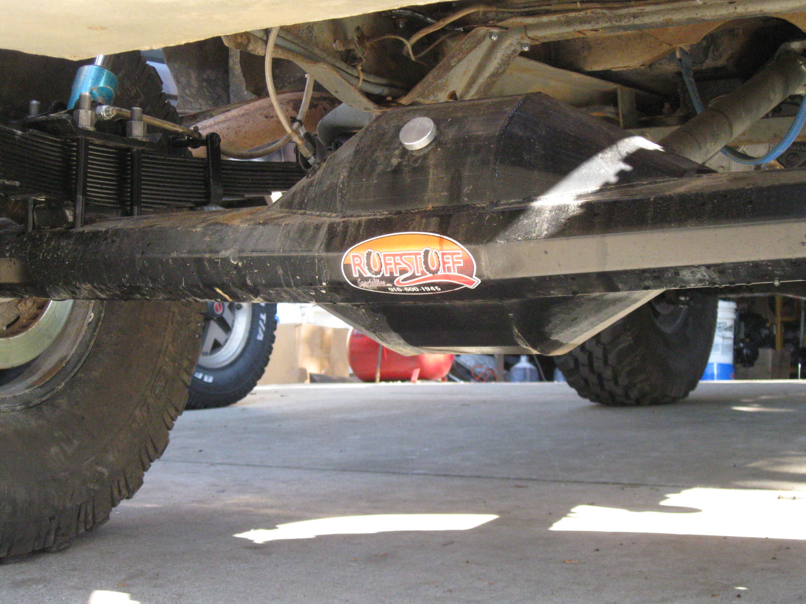

Some shots of our new this year Ruff Stuff Specialties rear end housing. Gained some good ground clearance with this unit and lots more strength than our old housings.The old ones would make it a couple seasons before being too bent and beat to use. After looking at several of the manufactured housings I think this is one of the cleanest designs out there. Ken
Couple more.
