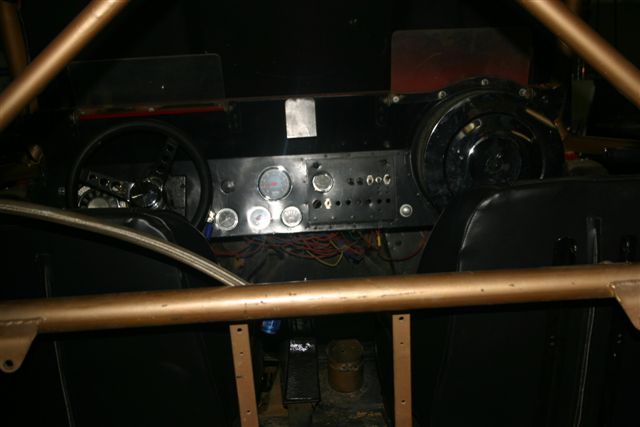

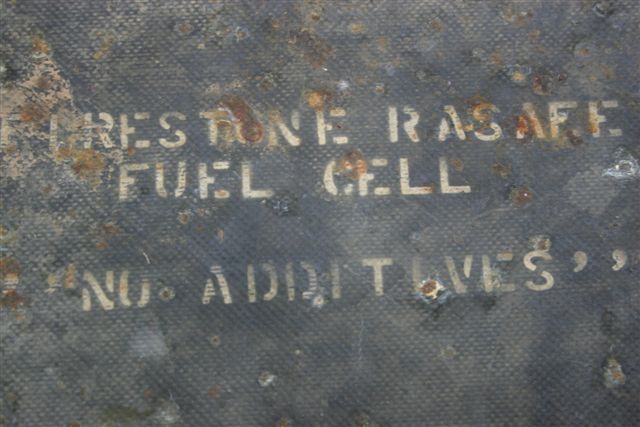

Here's a few pics from today.
baja-chris
Posts: 712
Re: GoFastBronco from the early days
Post by baja-chris »
A few more from today.
