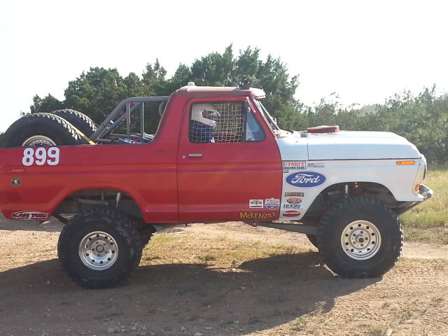

- Side pic.

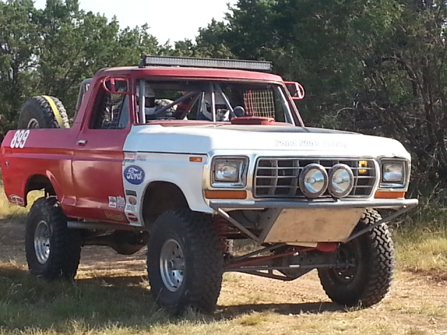

- Getting in line.
- 20140719_181047.jpg (175.96 KiB) Viewed 36645 times

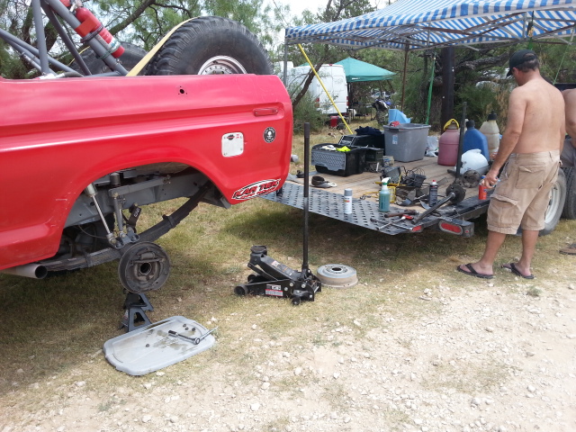

- Trying to figure out what was wrong with the axle.
