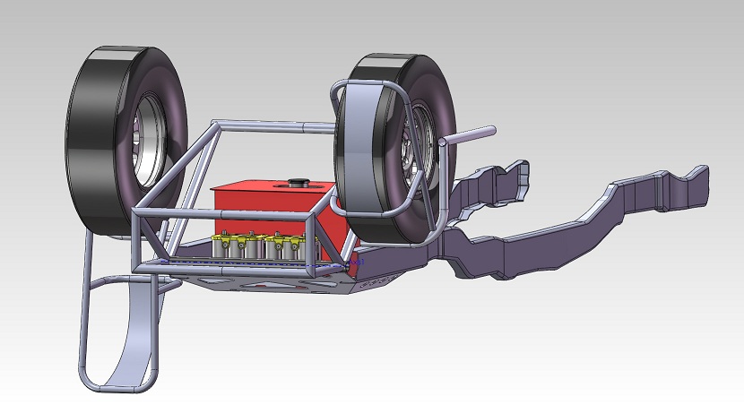

More pretend progress... I have been pretty busy with some prolite stuff but have been sneaking some bronco time here and there. This is my layout for the rear. The rolled sheetmetal piece over the tire will be dimple died, and the rear bumper will have brake/dust lights in it. I hope to sneak to the shop this sunday and actually get a couple hours of work done.
FUEL CELL MOUNT2.0.JPG (77.65 KiB) Viewed 4552 times
Sweet!! Great set-up. Frame is coming along nicely.
Thanks! I am continually tweaking it. I just built some transfer case cross members the needed about .375 trimmed to fit in the frame rail so it was back to the model to tweak it. The good thing is they were both off consistant. I have to verify frame thickness and take some actual measurements off the truck. Like I mentioned, right now I am modeling of an emailed scan of a 26 year old Ford Print!

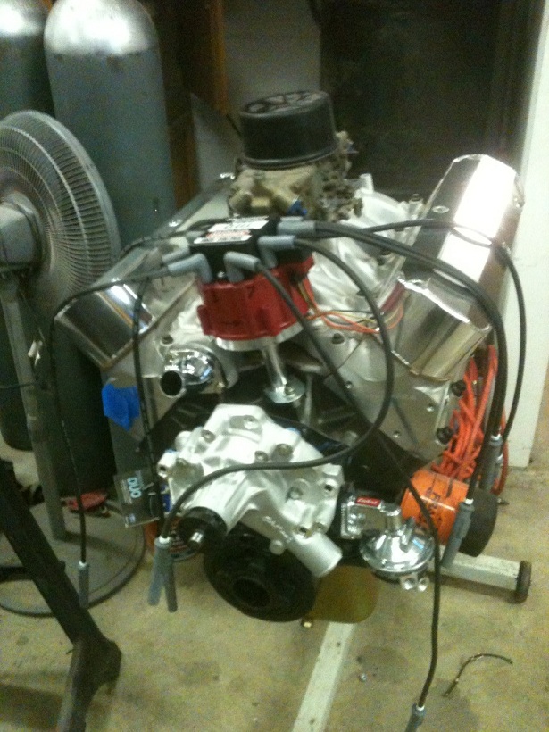

All right, I have the bronco out of my garage and back to the shop to start taking the old motor out. I ordered a new carb from C and J (Thanks Dave and Moss) and it should be done in about 2 weeks. I also ordered all the raw material to fab up headers, and took some material out of the firewall to clear exhaust/tires at full bump.
I can't wait to get the new motor on the dyno!
Oh man does that motor look good! The only thing, your not going to use the fram filter are you? I've had issues on my stock roller motor with them. Wix makes a better one (baldwin) but you probably know that. They're cheaper too. At least in California they are.

I use the cheap Frams for priming the motor and that's it.

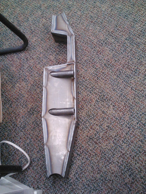

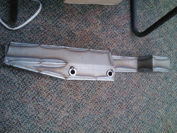

Little more progress on the crossmember/trans mount while I wait for my carb to get here! I have the mounts on the chassis and the bushings, I just need to put it all together and bolt it to the truck. I need to shorted the bolt slugs a little too, they're about 2" too long in this pic.
