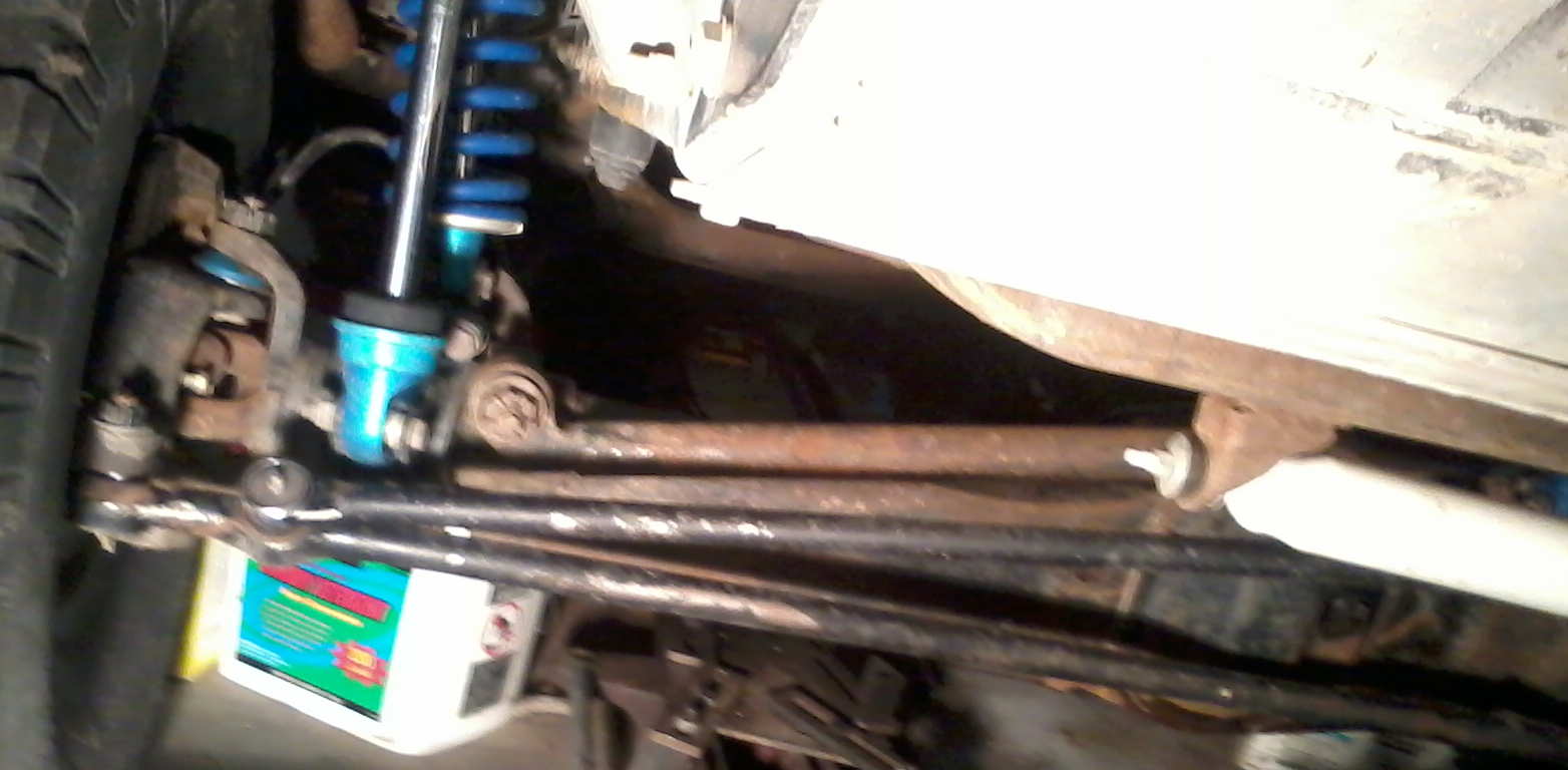

Getting this out of Bill's thread, and in response to CT754's question about the steering links on a 78-79, here is the issue in the picture. The drag link attaches very close to the end of the tie rod on the passenger side. There is not enough room for a standard heim adapter and keep the drag link attached in the same place. There is also an issue with how to keep the tie rod from rotating if the drag link attaches to it. The stock stuff uses washers to limit the rotation, and you can see the washers are blown out in the picture. Most aftermarket stuff I have seen runs the drag link over to the steering arm. I have looked at this, but it definitely causes more bump steer at full droop than the stock geometry does. I just don't know if it would be objectionable to drive.

Other than washers blowing out, how much longevity are you getting out of the stock steering linkage, Don? I know Chuck at BC always says that theirs went away in one B1K and they switched to heims after that. I have the F150 setup (flipped on top of the knuckles) on my EB and it's lasted for many years although I'm not racing. Chuck has that saddle mount that could give you some flexibility as to where the drag link attaches to the tie rod - I'm not sure whether it forces rotation of the tie rod as force is applied or not - it probably does. That's one downside to the T-linkage compared to the Haltenberger linkage - we have more of a dead spot on-center as the rotational slop has to be absorbed before the actual steering starts.300 wrote:Getting this out of Bill's thread, and in response to CT754's question about the steering links on a 78-79, here is the issue in the picture. The drag link attaches very close to the end of the tie rod on the passenger side. There is not enough room for a standard heim adapter and keep the drag link attached in the same place. There is also an issue with how to keep the tie rod from rotating if the drag link attaches to it. The stock stuff uses washers to limit the rotation, and you can see the washers are blown out in the picture. Most aftermarket stuff I have seen runs the drag link over to the steering arm. I have looked at this, but it definitely causes more bump steer at full droop than the stock geometry does. I just don't know if it would be objectionable to drive.
The stock linkage has a fair amount of understeer built into it (drag link is below the roll center of the front suspension) and taking the drag link over to the knuckle would bring it closer to a neutral steering condition, although as you say, the bump steer would likely be more of an issue with the increased delta in lengths and angles between the trac bar and drag link.

Thanks for the pics. Makes a lot more sense now.
Kind of basing a thought off what Todd posted - are you not able to flip the tie rod to above the mounting ear on the knuckle? That would allow a tabbed style connection for the drag link, thus allowing the connection point of the drag link to the tie rod in the same spot as factory? The downside is the connection would most likely have to be in single shear based on where the connection is made & how the steering cycles.
As for how to stop the drag link from causing rotation on the tie rod - that is a trickier fix. Possible thoughts on that are tack welds on the jamb nut to heim & then from tie rod tube to jamb nut. Not a perfect solution by any means though.

I have that problem with the link from the driver side to the passenger relay.
It has to have a big gusseted bow and the drivers heim is continually coming loose and the link drops down.
Really hard to get the thing tight because one has to hold the link and the heim when tightening the nut.
Cheaters are required for the nut and the Heim while bracing the link to a fixed position.
It really takes more than one guy for really tight nut. (1.25" nut)
Then the whole issue is made worse when I drive in a hole even with a reasonable
speed then the stress on the link just makes to issue worse and the result is a loose nut.
I use shock donuts to hold the thng in place when the nut is tight, but when loose it droops low when the nut gives up the grip.
I wish there was a better way than tack welds.
I am open to suggestions.

Green loctite?

Been thinking about using a link from the tie rod to the knuckle to keep things from rotating but hate to add more moving parts. So far sloppy steering has only been annoying and has not potentially ended or lost our race like broken spindles have, so the attention goes to the bigger problem.

==hobbyturnedobsession wrote:Green loctite?
Used red. Now to do over the thing has tocome apart and toe and S wheel center has to be done over.

Just had a crew member send this link to me:
http://www.wildhorses4x4.com/product/CL ... nco#videos
Watch the video, it explains it pretty well. Those cartridges look like ball joints that are commonly used in circle track stuff and should be strong enough in use as a tie rod end. The end links are a beefy part that is apparently forged for them for this application. They are also taking care of the rotation problem with their "rock lock" washer. That price will get your attention, but it is just over twice the cost of Napa stock replacement parts.

now that looks like a pretty sweet solution. I wonder how long the "cartridges" (ball joint type assembly) hold up & how much they cost.
