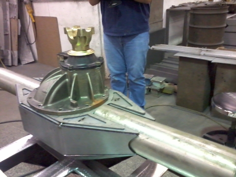

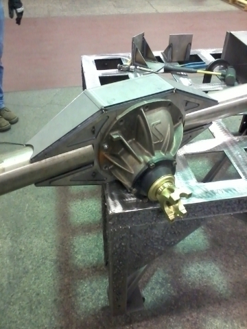

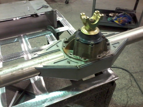

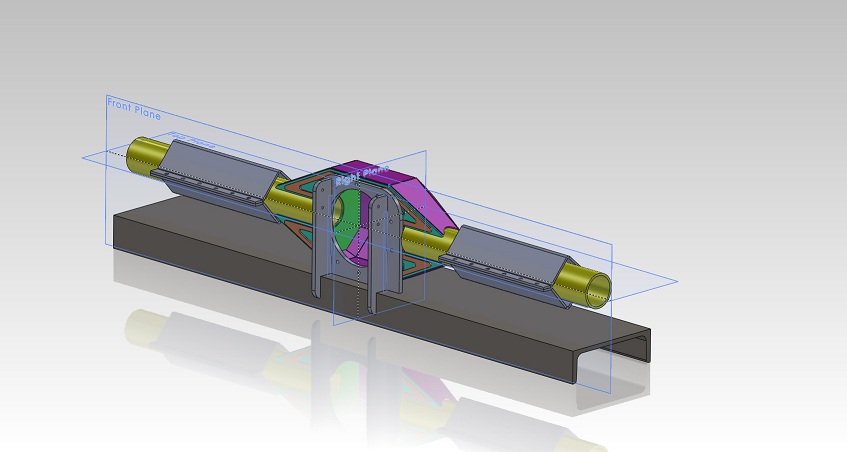

Made a little more progress tonight. I have most of the axle housing done minus some internal gussets. I won't weld it thought until I get my fixture completed. I have a bachelor party :mrgreen: this weekend but I am hoping to finish up the design work on it and be back to fabbing by next week. It should be large enough I think and will match my Chrisman hubs well!

Nice housing! What size tubes are those? Are you drilling the center section holes after you weld it up? Had trouble with a similar design with pre-drilled holes moving a bunch after welding.

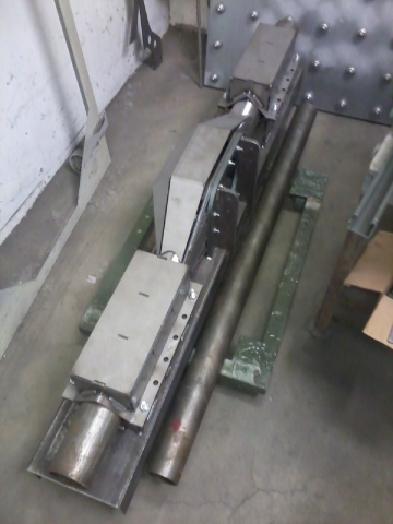

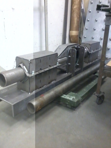

4" x .250 wall axle tube to match the 3.5" OD Chrisman snouts I have. What kind of fixturing did you use for welding your housing? I have a .500 thick front plate to hold the front face of the axle housing, which will have the studs pressed in before welding. I am hoping this will keep things where they belong. Then a couple fabricated sleeves to hold the axle tubes. That is the plan for now. Here is a partially complete pic of the fixture.

The 3.5" x 3/8" axle tubes were fixed in saddles, and a standard center section was bolted to the front plate. It was impossible to get the bolts back in once they were pulled out, and we had to enlarge and egg out the holes in the center sections to get them to fit. We're still using GN snouts and hubs.
Hmm, thanks for the heads up. Maybe I will go to something smaller like a 1/4-20 to fixture, then come back and drill it out to the actual size using another template when I have it fully welded.
I have another bachelor party this weekend, but I snapped a couple quick crappy cell phone pics of the fixture. It still needs a bit more welding, but seems to be very very solid.
I went to 1/4 bolts to hold in the center section, and have a template to drill to the correct size when the axle is finish welded. Thanks for the heads up Moss.

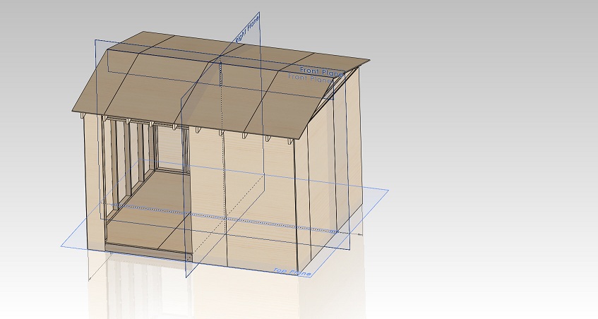

Solidworks storage shed FTW!
