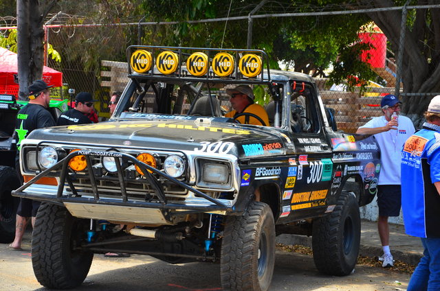

Some pics at the 2012 B500! Tech...

Re: MOSS BROTHERS 79 BRONCO CLASS 3 RACER
Post by cdnbronco »
Do you have a better picture of the front axle. I'd like to see the front bracing on Moss truck. If it can survive them, I'm sure it's a good setup.
I wonder if I they have the CAD drawings of the braces?
