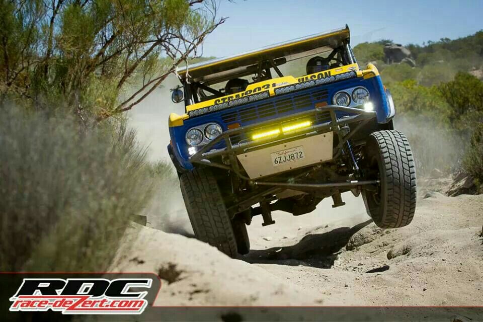

How did you guys do at the race this weekend?? Pretty good frontal picture here.
http://www.race-dezert.com/home/golden- ... 88351.html

- baja-chris
- Posts: 712
Race went good, new tie rod design good. Race run in two stages Norra style. I did first stage Ojos to Valle t. Via tres hermanos up big wash past silt up long rocky hill climb to Alamo the back to highway on same old score track whoops and pine trees. Cross highway and then some new stuff up by mtns then south past Nuevo jct and down goat trail. 85 miles to time control and I did it in 1:47 which is 48.5mph. Very fast, I was fastest class 8. Started 13th overall. Handed off to Glen and they lined him up 7th overall for stage 2. But Glens stage was all desert whoops and the big trucks ate him up. 8 truck side swiped him on a pass and munched our new fender and cut open front tire. Hard hit to the steering, tie rod fine. Happened right in front of us so we stopped on side of highway and Tony ran over to change flat for them. Issues with spare hold down so slow stop. Finished 2nd in class 8.
