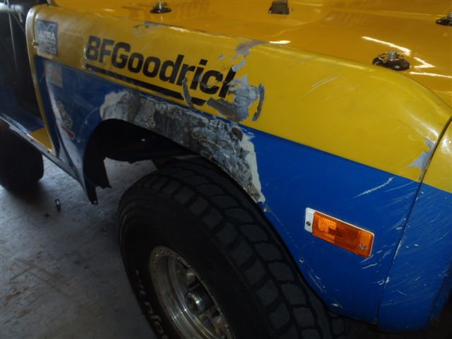

Here are some post SF250 pictures showing off our steel bodywork and wing details. It's just metal. We made it and we can fix it. Just takes time and cosmetics are at the bottom of race prep list.

More carnage.
baja-chris
Posts: 712
Post by baja-chris »
The drivers rear corner took the worst of it. It was so bad that it had to be removed up on the mountain in order to continue the race. It was left behind as a souvenir. It was pushed in above the rear tire and wrapped around the tire and into the suspension. Was not easy to get it off of there even after unbolting it. The steel is thick and heavy on these old school trucks, not all easy to pull out by hand. Takes a port-a-power to pull them out.

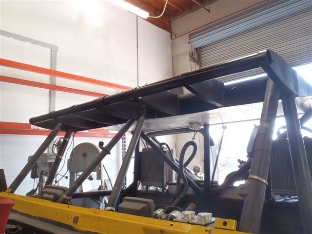

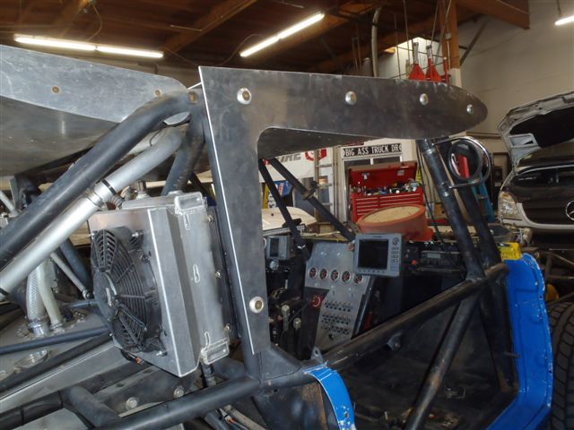

Here are some wing repair photos. The truck flipped clear over, munched all four corners and the drivers front side of the wing and yet the rear wing elevator was untouched.

More wing repairs. The ribs are fabricated from thin steel sheet, the skin is aluminum. The leading edge has a thin wall steel tube behind the aluminum to provide some support for tree branch hits.

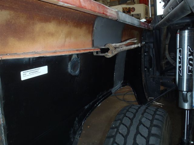

Broncodawg wrote:Looking good, did the new driver's rear quarter come from same era truck or Eb?
Too bad Moss isn't headed down to race you, but have a blast anyway.
I bought an EB carcass from a yonke in Phoenix. Had a friend with a freight company drop it on a westbound LTL drop deck.
I went up to the freight depot to pick it up. Not sure what year EB the carcass was from, it was drivers side A-pillar to taillight.
To stretch the EB to fit our 1991 chassis, we splice in 2" in the middle of the front wheelwell, splice in 6" in the door rocker panel, then splice in about 8" in the rear fender.
You can see how we do it in the photo that shows the backside of the fender. We separate the upper and lower fender at the factory seam (drill out the 40 year old spot welds).
For the top rail, we just form some sheet metal to match the contour and splice it in. For the lower fender we use two to make one.
We add the length in the middle of the wheelwell. This, along with the width of the body, allows us to stuff 37" tires inside the stock profile fender.
When combined with the widening we did it all proportions out rather nicely.
For the width we added 14" at the cowl and 13" at the headlights, 6.5" each, making it dual headlight to get the width while retaining a stock grill.
We just shape sheet metal to fill in the gaps, weld it, grind it, sand it, and finish it.
