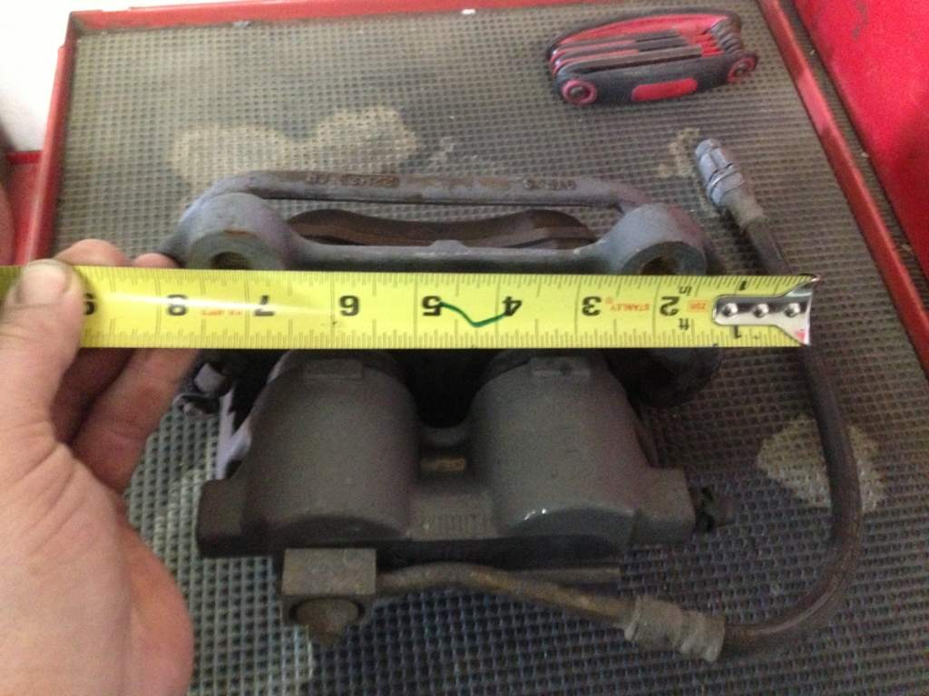

Got it. Which Wilwood Dynapro caliper do you have? 5.25 spacing and for a 1.25 thick rotor?
I have the narrow one for a .375" thick rotor. I believe it is the same caliper just missing a few spacers they put in the middle. I will try and look for dimensions tonight. Got your info, thanks!
I think they are these, but I will measure to verify.
Billet Narrow Dynalite
The PBR caliper I plan on using is huge compared to that. It looks to have a 5.0625 or 5.125 spacing.
I'm not familiar with a PRB caliper. What is the background info on it? i.e., what is it off? easy to get? cost? We can design to the PBR caliper if it makes sense, and I can modify whatever bracket we come up with to run the calipers I've got.

ESHALLBETTER wrote:I'm not familiar with a PRB caliper. What is the background info on it? i.e., what is it off? easy to get? cost? We can design to the PBR caliper if it makes sense, and I can modify whatever bracket we come up with to run the calipers I've got.
http://www.pbr.com.au/products/replacem ... pers.shtml
These particular calipers are from 2003 Mustang Cobra. These same calipers come on a lot of Baer kits, Corvettes, GTOs, Camaros, and others. Cheap, available at auto parts stores, and work relatively well. A radial mount Brembo Monobloc works a little better and has a little better feedback but it's way more of a pain to mount and cost is higher.

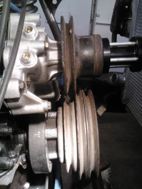

OK, been slowly plugging along on this thing. Like I have posted before, I am in the plumbing and wiring stages, and progess is getting harder to document! Here is what I have so far.
I have had to machine a spacer to get the water pump pulley flush with the crank pulley. (In the pic I still had machining to do, so the pulley is still too far forward.)

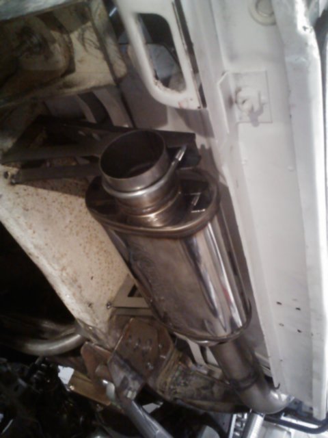

I also got the mufflers hung, and need to finalize the rest of the exhaust once my headers are finish welded.

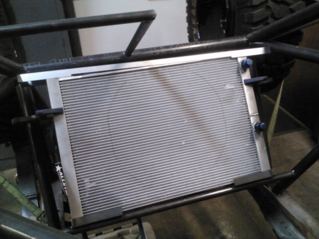

I mounted my trans cooler, and oil cooler, and am now waiting for fittings to show up. The oil cooler mounts right above the trans cooler in the pic, and all the plumbing will be run together down the chassis. The cooler is in backward in the pic, the fittings will be on the passenger side.

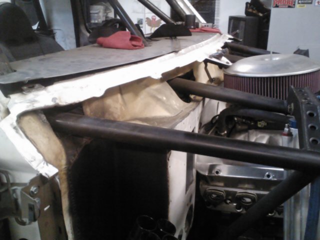

Lasly, I got some more of the firewall out of the way. I kept the mounts for the cowl, as well as the wipers, as I want to have wipers for prerunning duty. I still have to do the finish grinding.
