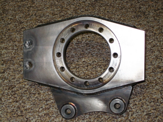

gunit
Posts: 340
Re: Gunit's class 3 racer build
Post by gunit »
13" rotors with custom rotor adapters, 5/8 studs

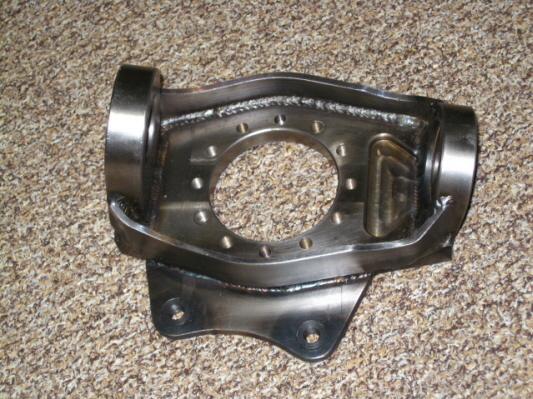

gunit
Posts: 340
Post by gunit »
Fabbed chrome moly uprights

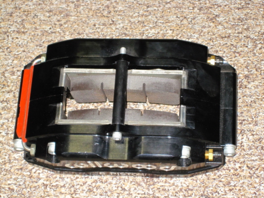

gunit
Posts: 340
Post by gunit »
Wilwood 6 piston calipers all the way around
very nice dave. who's up rights are those? did you make those?
bajascott wrote:very nice dave. who's up rights are those? did you make those?
Looks like BMS stuff.
baja-chris
Posts: 712
Post by baja-chris »
Is that a beveled cup for ball joints? Does not look like a uniball cup, is it?
BTW, I saw that truck a couple years ago at Ricardos. It's turning out very nice. The new 414 EFI stroker in my yellow bronco was built from the 94 block that was in Ricardos garage.
baja-chris wrote:Is that a beveled cup for ball joints? Does not look like a uniball cup, is it?
Those take balljoints:
http://www.blitzkriegoffroad.com/produc ... tb_spindle

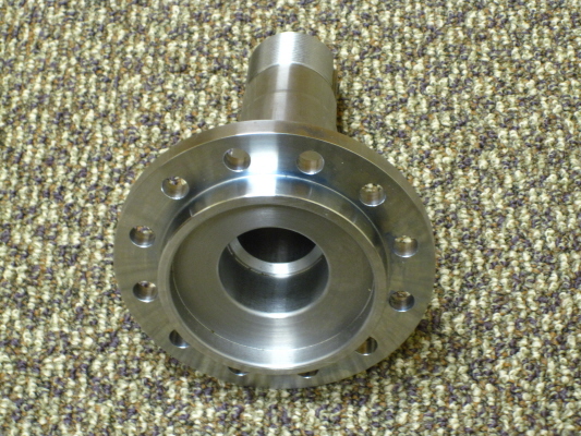

gunit
Posts: 340
Post by gunit »

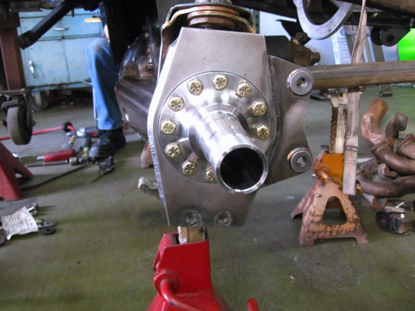

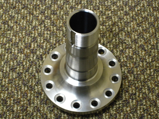

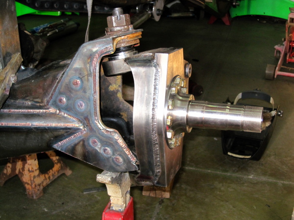

Custom spindle snouts made from heat treated chromoly.
gunit
Posts: 340
Post by gunit »
A few pics of the beams assembled with uprights & snout.
close to ride height
Snouts were built to press fit into the upright.
What balljoints are you using? I was always told the blue booted Napas were the best.

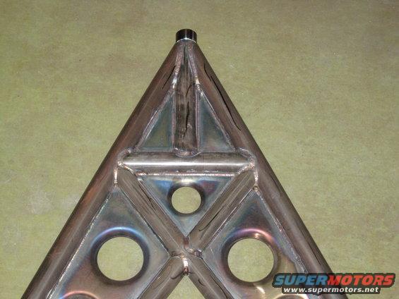

The upper wishbone for the rear suspension

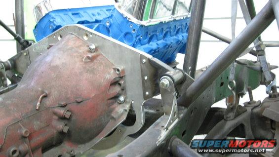

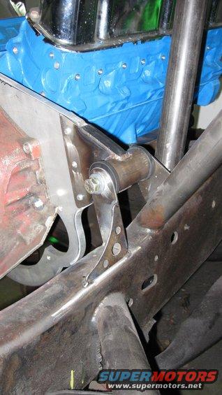

Motor plate engine mounts

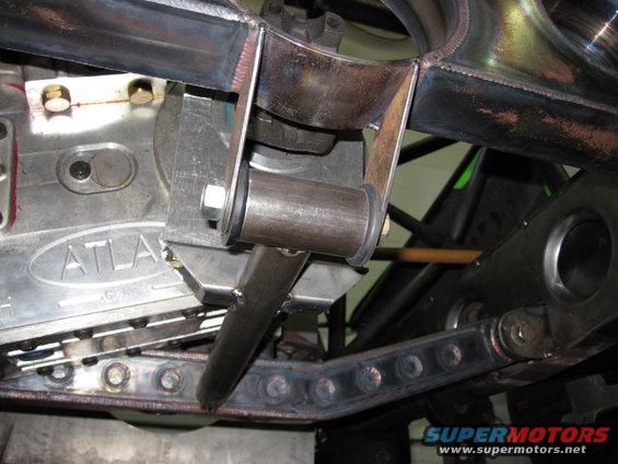

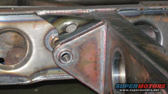

Transfercase crossmember
gunit
Posts: 340
Post by gunit »

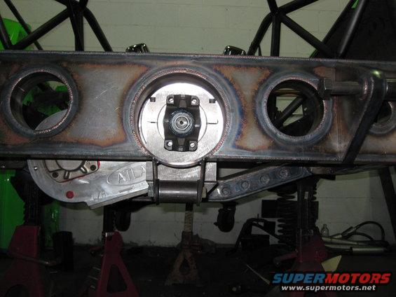

rear crossmember with link mounts
