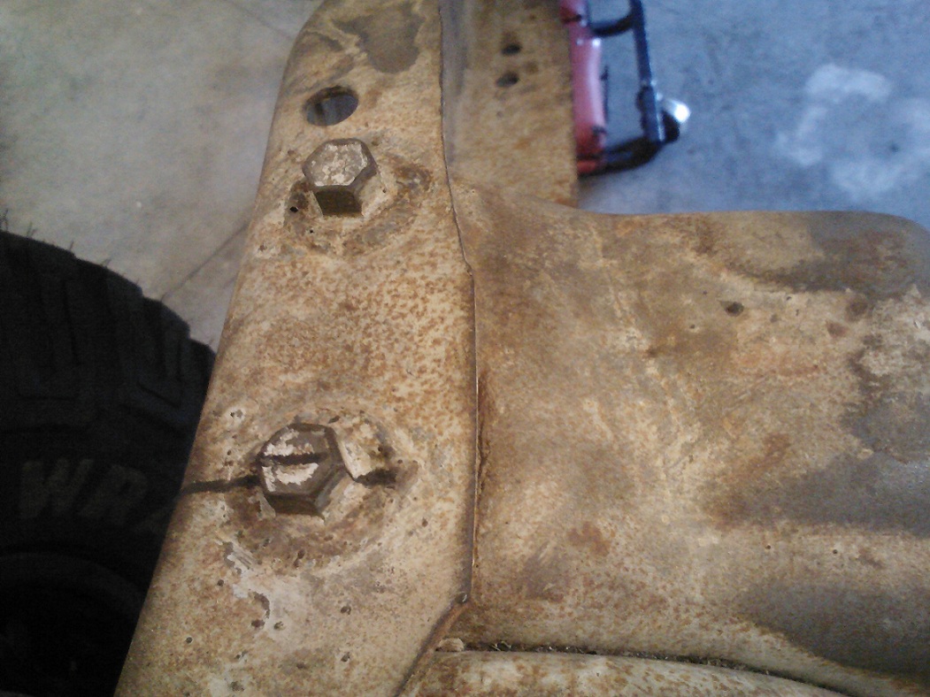

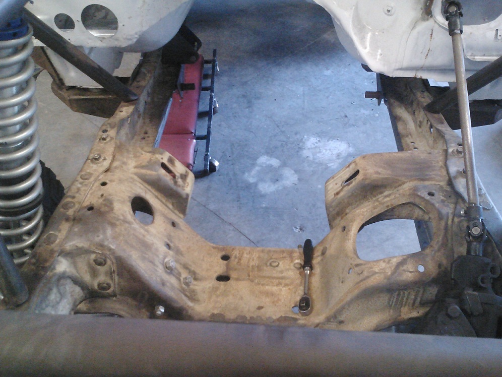

- Back when I was young and foolish, I welded all the rivets/crossmembers with out giving any thought to the fact they may need to someday come out. Damn!
- IMG214.jpg (256.34 KiB) Viewed 2280 times
- Stupid frame rivets/misguided welds!
- IMG218.jpg (234.8 KiB) Viewed 2280 times
- Now I just have some grinding and drilling to do. Once thats done, I can put in my new Autofab mounts and motor!

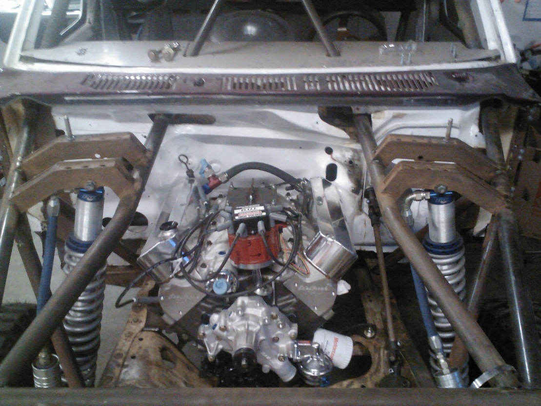

Well, I finished up all my grinding and drilling and have the Autofab mounts in place now. The autofab mounts came drilled for 7/16th bolts (which I hate with the burning hot intensity of 1,000 suns) so I redrilled them all to 1/2" bolts. The holes in the frame were all about .530 diameter. The Autofab full race mounts are a very nice unit. I was a little worried about the motor fitting them properly since I took out some slop going to the 1/2" bolts, but everything lined up great.
The motor is in and now it is time to start the plumbing and wiring.

It looks good in there! I can't wait to hear it make vroom vroom sounds from under the hood!

Thanks. I have same Autofab mounts & they are nice pieces.

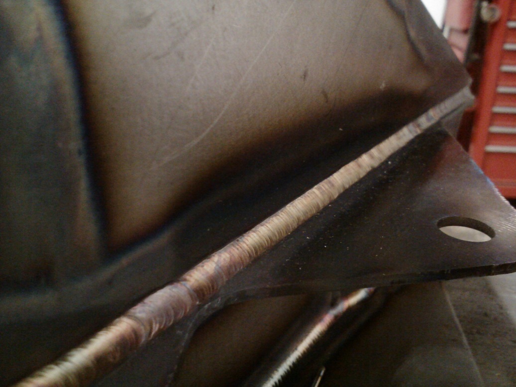

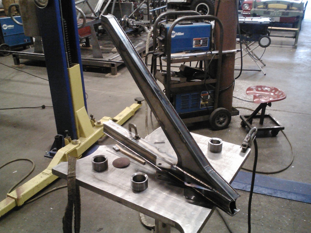

OK, I have been spending my time getting my 76 bronco ready for summer cruising and wheeling. It's on the road/trail now so it is back to the race bronco!
Now that the motors in, I am moving on to steering while my business parter should be starting on plumbing and wiring. I am going with a single swinger set up. Once I have this welded in I will get the front of the frame painted. I will just be spray painting everything until I get some seat time and get any bugs worked out.
Anyway, here is what I have cut for the swingers. It's all 3/16" chromoly. It pivots on Pro-2 delrin lower arm bushings.
- swinger box.jpg (272.8 KiB) Viewed 2140 times
ESHALLBETTER wrote:OK, I have been spending my time getting my 76 bronco ready for summer cruising and wheeling. It's on the road/trail now so it is back to the race bronco!

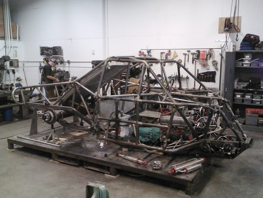

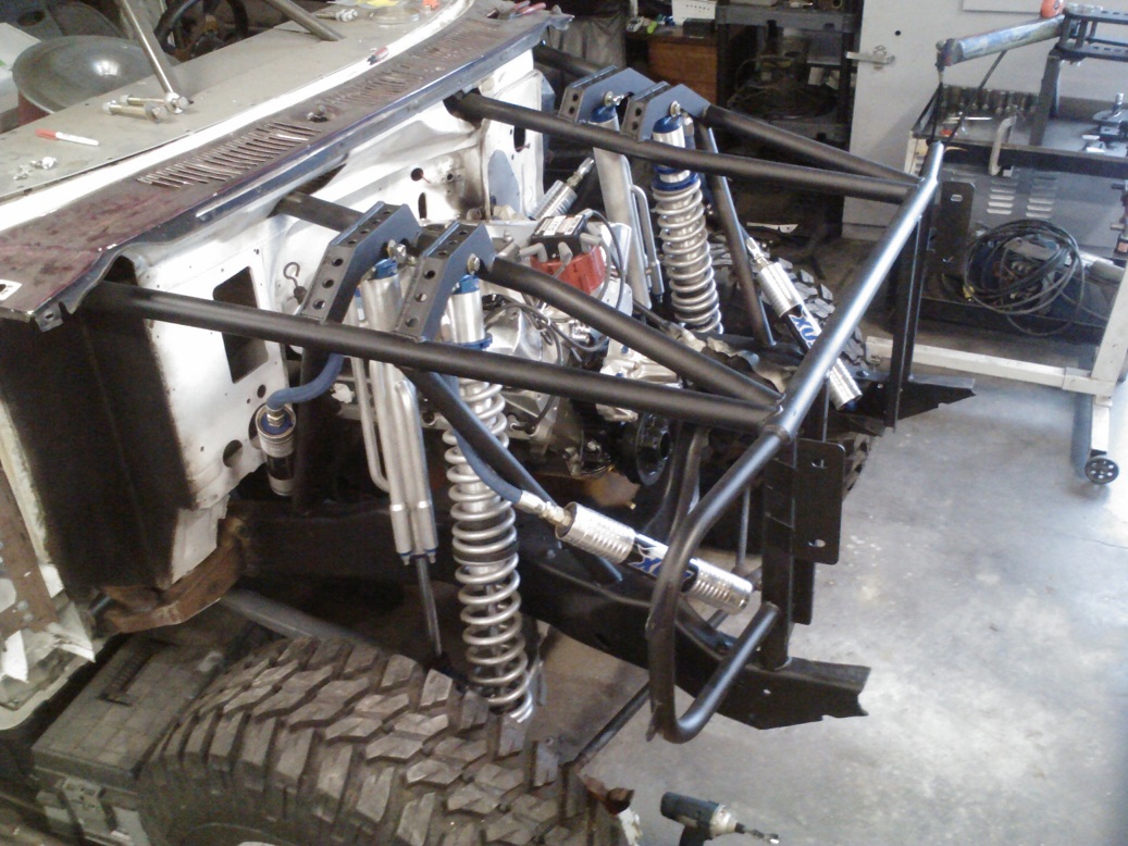

Well....
We had another Pro-2 come in that needed some work so I have been spending my "free time" working on that a bit. It needed to be re-plumbed and it got new suspension front and rear. I was able to get the front of my frame painted and get the motor and shocks back in. For now I am just using a flat black that comes off with brake cleaner so I can tab it out and make changes easily. I should be mounting the PCV tank and steering fluid reservior this weekend.
I basically just wanted to add some pics so people knew I wasn't dead and I've been in the shop!

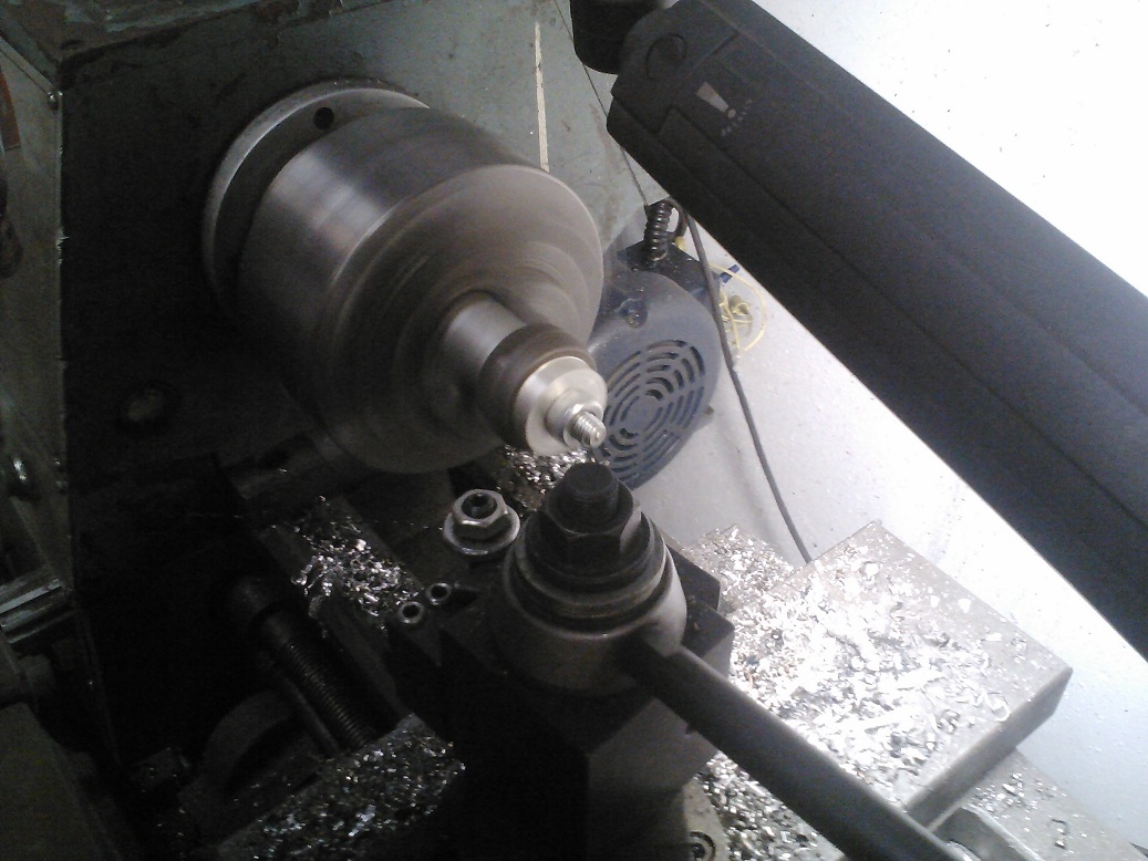

A little more progress but progress none the less!
I have decided to go with a single swinger setup and use .875 heims throughout. Also got the snouts and the hubs on the rear axle! I hope to get the new pitman arm tacked together tonight and get the swinger in the truck.
