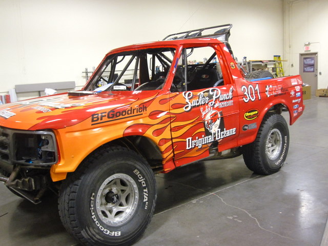

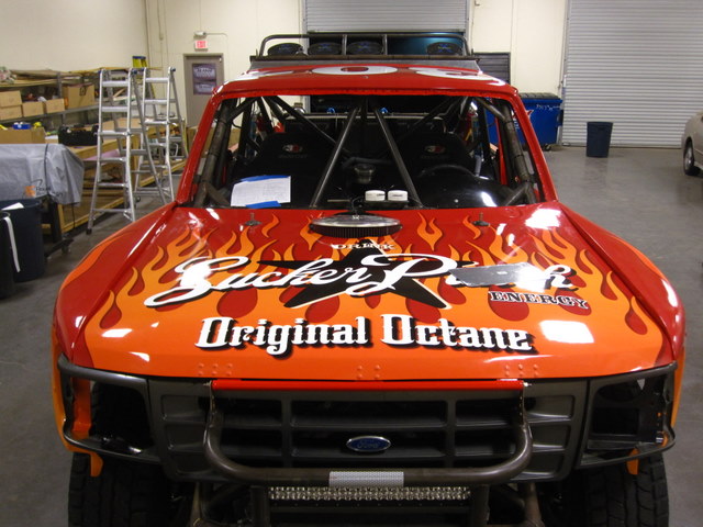

Here is how she looks now:
Re: Gunit's class 3 racer build
Wow, looks great! I especially like the hood hinge.
Dave, the truck is just flat out awesome... Good Luck at the Mil... I'll be looking for you out on the course...
Looks outstanding Dave!! Wow, what a journey, must bring tears to your eyes to see her readfy to rock and roll!!
See you just passed the NOT SO DRY lakebed!
Looks awesome Dave! Best of luck to you guys. Have a safe race and finish!! I'll be watching you guys the whole way.
That Bronco is so beautiful!!! congrats on the finished work of art.. good luck, and be safe at the 1000...
That is amazing way to go! Good luck to you!

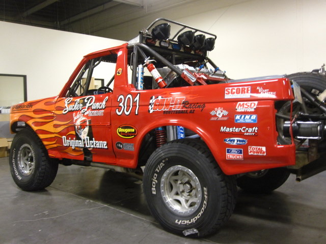

Most of the whining comes from the guys who realize they screwed up but are to proud to admit it. Pointing out the obvious I would not consider whining. I only spot 3 rule violations from those two pictures at a quick glance (not boinger related) but nobody will worry to much about that. Does look good though.
Deleted Account
Posts: 531
Location: Ramona, California
Post by Deleted Account »
MOSS2 wrote:
shockseals.com wrote:
78Class3 wrote:Awesome truck. I drool every time i see it. So what class is it gonna race in?
Class 3 unless somebody whines.
I thought coil overs on the rear was a BIGGGGGG no-no. Has that changed????
gunit
Posts: 340
Post by gunit »
Read the rules carefully. Specifically the section about secondary suspensions.
So the C/O's are your secondary suspension system? Where a the leafs that are required as the "original concept" spring that will support the vehicle +-1.5" at ride height.
I'm still not getting how you think this passes the rules. Your unwillingness to post a plain answer leads Me to believe you think your not 100% in the clear either.
gunit
Posts: 340
Post by gunit »
We met with SCORE tech inspector Bill Savage on Tuesday before the Baja 1000 and asked him to look at the car and to give us his blessings. At that time, we demonstrated the ability of the leaf spring to hold the car at ride height both with and without the coilovers attached to the car. I have attached a pic that shows the car sitting on the leaf spring with the coilovers unbolted and dangling below as we were on our way over to see Savage.

gunit wrote:We met with SCORE tech inspector Bill Savage on Tuesday before the Baja 1000 and asked him to look at the car and to give us his blessings. At that time, we demonstrated the ability of the leaf spring to hold the car at ride height both with and without the coilovers attached to the car. I have attached a pic that shows the car sitting on the leaf spring with the coilovers unbolted and dangling below as we were on our way over to see Savage.
I must be really retarded. I dont see a leaf ot the rear. I see a sway bar, c/o and bypass. Im not trying to start anything, but i built a differant class veichle because of the bs leaf rule. i would much rather this be legal. has anyone tried to i good leaf spring let alone a quarter eliptic pack. You might as well try to raise the titanic. Its about the same thing.
